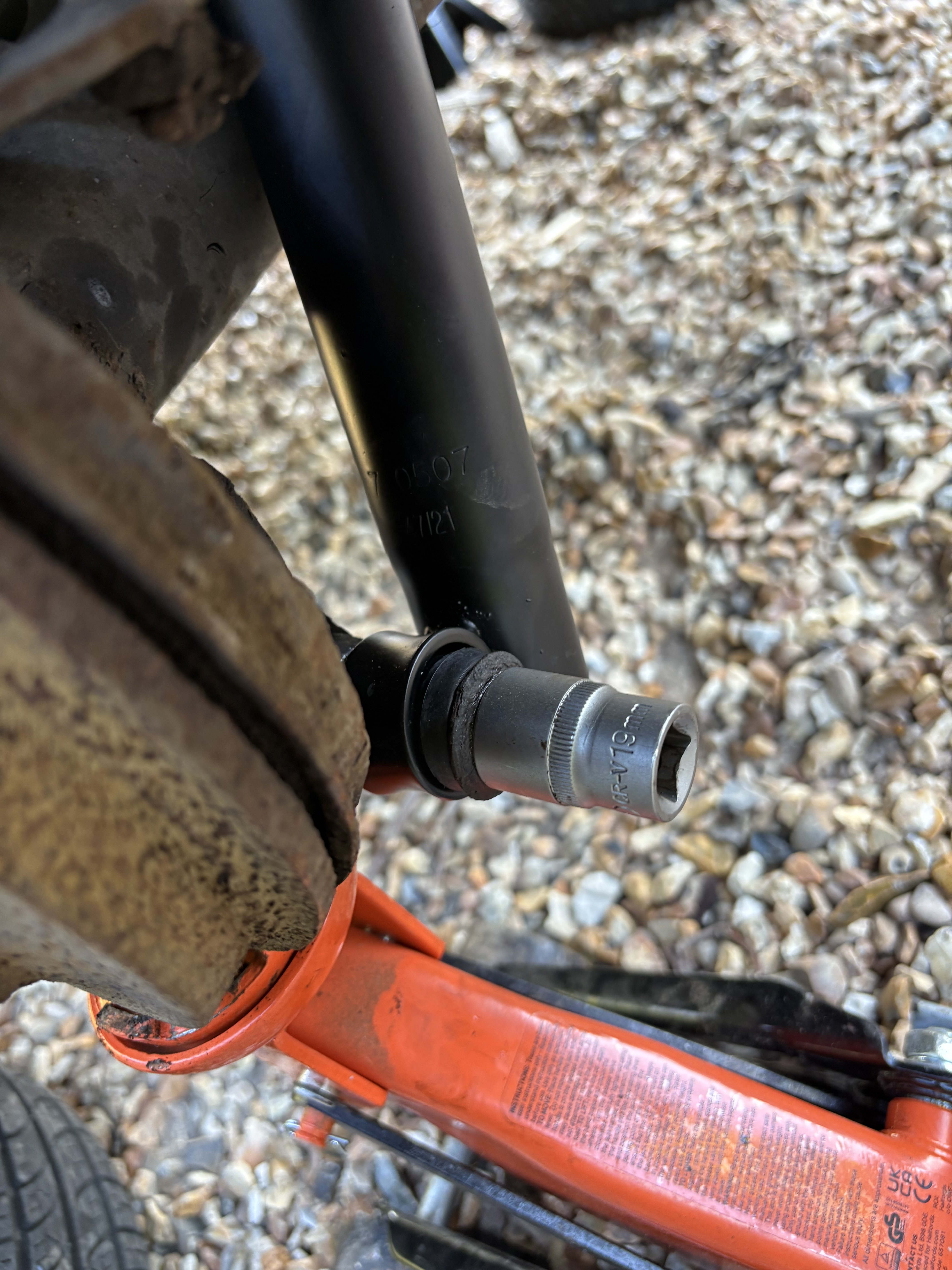

Hello, I’ve just started taking my rear shock absorbers out. I undid the first nut, which was pretty rusty, and now it is stuck in my socket and I can’t get it out no matter how much whacking I do. I’m thinking of buying a new socket and new nut, but I’m need them pretty sharpish as I have an MoT on Saturday!
I can’t find it on Ricambio or eBay, so was hoping to go to a local B&Q or similar and buy a matching nut. Does anyone know the specification required? It’s 19mm but I don’t know the pitch, or M number (whatever that is, I never know what that means).

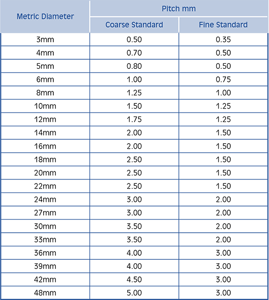

The M is the thread diameter! , the head size (19mm) is immaterial and never really referred to. (but is related to the thread diameter by the by)
The M in your case (based on a 19mm head and experience) is probably 12mm (so M12)
The pitch could be 1.75 or 1.25 for a M12 bolt (it's how many thread per inch there are)

(see attached chart)
Interesting info on the bolt size, I’ll try and get my head round that. Not sure the online sellers would reach me in time for my MoT.

That's metric bolts in a nutshell, there aren't any deviations from that chart for those sizes.

I haven’t had any luck with any of the suggested methods unfortunately. I contemplated leaving the socket and nut fused, attached to the wheel with the socket acting as the nut. This rubs against the inside of the wheel, however, so won’t do. Back to hammering :(
Even a 7 pound sledgehammer isn’t doing the job!

i work in a scrap yard and deal with this on the daily.. with enough hammering on the side of the socket it will come off. a few hits one side then the other side. more hammer weight is not always the best thing to use. ideally you want quick short jabs from something like a 2 or 3 pound hammer. the aim is to rock it off.
now imagine trying to get the nut out without being able to wind it back on the thread.. thats what i have to deal with. guhh. i have it to an art now.
I'm guessing the socket head is 12point, you're less likely to jam your nuts (oooo errr missus) with a 6 point type.
The 12 point type have more chance of jamming when you're really pushing some force through them, so to avoid the hassle if you're removing (or fitting) a bolt that requires some force putting into it use a 6 pointer :ninja:
Actually it’s a 6 point one that I managed to get stuck, somehow.
I’ve had far too many experiences with rounding nuts and bolts on my 1990 MX5 (made of steel with the consistency of wet cardboard) using my grandfather’s 60 year old 12 point set, so I’ve been using a 6 point set for the last year or so on the more troublesome fixings. This is the first time I’ve had any trouble with this socket set.
To be fair to it, the nut looks in great shape, it’s just a little wonky in the hex.
Oooo wow o_O
Maybe you've just lost too much of the nut width to corrosion.
I think that’s the most likely cause yeah. Good old 18.5mm nuts…
Annoyingly, the other three 19mm nuts for the rest of the shock setup all came off and went back on easily, using the antique socket set! Perhaps I was too quick to judge tools manufactured in, let’s see… the Austro-Hungarian Empire?
I think I’m gonna order a new nut, and see if I can get my MoT retest pushed back a bit.
