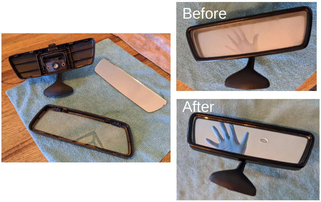

My newly-acquired Spider's rear view mirror was basically unusable due to fogginess after sitting in a garage for ~12 years. Took it apart today, hit it with some dish soap, Windex on the mirror & glass, and plastic restorer on the plastic pieces. Much better!
Hi, I have the same issue. Is there a trick to removing this from the car? Mine is stuck and doesn't move.
Yes, there is a trick. There's a small slot in the rear view mirror assembly base near the glass. It's on the bottom side (toward the dash). It's just large enough to fit a flat-head screwdriver. I inserted a screwdriver and rotated carefully to gently pry the rear view mirror assembly from its mount.
Remounting is easier, you just push it back on.
