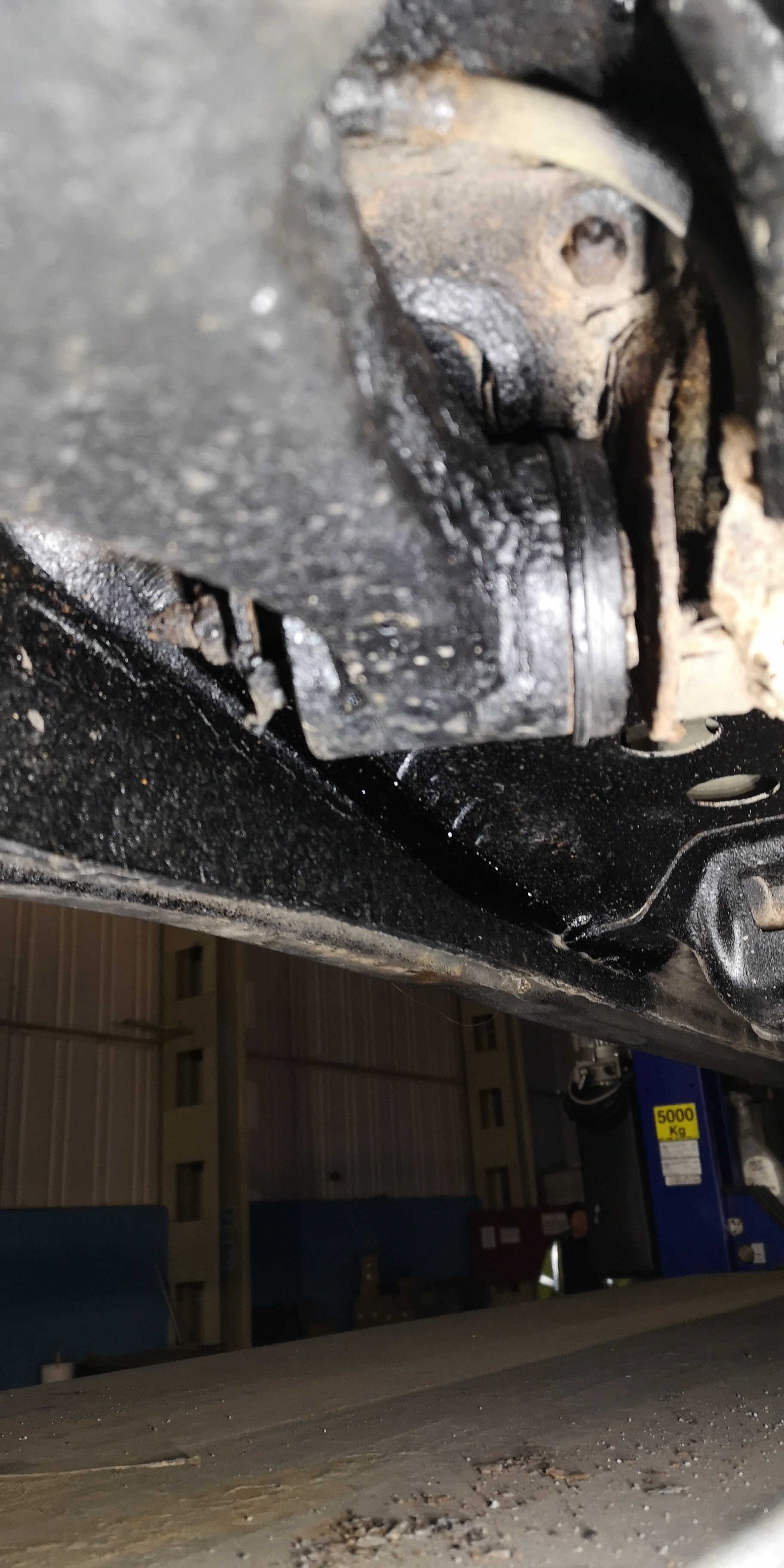

rear suspension bush worn
trying to decipher haynes to see whether its a big or small job
sooooo will i be able to just drop the arm
or or is it rear axle off
thanks as always
charlie

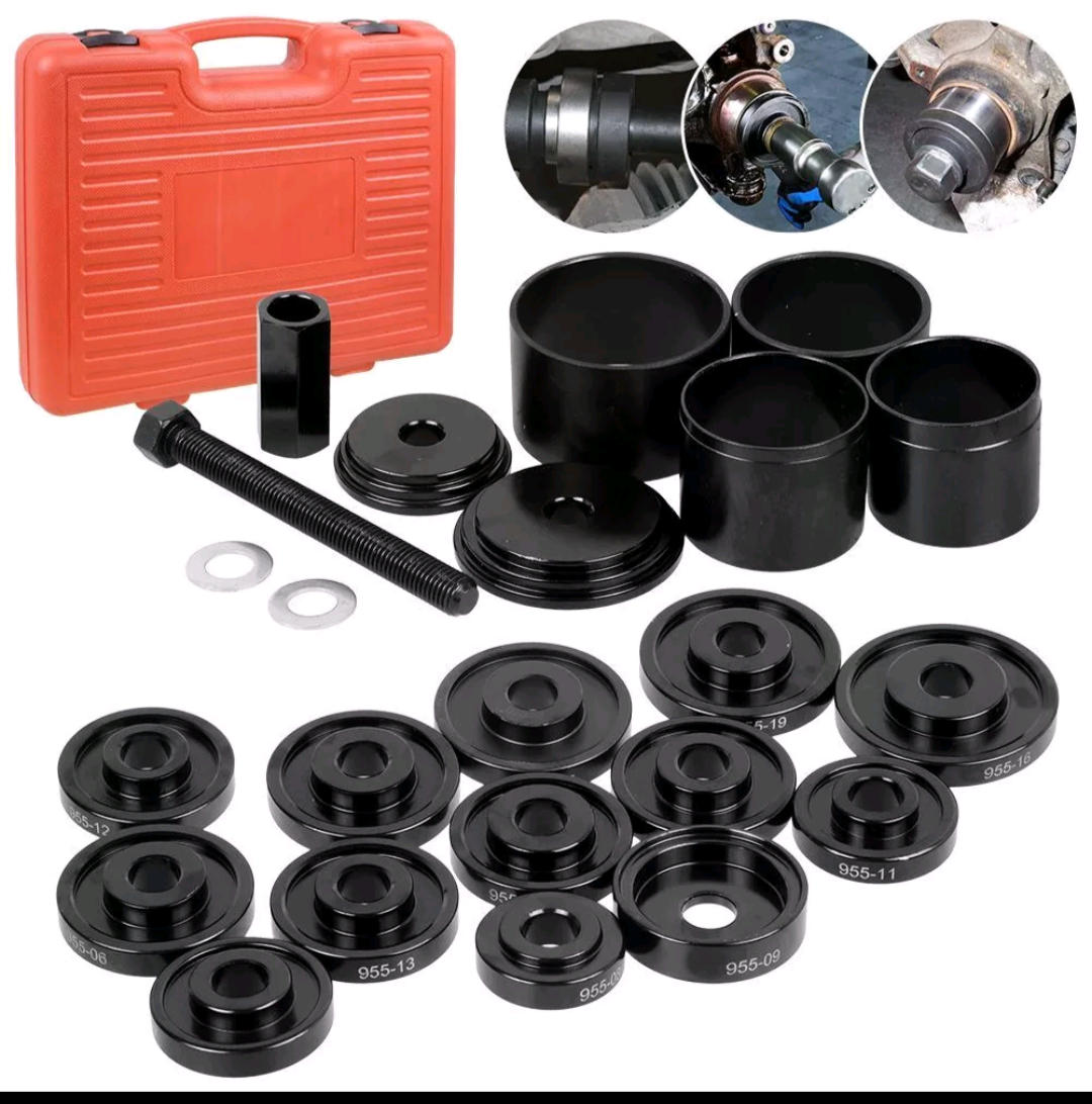

If you can undo the bolts you may be able to drop the arm and use a extractor tool, they do one with a long threaded bar and cups that fit arm and push the bushes. It will probably be well rusted in, in which case it may be a case of dropping the whole arm and using a garage hydraulic press to get the old one out and press the new one in.
If that is the case a small local garage may be able to help if the arm is off and you give them a "drink" if lucky.
Looking at the photo I would give all the bolts a good oiling in advance to make life easier.

I doubt it will come out with an extractor like this
Worth trying first as if it does come out it would be a bonus

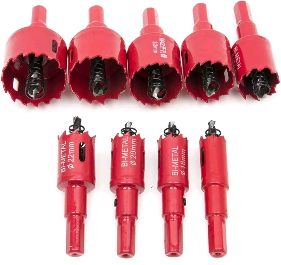

I have used a hole saw in the past,
To remove most of the inside,there are other ways, you need a drill with a slow speed and some oil, you want to cut the rubber not melt it

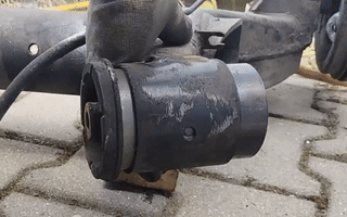

These are PLASTIC-rubber bushings. They do not rust-in like a classic metal ones.
I just did my rear axle 2-3 weeks ago. Biggest problem was: rusty brake lines/hoses! Seized.
Needed gas torch to heat up (+ some improvised shield: fuel lines area!). Then...ABS sensor plugs. Next problem: shock absorber bolts.
Axle itself, mounts, were easy.
Tools (black set of sleeves) you are showing above are NOT "extractors" but install tools only here. Bushing has a "lip" (shoulder, rim, flange).
Old bushes can be just popped out with a hammer, cut out etc. Installing new ones is harder than removing old. Usually, the opposite is true.
Here's a video (short because the axle itself is easy, there's nothing to film there really). Mind the position ("clocking") of the L/R bushes.
