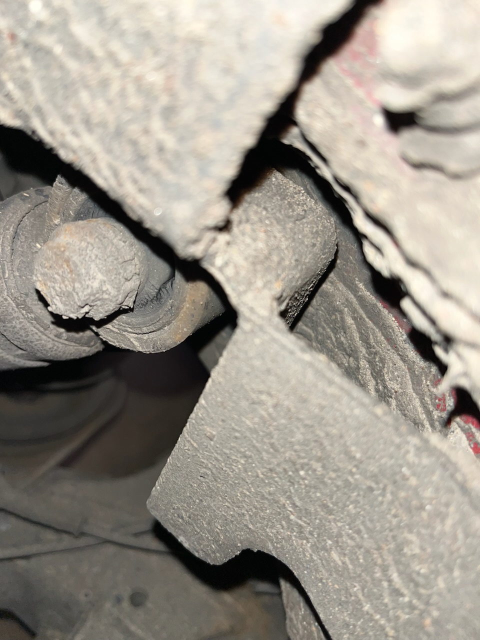

I’ve attached a 2019 photo when I had the wheel off to rotate tyres front/rear and a picture today. This is the OSR showing cracking/wear. It doesn’t seem to have increased much over the past 3 years.
The NSR doesn’t have any visible cracking anywhere to this extent.
