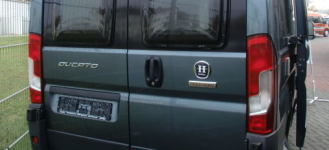

I'm looking to import a new LHD Ducato van conversion very shortly (2016 model).
The headlight & speedo replacement seem straightforward but does anyone know whether the current Ducato van comes with 2 rear fog lights or just one on the left? I've searched on the web but not found a definitive answer. It seems a bit of headache to replace and rewire if I need to add a fog light on the right hand side.
Pic of rear cluster attached
Any help would be gratefully received.

may come with only 1 but should be able to change it over

Rear fog lights are "high-intensity" (i.e. brighter than tail lights) red rear marker lights to be used only in poor visibility.
Either one or two can be fitted at the rear; if one it must be either central or the extreme offside (hence the query from the op, as the offside is the "other side" on a LHD vehicle); if two, they should be fitted at both rear extremes.
The X/290 has two, and by reference to the picture above are located in the red portion of the rear light cluster immediately below the clear bit.
