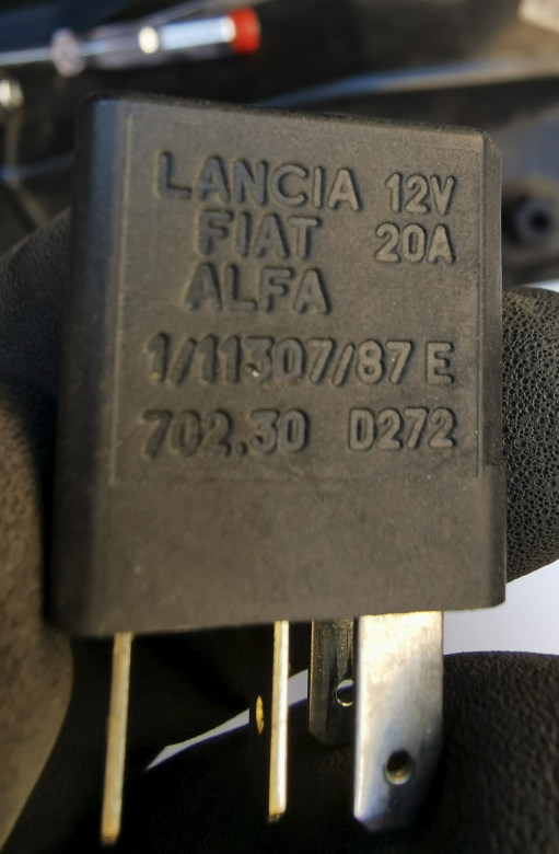

On the 2011 x250 the relay is a small one, looks like that:
And is located in the fuse / relay box under the bonnet. Position T14. The fuse is F30.
The fog light will work only with the side lights on. But the dash light should not illuminate if the side lights are not switched on. Both D050A / D050B and F015 / F016 connectors are hermetic, so there should be no rust inside. Unless someone messed with it. The last piece of the loom (between the mentionned connectors) is quite exposed to mechanical damage unless your van is equipped with the side undertray covers.
