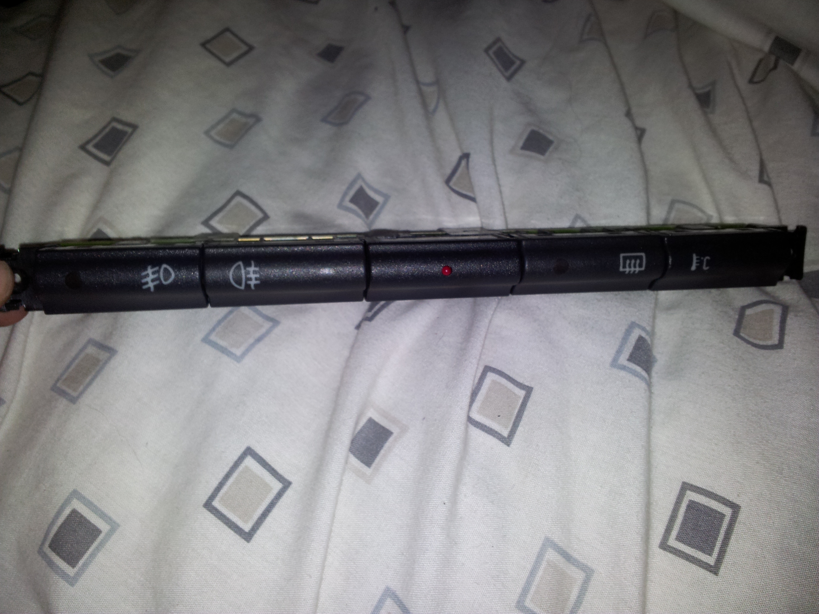

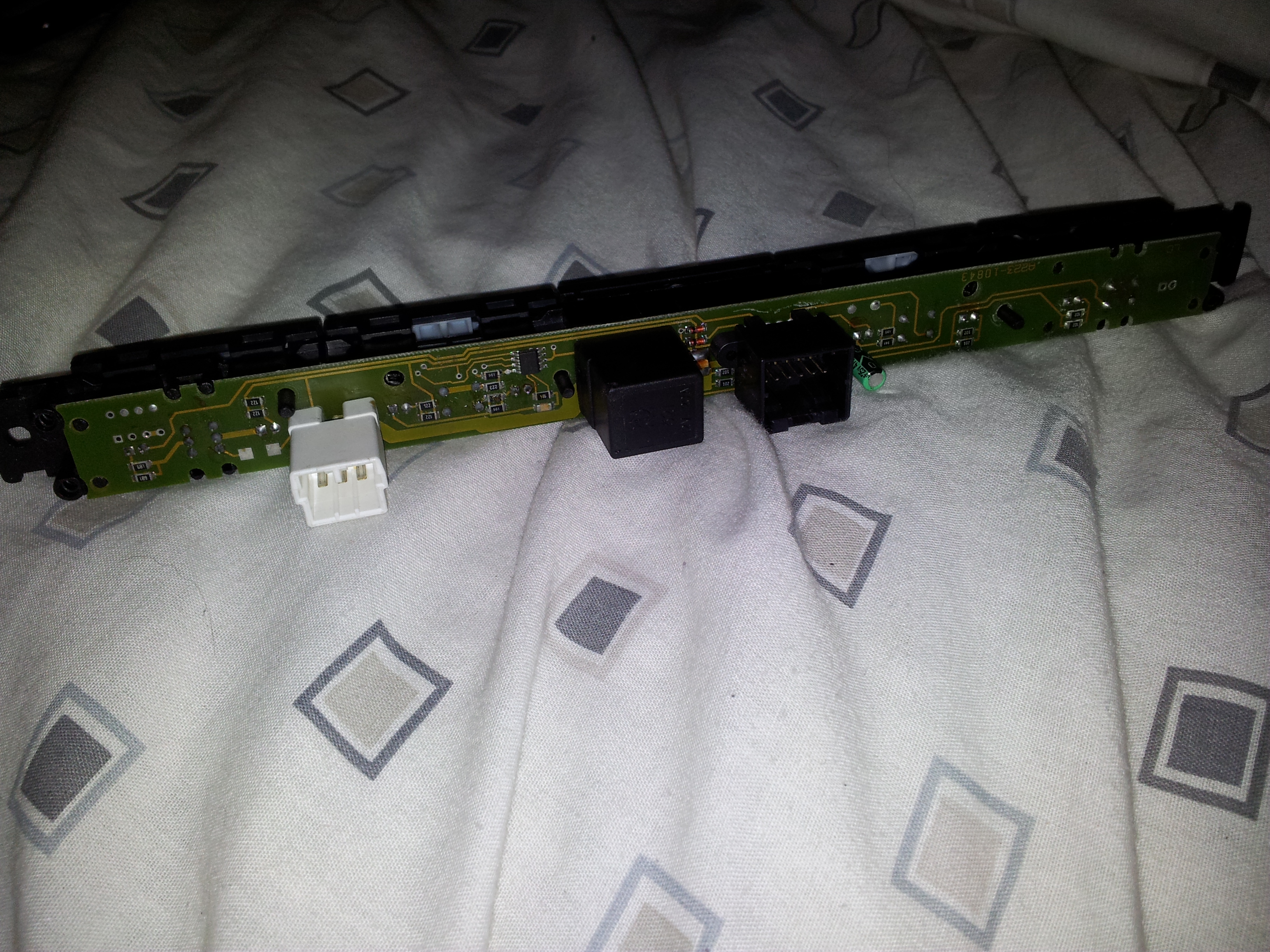

The front is a real latching switch, the rears are a passing contact with an electronic latch. The relay isn't being activated by the switch. :( I've tested the switch and it is working (pressed in all contacts are live). I've manually closed the relay and the fog light works.
So, the issue is either with the coil of the relay, or the resistor and ICs that form the latch. I can't get into the contacts on the relay to test, and to get the PCB off the front switches looks like it would need all the LEDs un-soldered. It looks like I need to find a working replacement switch panel... and fast!
Until then, my rear foglight is activated by sticking a bit of paper into the relay to hold the contacts closed. :eek:

do i see a burnt out micro resistor?
between the white plug and first relay bank of 4 resistors (little black things with numbers on) third one down looks to have fried
I thought that too, the numbers were partially obscured. My attempts at clean up to read them easier didn't make it any better. I performed a resistance test across the resistor and still got a reading. I think that resistor is protection for the switch illumination LED. Could be wrong though as I've not been able to see the other side of the PCB.
It is the resistor for the foglight led, reads 561 and measures 280ohms across (two parellel resistors). Had the leds removed and took the plastic off, but there was nothing interesing on the other side, just traces. The chip has some writing but needs proper magnification to read it so no idea.
