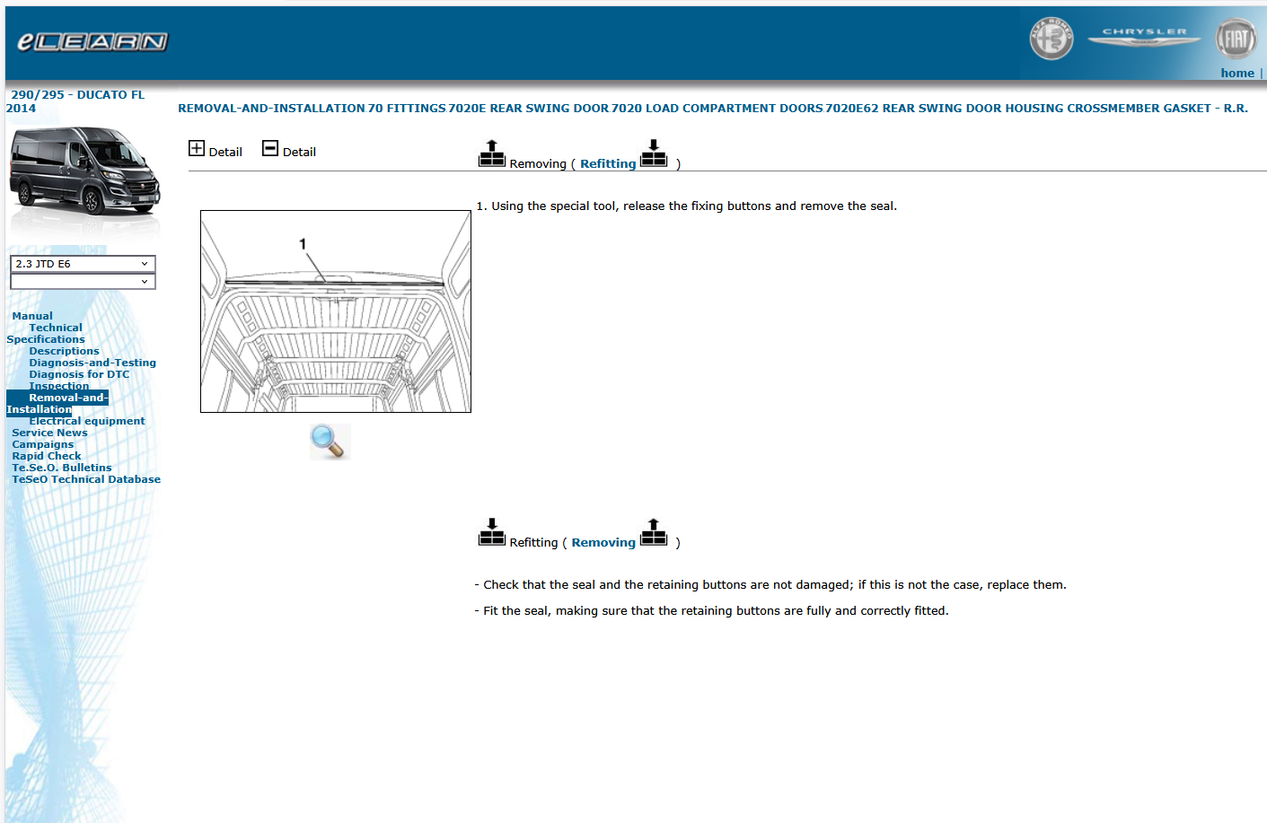

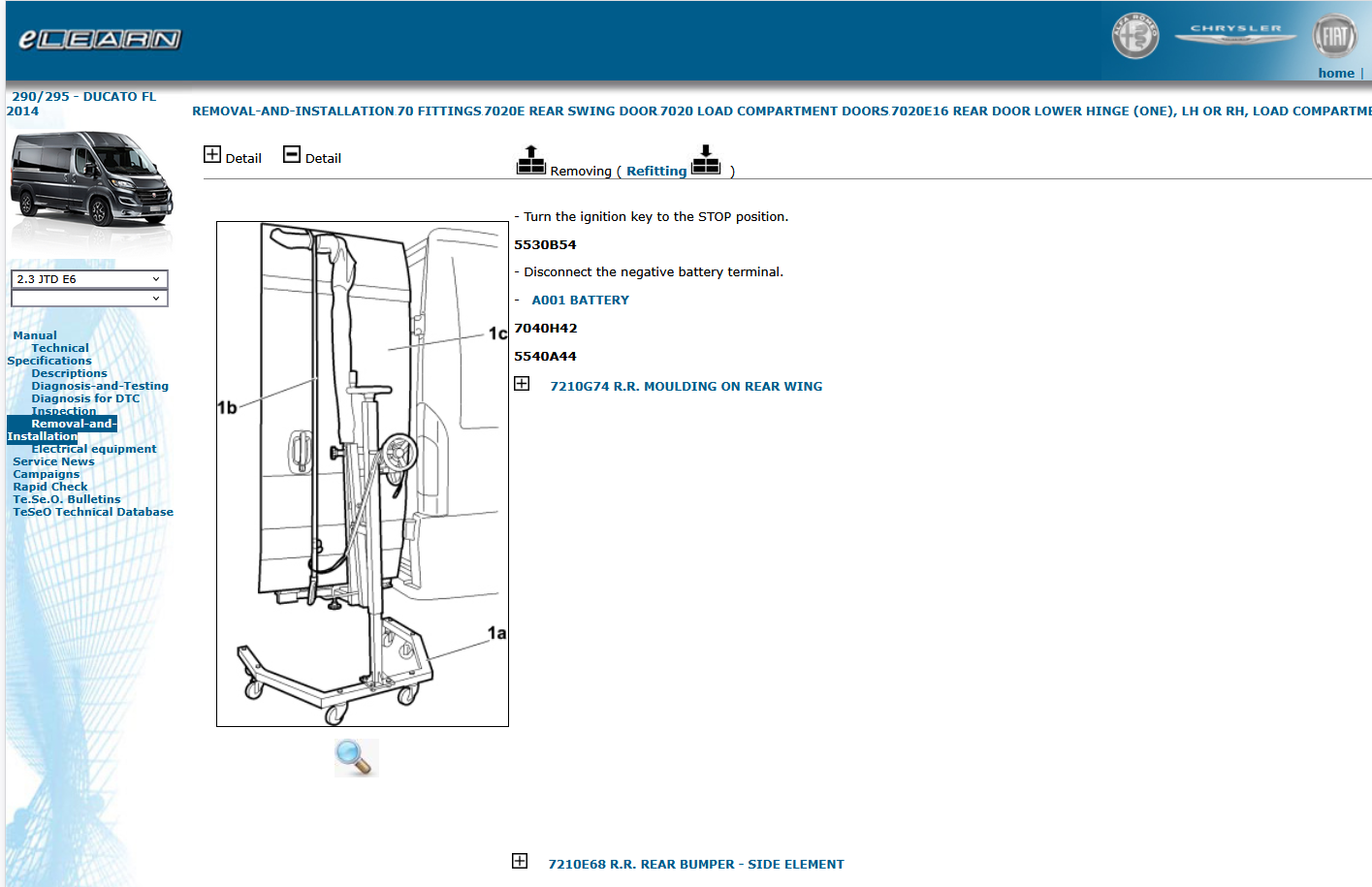

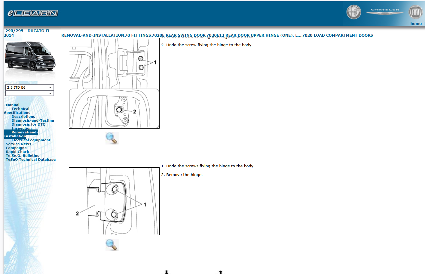

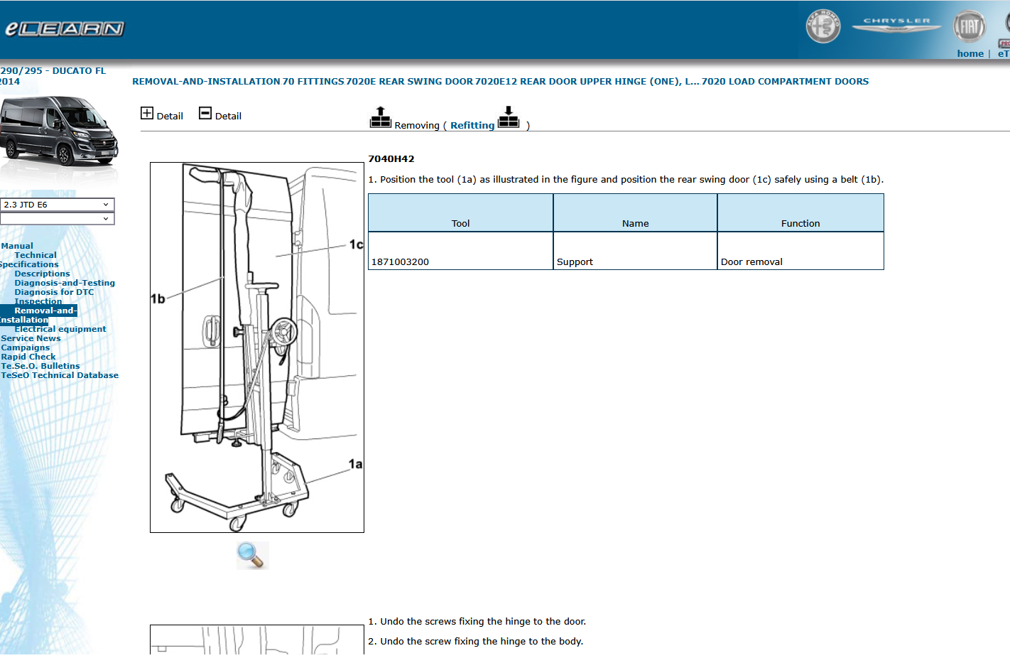

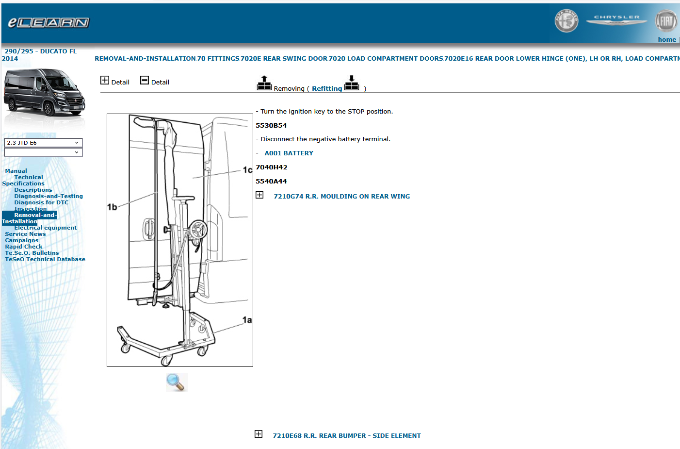

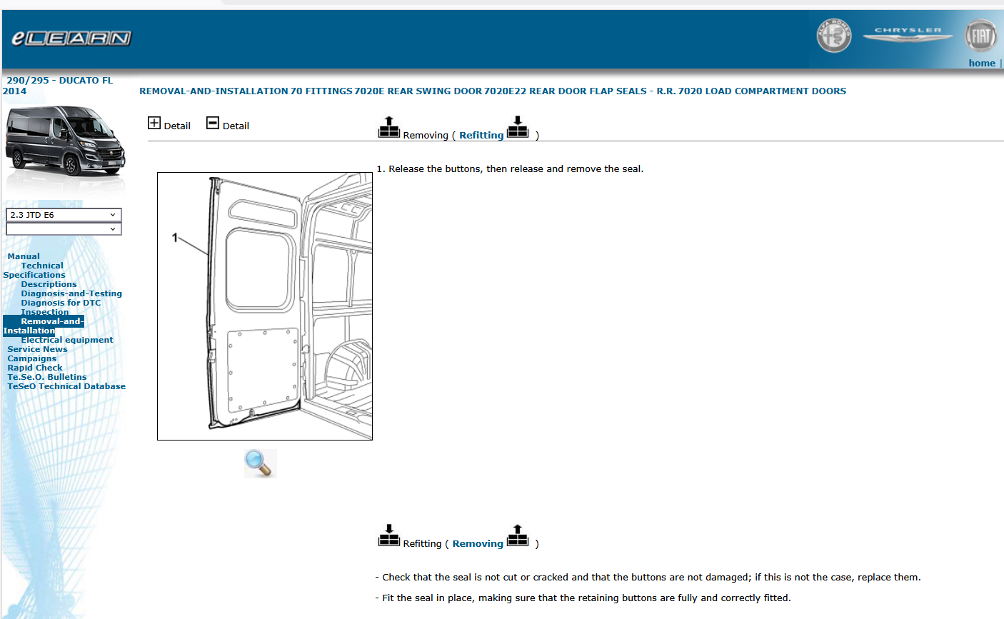

I couldnt find anything related to alignment these may or not help
