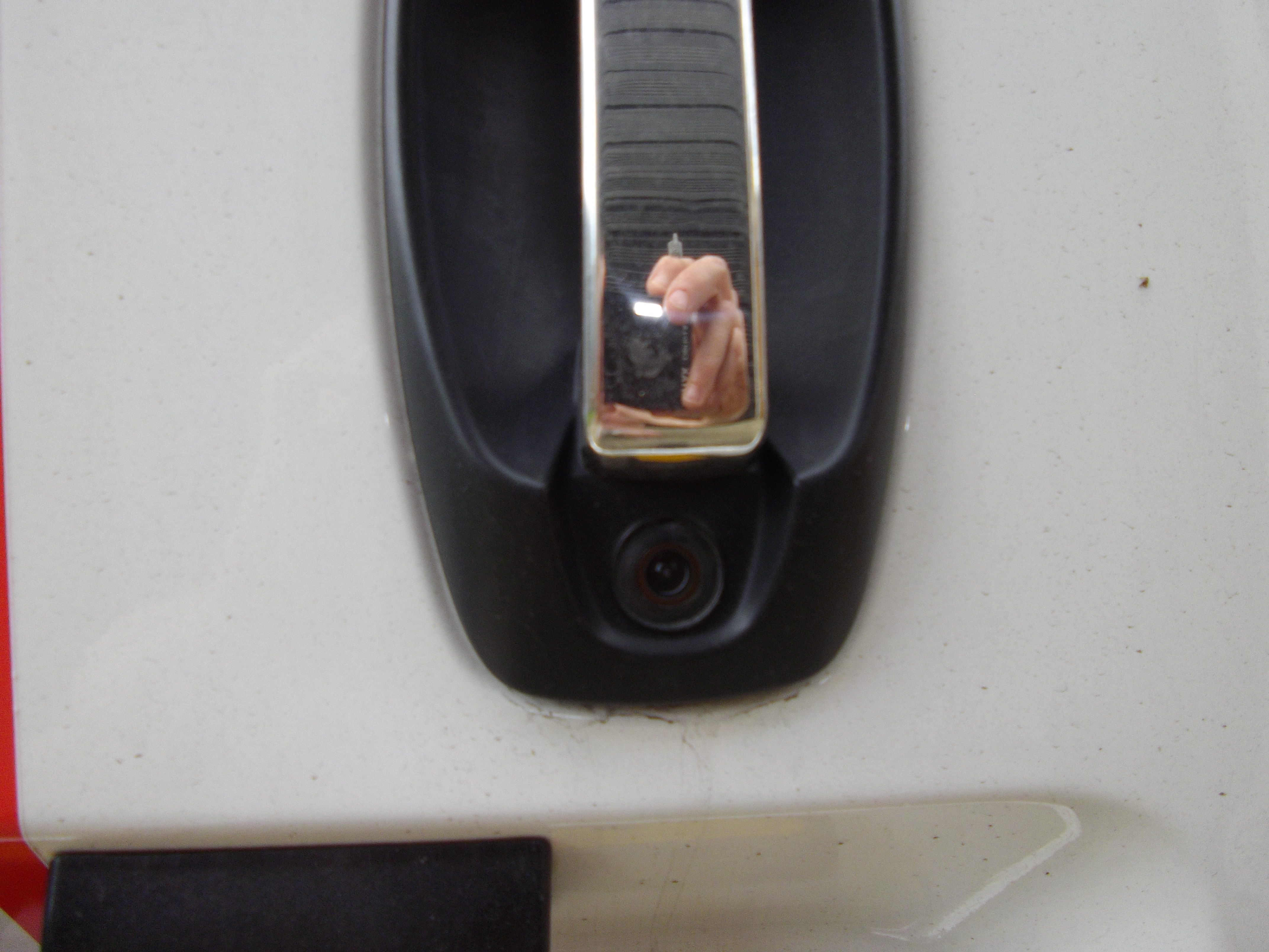

Can you also expand a bit more on your 'rear view' system using the mini cam in the lock barrel - like which cam it is (source) and how you linked to the screen at the front please? Also perhaps how alteration and mounting in the removed lock was done. I presume you use the internal remote locking to open/close (lock/unlock) the rear door..
Thanks :)
R-V-M
The cam i used is one that is designed to fit into a hole drilled into a surface like a bumber for eg, same as you would do if fitting reversing sensors.
On looking at the possible ways to do this i looked at the rear lock barrel,i never have used it as i have remote c/locking,removing the barrel was easy and found that the cam fitted in perfectly.
power for the cam is supplied by the reversing light feed,the signal from the cam is fed to the front and is connected to a 9'' pda which has a av input,when i select reverse the pda gets a signal and switches to cam mode.
Ido intent to do a reverse over ride so i can manually select the camera to view whats going on behind.
As to were i got the cam from i'll have to hunt for a link for it as it was a while ago.
the lock was not hacked about to do this mod,and and the barrel can be re-inserted if need be.
Hope this info helps
Luigi

And a pic of installed rear view camera in the rear door lock barrel.
Luigi
Luigi

?.....as I have stated before, my back door glass is black perspex over the the solid panel,so looks like limo tint glass, I must remember to get some pics on here for you to see.
..And a pic of installed rear view camera in the rear door lock barrel.

I've earmarked 2 items on eBay; this camera (yours I believe) and today found the ideal replacement rear view mirror here which is a monitor for the camera. The previous camera I'd selected (but not bought, just 'watching') stated in the description that 'returns due to picture quality are not good reason for refund' so that rather suggests they're poor quality if buyers have been sending them back!
So Sr. Luigi, put your cup of tea down or pause Wimblers for a few minutes and nip outside and take a few pics for us.
Can you say what happens to the lock mechanics on removal of the barrel because surely there's some interconnects within for the barrel actuator on the handle to prevent lifting the handle operating the latch. Not the remote solenoid as that does its bit further up the handle into the latch/lock mechanics.
