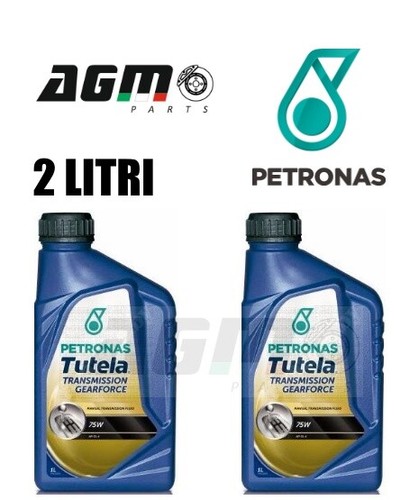

Hi, I have a panda 2013 4x4. And I'm stuck on what oil I need for the rear diff.
The handbook says 75w manual transmission fluid
And other sources say I need 75-85 multi axle oil which I can't find anywhere .

This appears to be what it is asking for. £42 for 2 litres would probably last a very long time. That said you could probably get some quicker and maybe cheaper if you just visit your local fiat dealer or search around for Petronas oils matching that specification.

You have highlighted the oil for the gearbox (which includes the FRONT differential, and I think from the handbook for an older, pre-2012 model too?) The spec for the rear diff is different, half way down the page in my screenshot below - see the link in my older post for where to buy a suitable oil https://www.fiatforum.com/threads/t...other-one-i-apologise-now.502988/post-4700413
