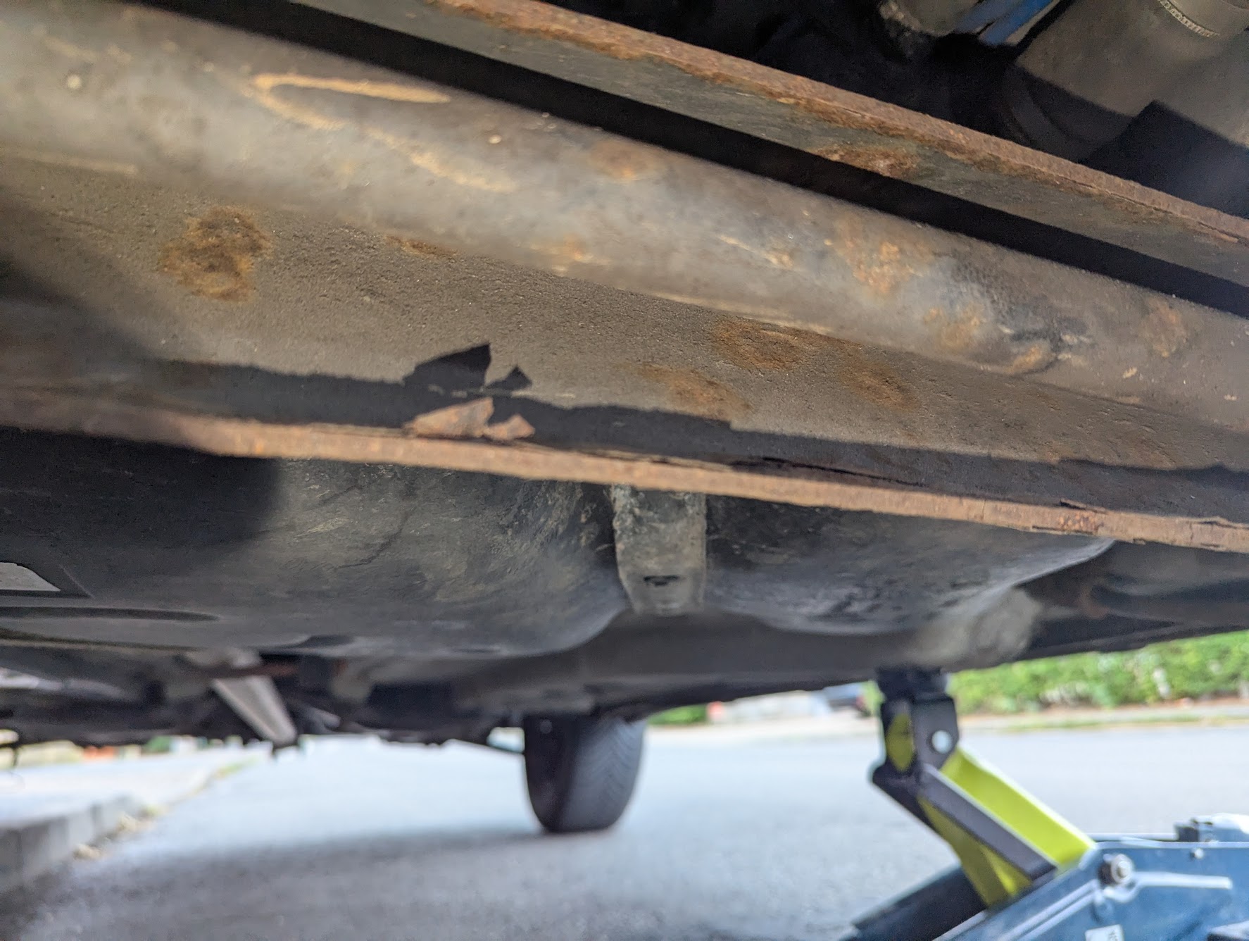

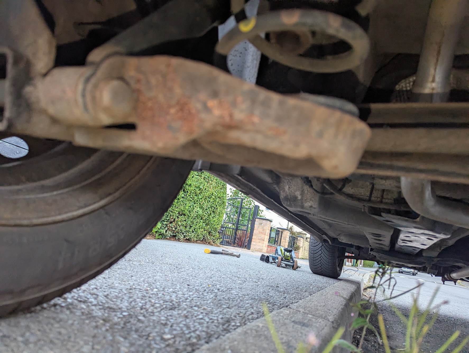

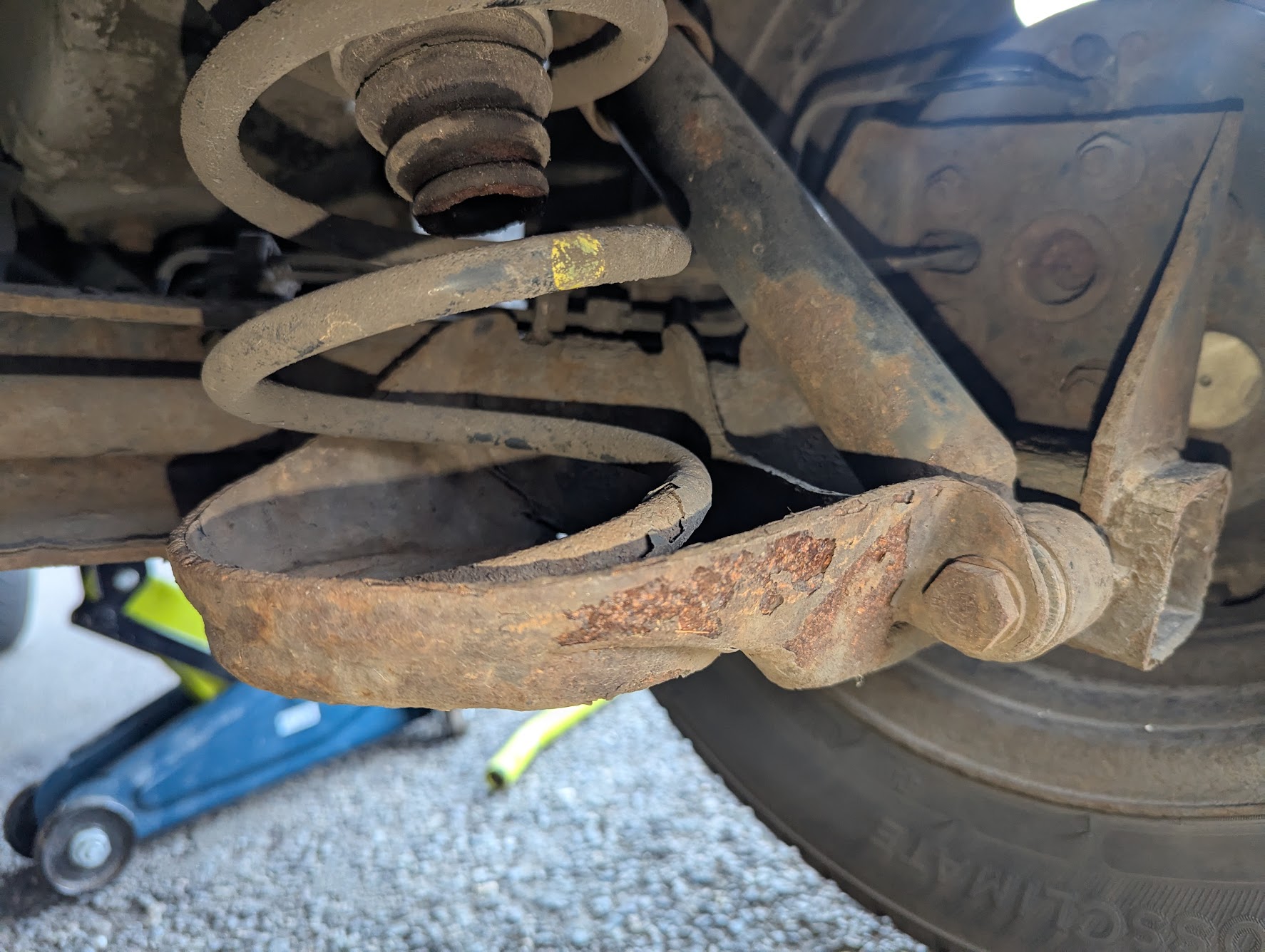

This is the rear crossmember area of our 2011 500, are we likely to get dinged on MOT for this? I think it is just affecting the surface but it has spread very quickly, it looked very clean when I was last under there six months ago... OEM crossmember, rear shocks replaced a few years ago. Car is running OK but has a minor creak from the back end when we start moving sometimes.

That won’t fail an MOT, at most you’ll get a minor for rust
As said above 👆, but you could lightly spray oil over it all, but not too much, you don't want any drips as they have in the past failed mine for for thinking the shocks were leaking. You can do a heavier coat AFTER the MOT.
I spray the whole underside of mine every year long before an MOT (~60/40 engine oil & white spirit), so the oil collects dust and the dust in turn soaks up the oil, and forms a nice protective barrier against the elements, all bolts are easy to undo making any maintenance far easier.

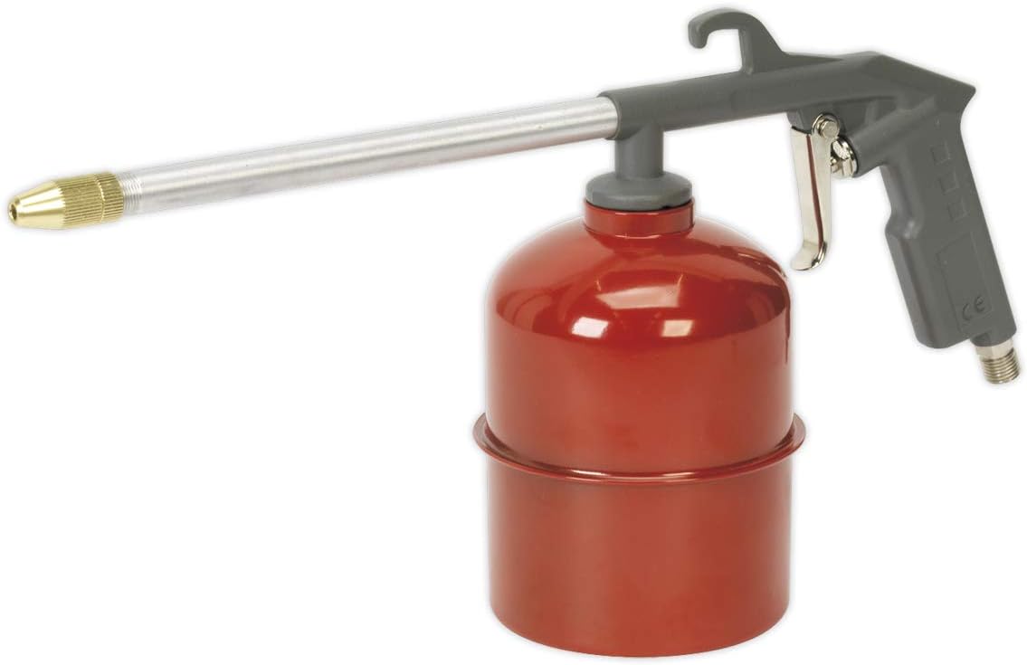

Attaching my shultz gun and using my compressor which is just a case of chucking the hose to the car and turning it on.
