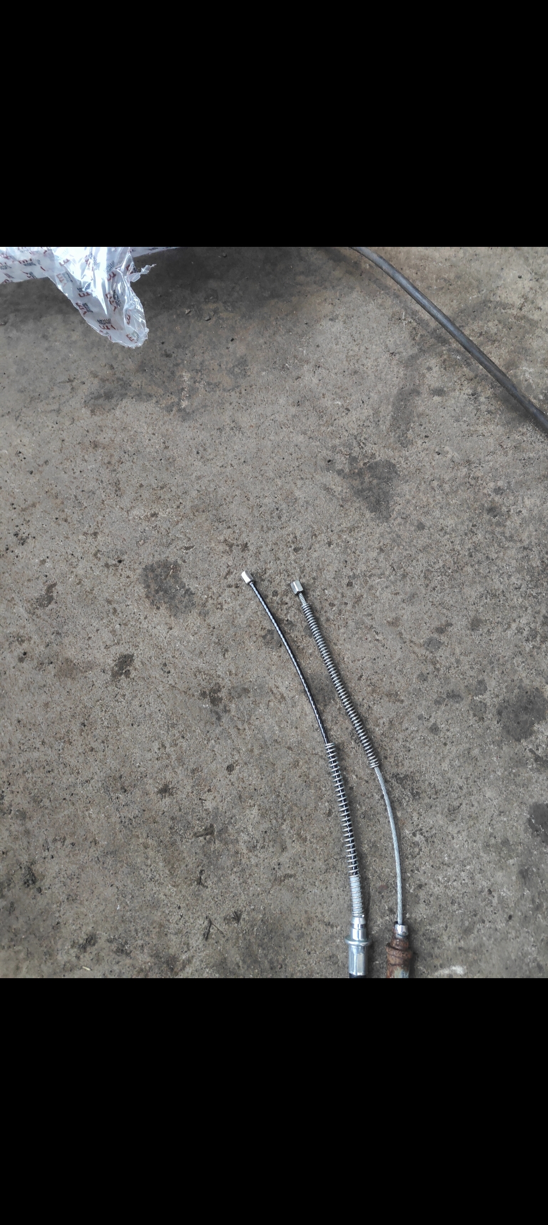

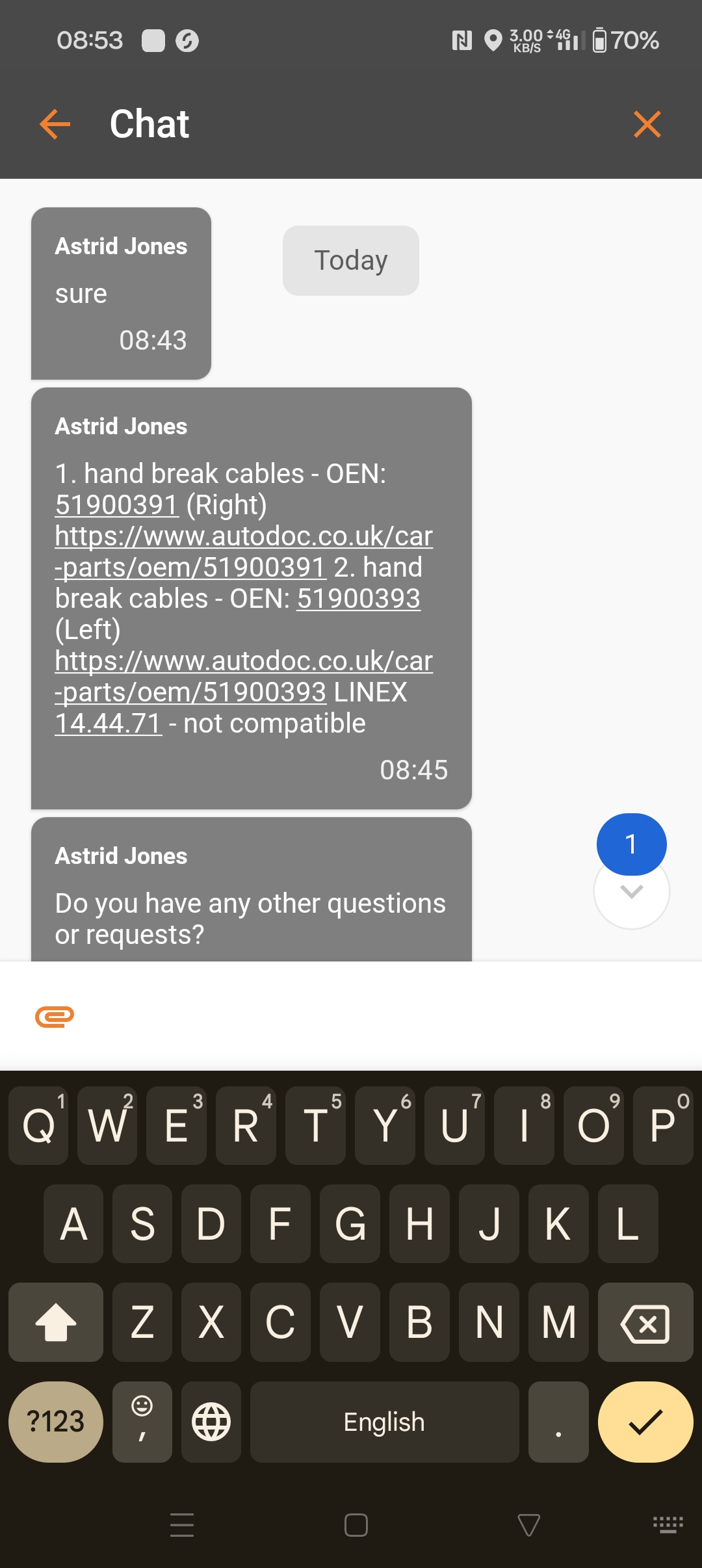

After very long and torturous chat at autodoc involving you said i said they said I pirchaced wrong rear cables.
The ones that are supposadely right ones cost 26 pounds both from NYC.
We will see if they will be the right ones. Autodoc refused refund! I am very upset with them i ended up having a discount coupon but still i lost 100 pounds plus for mechanic job. Tragedy.

Also up until now autodoc could have told me the oem number without me looking for it and removing the part which is ginormous help

An update. We ended up not changing the wheel cilinders due to pressure from mehanic.
Only changed the cables. Turns out one bend fixing was missing and he had used a cable tie to fix it before. We used now an improvised rubber fixing to bend it approximate to specs and now cables come even at the end of the handle break. Now the hand break feels very safe and fixes the car even on slopes. We can not move it.
Before it felt like a spring and it was very unreliable.
