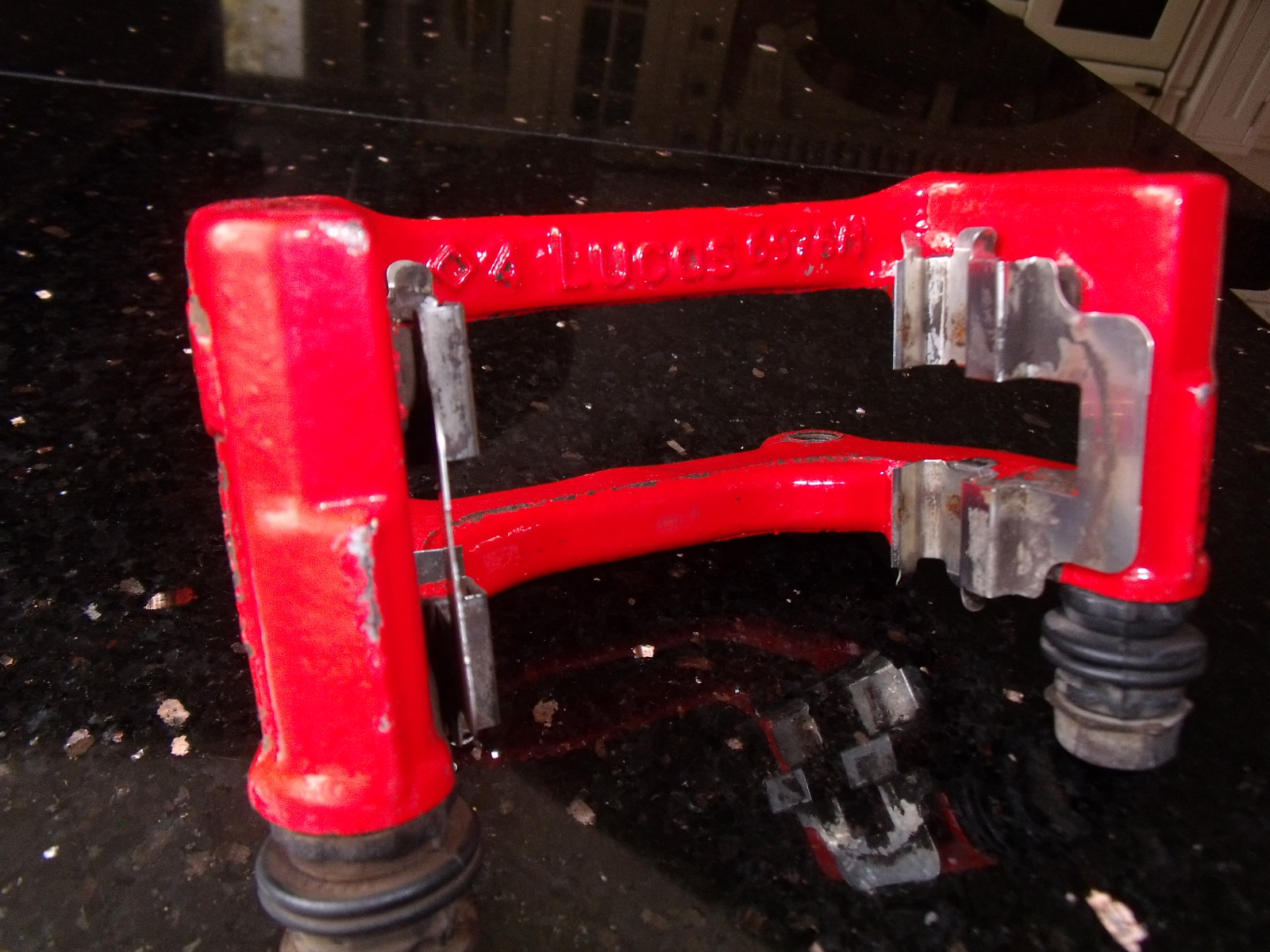

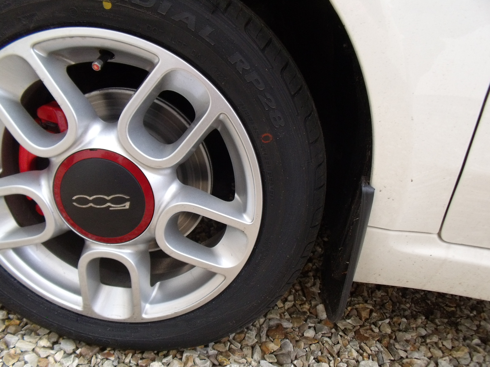

I don't know if all the cars use the same callipers as mine were a Lucas design and I do see cars advertised with Brembo.
That said Simon is quite correct if dealing with the Lucas design as the top and bottom ears of the pads just slide in stainless steel carriers. There were no 'pins' in mine albeit I did see these being removed on the youtube video but again the callipers being shown were not the same as mine.
The pads were removed by first taking off part of the calliper with just the two bolts screwing into the slide guides. There were no pins as the pads don't just slide out.
The lower stainless steel guides were contaminated with quite hard deposits that had to be scraped and cleaned and this is no doubt what can cause the pads to stick.
I see some brake pad kits come with these new guides and they just simply clip in but being stainless they cleaned up perfectly.
Yes on the rears you need a wind in tool but not on the fronts and don't forget to release the brake filler cap before pushing back pistons. I borrowed one off our local garage
If the same as mine the rears were a pain as removing one of the allen head bolts to remove the slave part of the calliper was not easy and again the youtube video said it was a 14mm hexhead bolt which would have been fine but the correct process if the allen heads is fitted instead is to remove the whole hub just to get the tool into the allen head bolt.:bang: Of course this is only needed to be done if changing the disc/rotors at the same time and not required to be done if just changing pads.

The pins are there in your photo same design as 90% of sliding callipers bout sure why you said there aren't any pins?
I think he means the different design of calipers where you have a metal pin that goes through a hole in the back of the brake pads securing them into the Caliper but it still lets the pads move in and out. I remember my old SAAB had brakes like this and it’s the standard design for performance brakes like brembo.
Absolutely correct Andy:p........'she' did refer to the usual pins that are slid into hold the pads in place. The you tube video I watched had these long retention pins on the calliper to retain/remove the pads without having to part the calliper. Although it was showing a 500 it was nothing like mine and it was jackwhoo who sent me the Abarth video which was same as mine. When I refer to the moving parts on the sliding callipers I usually say pistons or sliders rather than pins.
