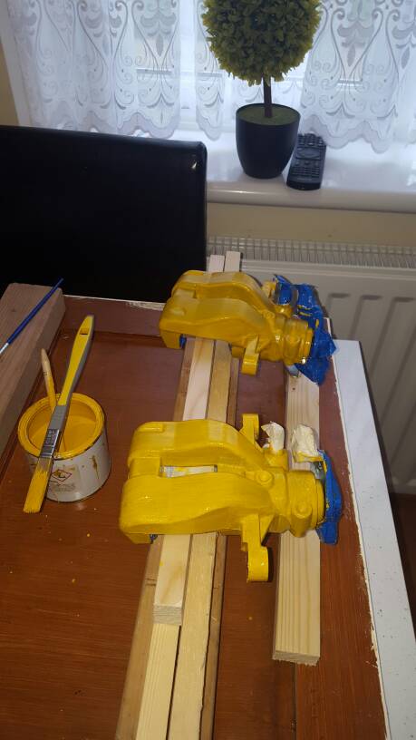

I've checked out stilo calipers and the guy selling them on eBay assures me the stilo ones will fit my bravo... result.
So I'm having BOTH rear calipers for £108 instead of paying that amount for 1 for the bravo ;-)
I'd give them a couple of coats of Hammerite before fitting as it's much easier and you'll get a better finish. Then just a touch up when there on ?
