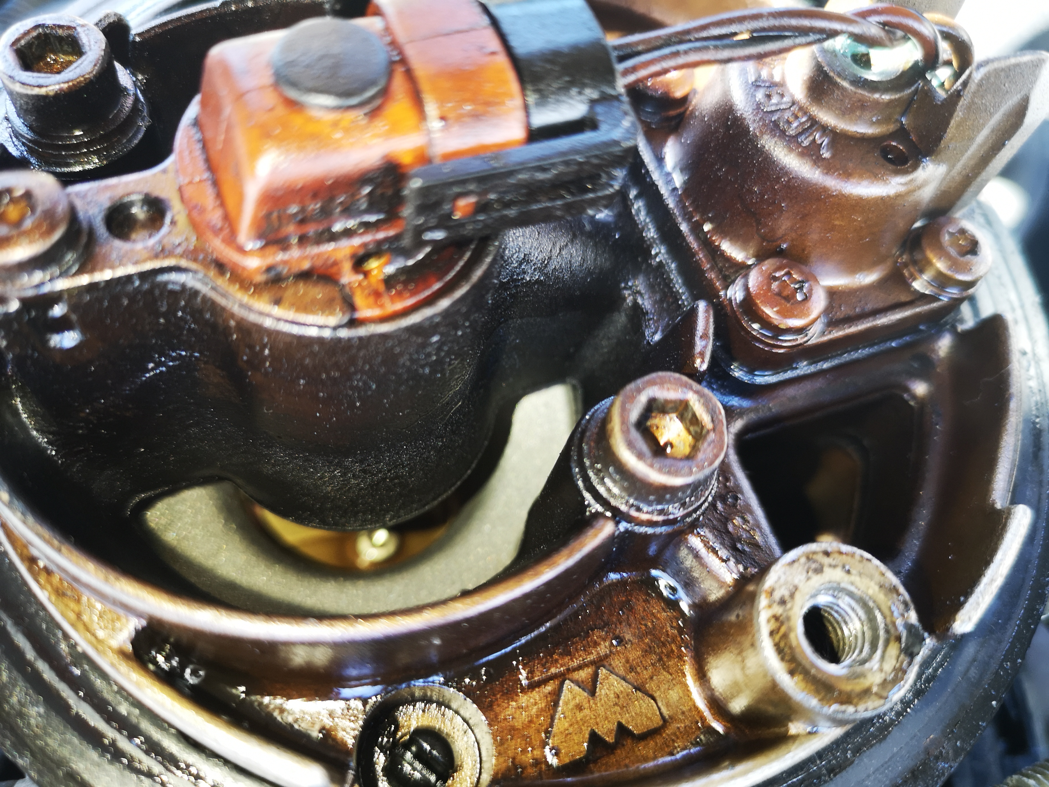

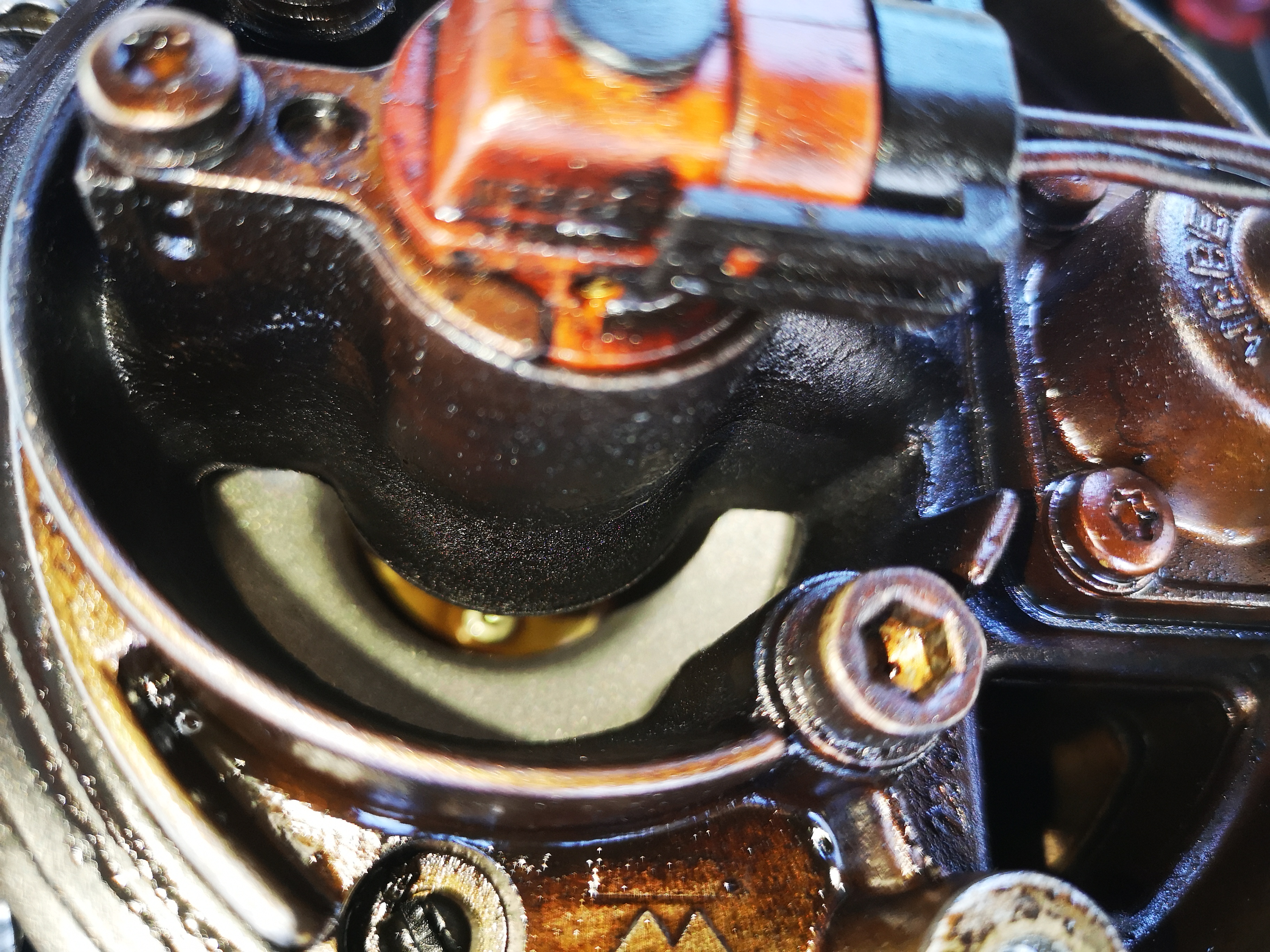

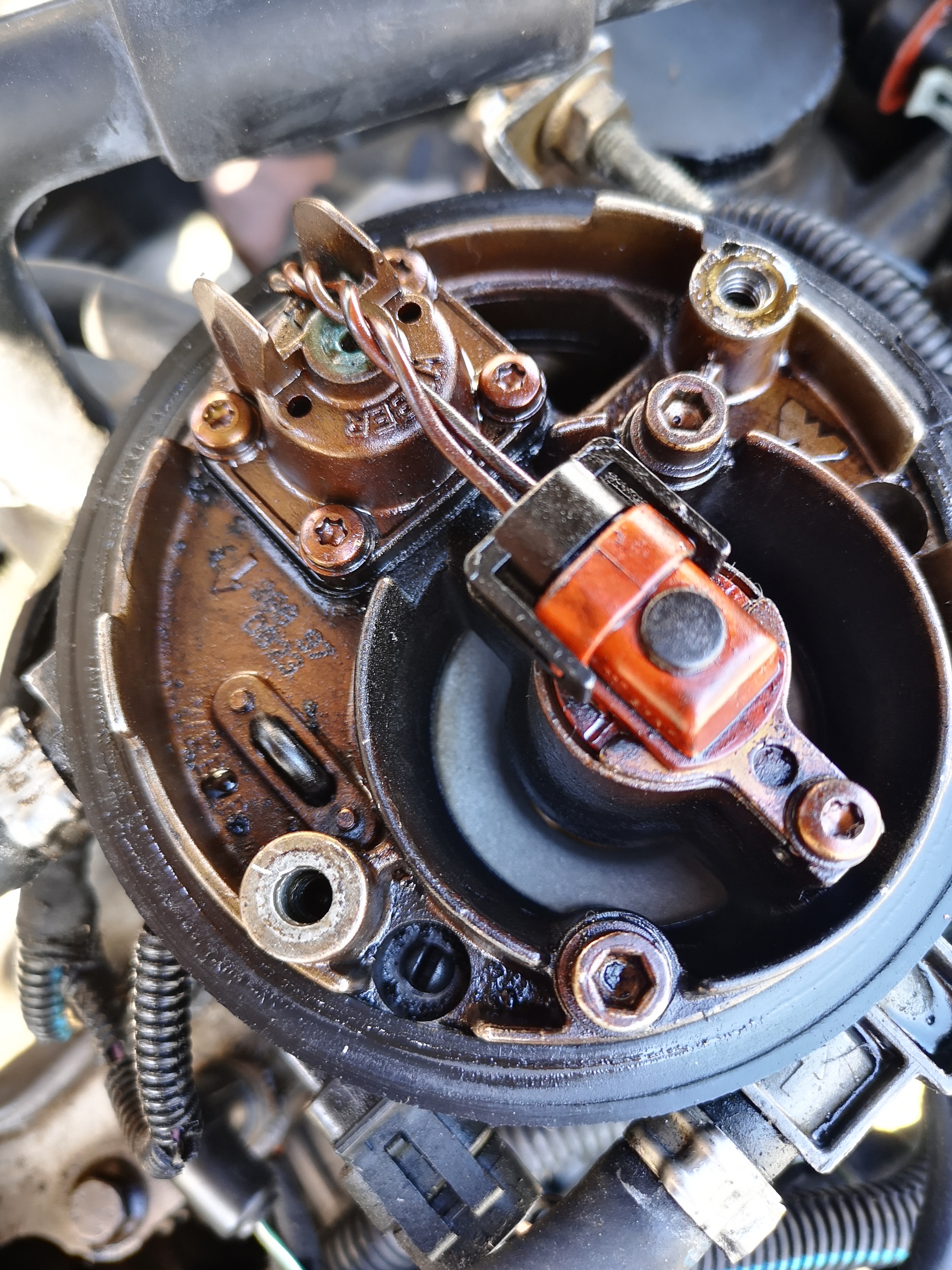

Hi good people.
Don't know if anyone can tell me why is the carburetor on my fiat cinquecento 899 98 doing this noise? (i made a video on YouTube with the noise)
https://youtu.be/YxXfCwBhouE
If anyone could give a clue what's wrong?
I've posted also some images of the carburetor inside..
Thank you very much everyone.

Not a carburettor, it is fuel injection.
But I don't think the noise is from there.
It could be a stuck tappet on a rocker arm.
Does the frequency change with RPM?
Is it different when started from cold?
Is it better (or worse) after driving?

Yup, David C is absolutely right, this is not a carburettor its a fuel injection unit - to be specific SPI, which means Single Point Injection. It was the system which replaced carburettors and is to some extent like a carb in that it delivers the fuel into the main air intake manifold but does it in a much more controlled way so cuts pollution and gives you better MPG. Later they went to MPI Multi Point Injection where there is an injector poised in the manifold pointing at each inlet valve, which was more efficient still and they've even moved on from that now with Direct Injection, but that's of no interest here.
If you look at your original pictures you will see a yellowish brown "thing" with 2 wires going into it situated above the intake venturi. This is basically a solenoid which is metering how much fuel is being injected into the engine. The noise you can hear is the pulsing of the moving parts inside it. In very simple language, how it works is that the ECU sends a pulse of electricity down those wires into the electromagnet inside the yellowish brown unit. This magnetizes it and it pulls the core "slug" up so opening the petrol delivery jet. If you look down the venturi whilst the engine is running you can see the petrol spraying onto the throttle butterfly. Be very careful though, it's easy to cause a fire! This solenoid unit jiggers up and down at high speed and the longer it stays up compared with when it's down it will admit more fuel. It's complicated. What you are hearing is the solenoid valve jumping up and down metering the fuel being delivered to the engine. If you look carefully you can see it's not a smooth stream but a rapidly pulsed delivery. It's normal.

As for his noise, it's really difficult to tell via the Internet, but that sounds very loud to just be the injector, but it could be a very sensitive microphone!!

In any case, whether it be the tappets or the solenoid inside the throttle body, it's pretty normal to hear. I'd only be concerned if it doesn't settle down when the engine has been running for a while, has warmed up and you can hear it clearly inside the car with the bonnet and doors shut.

Ok, looking at the video, The fuel is coming in from the tank via the bottom black fuel hose and travels through the passages in the injector unit to the metering unit directly above the air intake/venturi. This fuel is under high pressure so, when the Metering Unit triggers, fuel is squirted violently down the air intake to the engine. Any fuel not needed at that time continues on past the Metering Unit into the pressure regulator (which is what that thing is that he's adjusting with the Allen Key.) Inside this is a diaphragm with a spring behind it. The diaphragm is trying to hold the fuel flow back to give a constant pressure of fuel at the spray nozzle in the metering unit. But when the pressure gets great enough the diaphragm will lift against the spring pressure and allow excess fuel to return to the fuel tank. So what it's doing is maintaining a certain constant pressure of fuel at the metering unit and the whole system will be calibrated with this in mind.
By screwing the adjusting screw in - as the video shows - he's increasing the fuel pressure and the ECU won't "know" this so one of the parameters the ECU relies on to correctly calibrate fuel delivery will no longer be within specification. I suppose increased pressure may make for better atomisation of the sprayed fuel? but will probably have other implications too? Personally I'd not be fiddling with this unless I knew what the pressure should be and could connect a pressure gauge to the supply side so I could monitor it and achieve the pressure specified.
