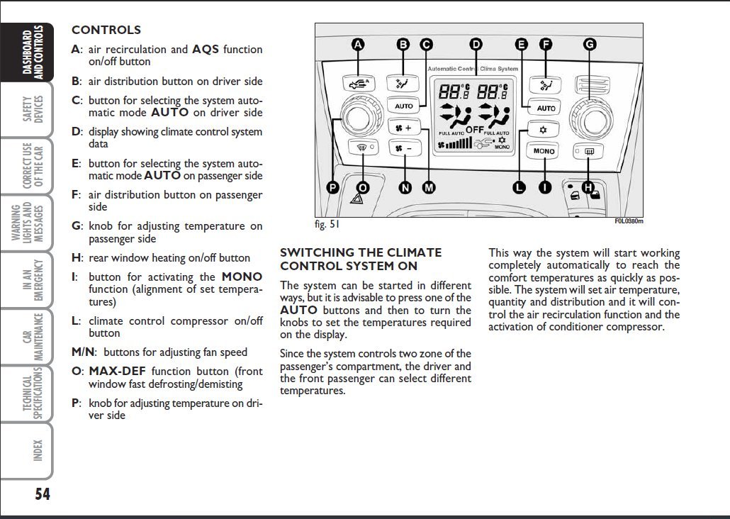

Pressing button A will influence the degree of rat-tat-tat.
When stationary and switching to airflow re-circulation, the shutter valve behind the pollen filter closes, about 20 rat-tat-tat's are audible.
Switching to automatic, letter A is visible on the screen, no sound is audible.
Switching to fresh air from outside to inside, shutter valve opens, only 2 times the sound is audible.
During driving, only just before car stops and system is on full automatic 20 times rat-tat-tat. Probably the valve closes.
During driving and ventilation on re-circulation, no sound at all.
So most probably the sound is created by the mechanism that moves the shutter valve, don't know how to reach this.
