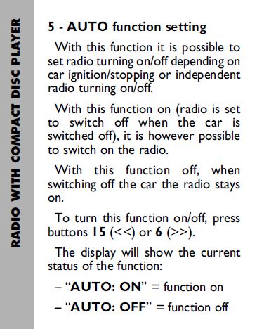

when i take the key out raido say on for 20 min i want it to go off when i take key out fiat stilo raido compact disc player thanks
Press the "MENU" button for more than 2 seconds to enter the second level menu.
Press the "MENU" button repeatedly until you get to the "AUTO" function (should be 5 times).
Press the "<<" or ">>" buttons to turn the function on or off.
