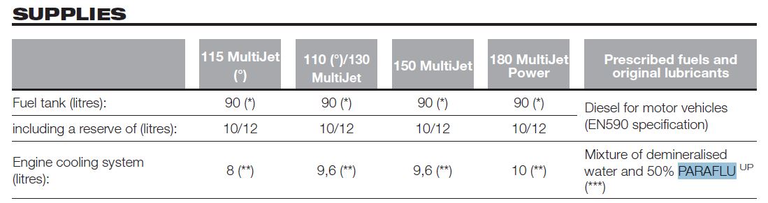

Attachment is from the specs in a 2014 manual (there is little or no difference by year for the X250)
Note, the quoted capacities are where no auxiliary heating is fitted - it is unlikely you will have any.
9.6 litres doesn’t seem enough to fill the rad? Is that just the Paraflu?
The spec is 9.6 litres total at 50:50 mix.
(The content of the radiator is actually relatively small, most of what you see is cooling fins)
Though, if you had to top up with a little de-ionised water, it really shouldn't be an issue in prevailing UK temperatures, since 50:50 will nominally protect down to -35°C.
