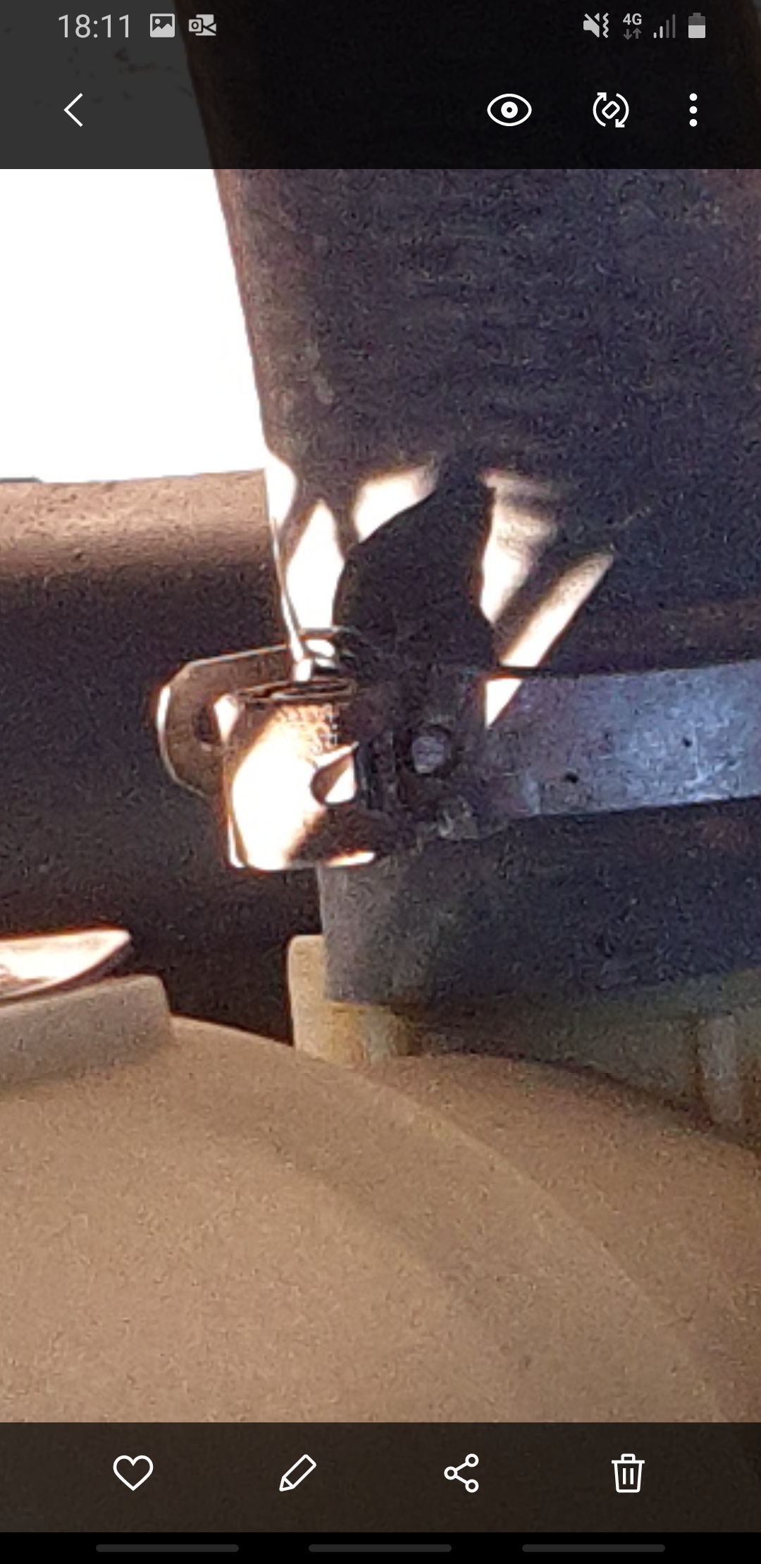

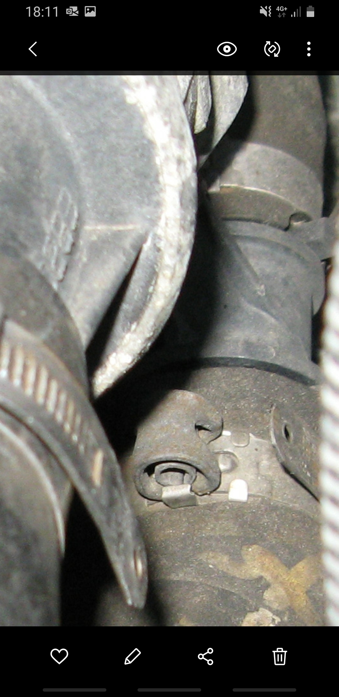

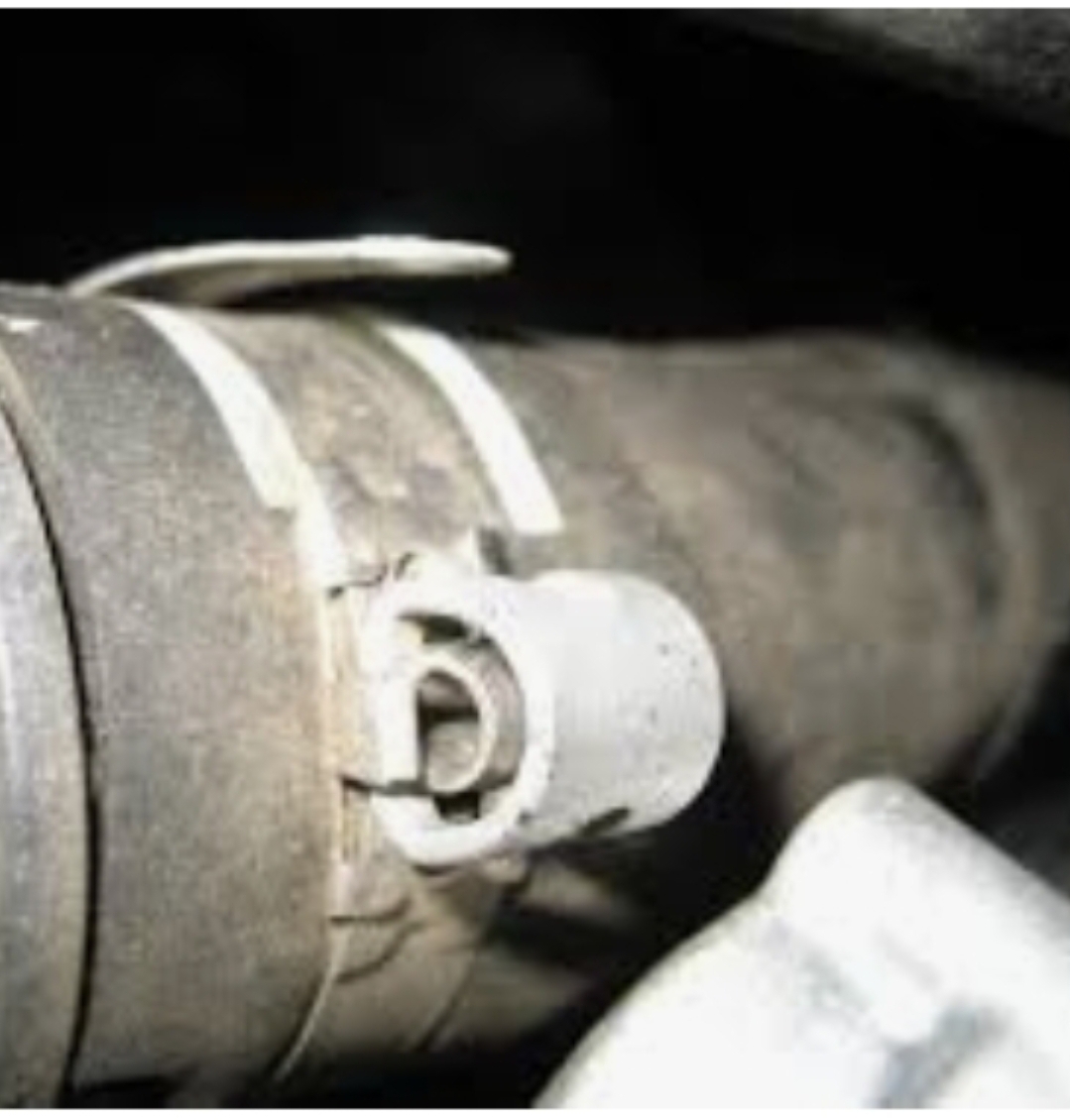

Does anyone know how to open this clamp on my radiator hose. I have attached 3 pictures of the same clamp.

Hi :) Special tool needed..
You can break the large clip holding the pinched.up band..
Remove hose.. then fit a new conventional hose clamp
SEARCH: Hose clamp
in the Panda section ;)
Same as this, just break it off with a pair of pliers and put a normal jubilee clip in it's place. Measure the pipe first so you can get the correct sized jubilee clip first before you make the car undriveable!
The other hose in the third picture has what looks like a jubilee clip on it.
I find it easier to get a hacksaw and carefully cut through the clamp
paying attention not to damage the hose.
tony
Access will be the determining factor.. ;)
Ive used A saw once.. because the crimped part of clip was hidden :eek:
But I prefer slackening the pinched part if possible
.. virtually zero chance of hose damage :)
