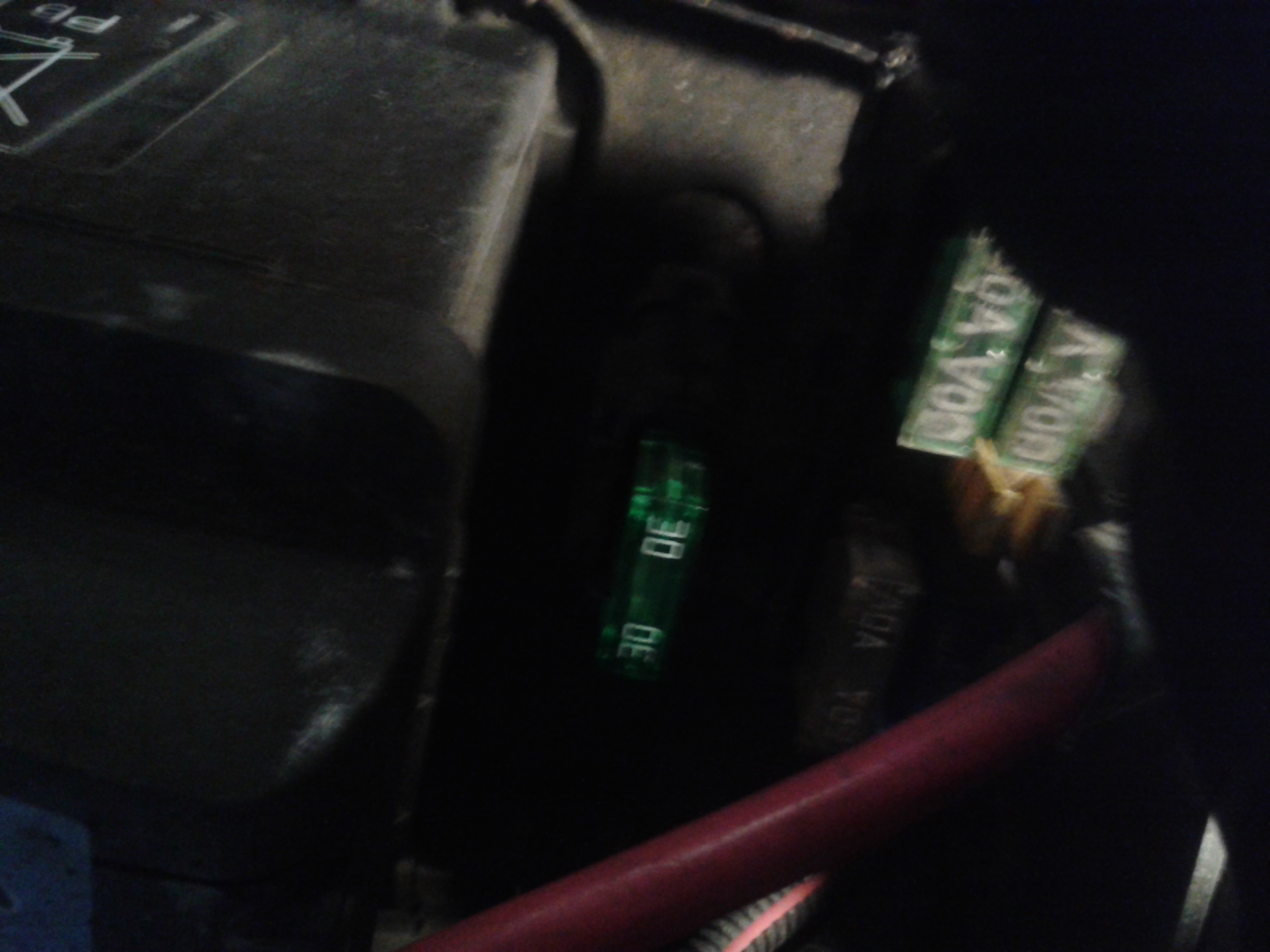

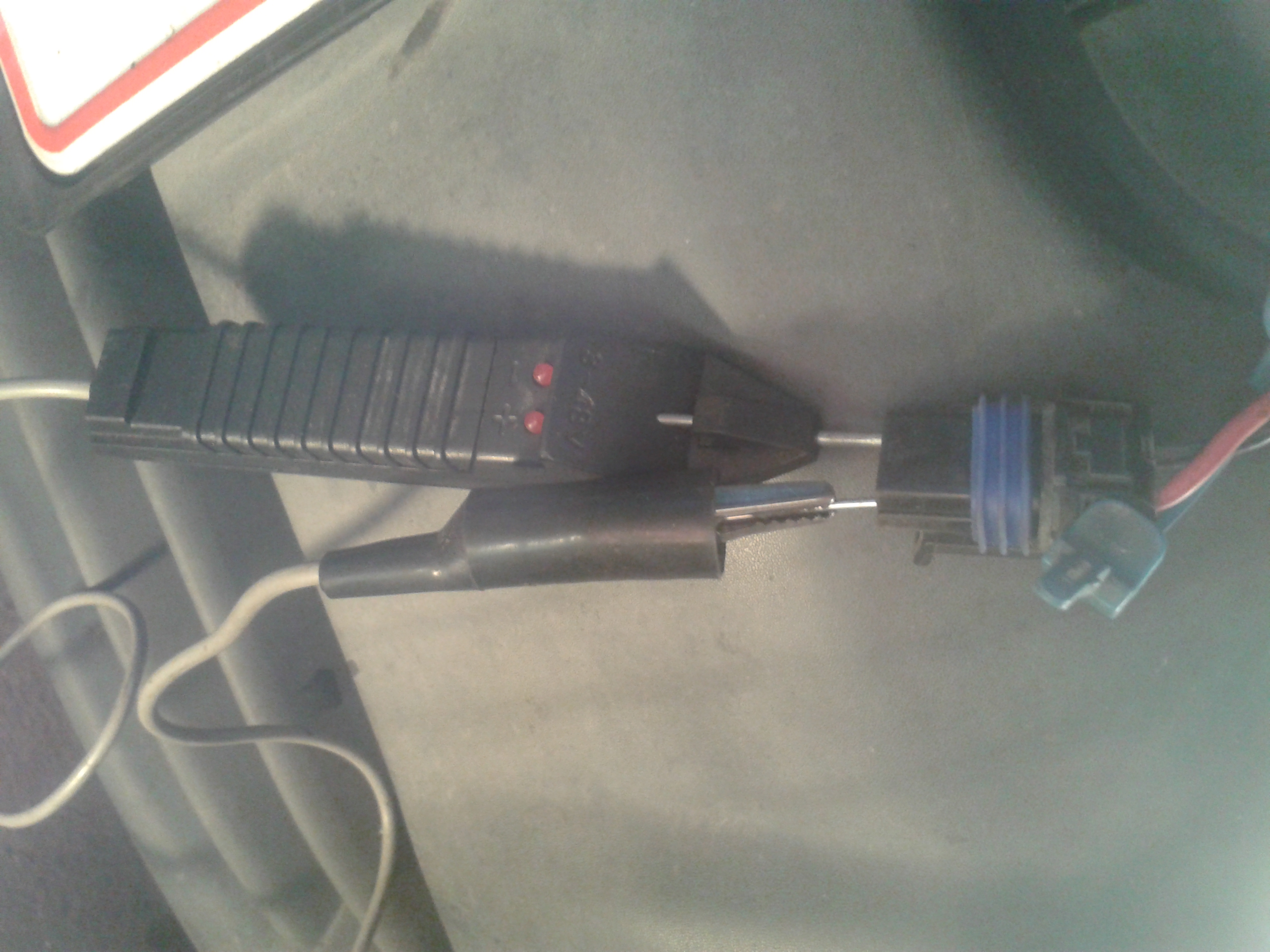

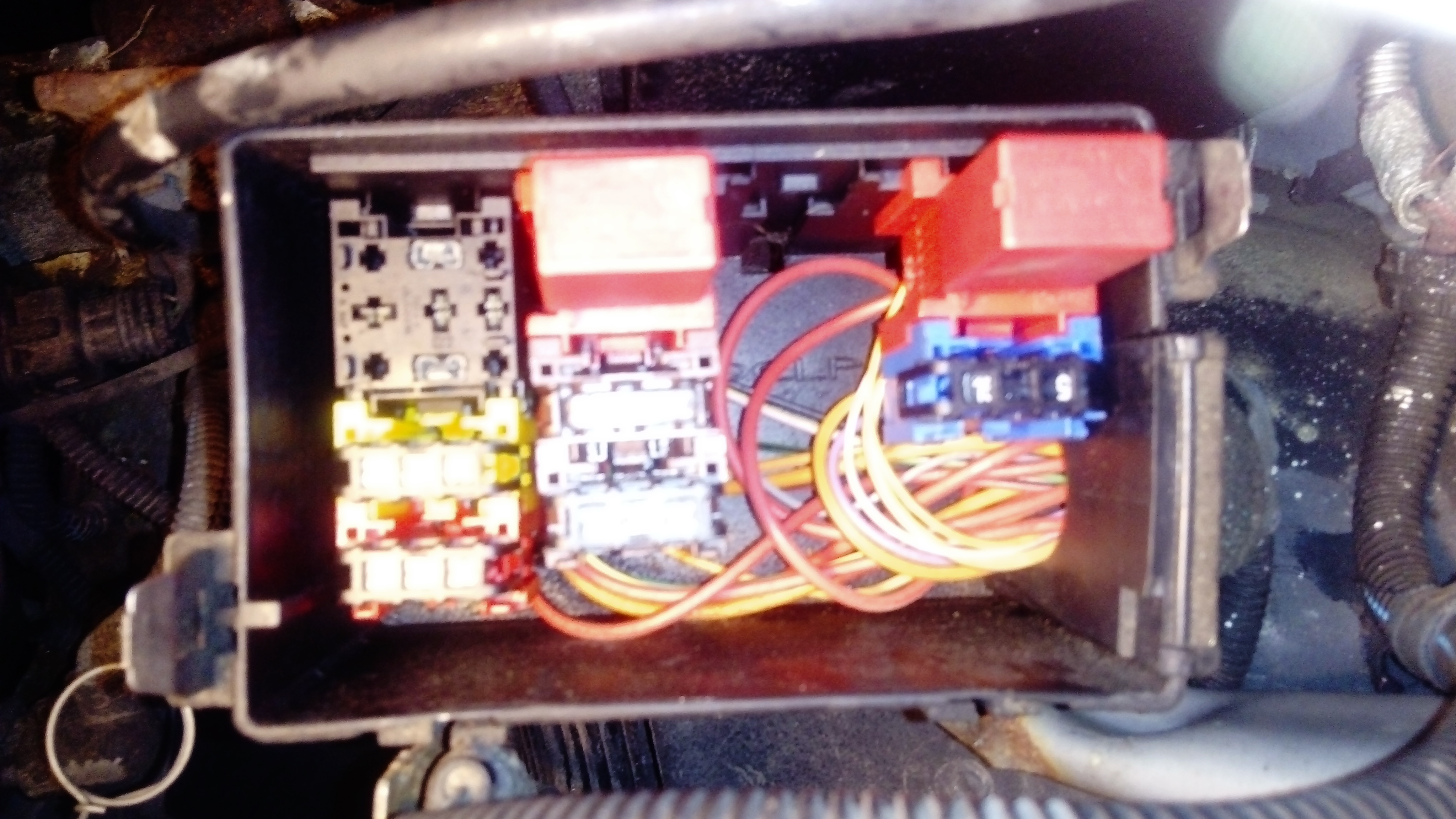

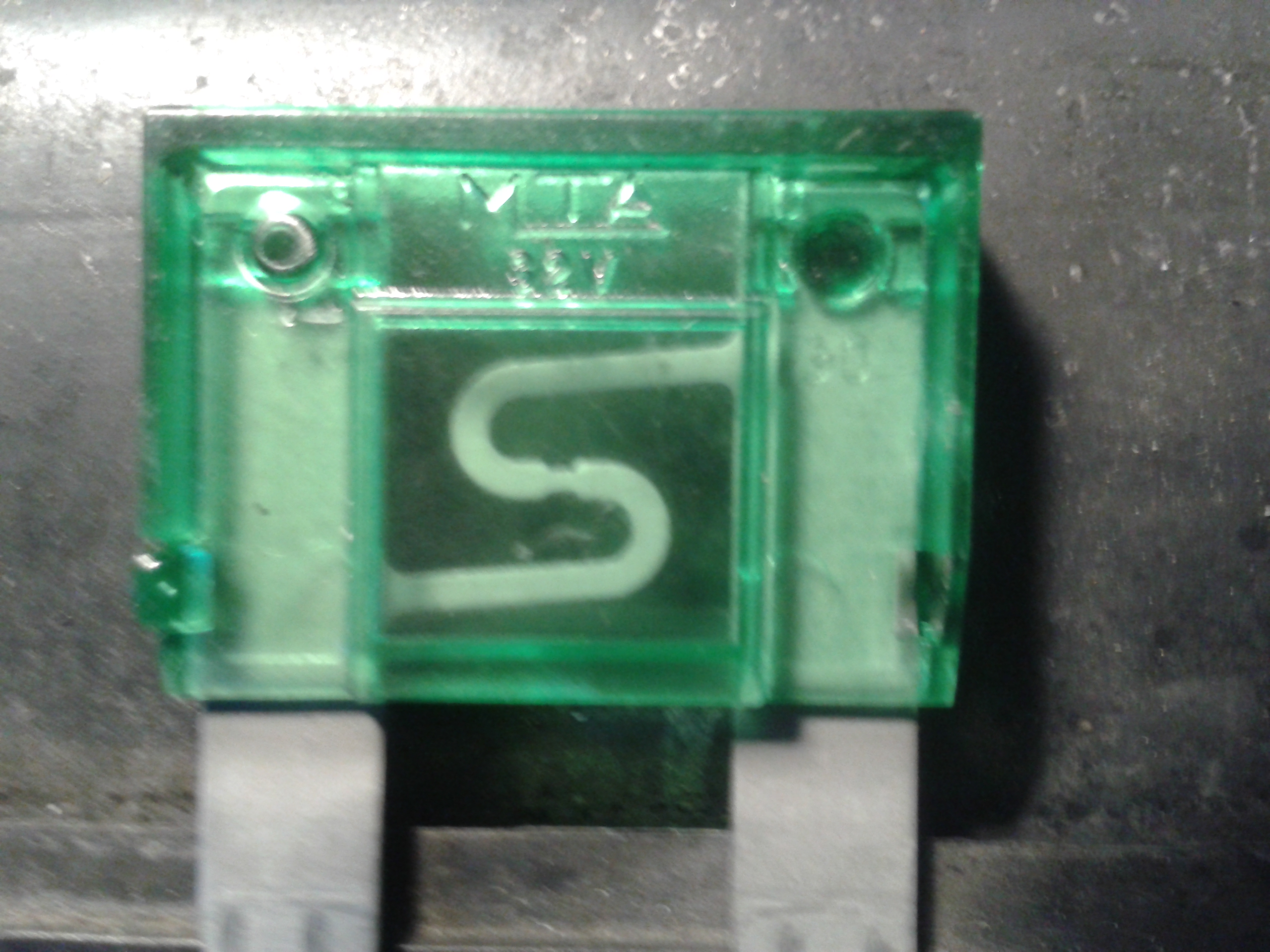

But I think that something is broken because I tried the engine overhead a little connected a lamp to the power connector for the fan, but nothing lighted up. I checked the fuse for the radiator fan in the engine bay, but it appears not to be OK.

I did mean: "I checked the fuse for the radiator fan in the engine bay, but it appears to be OK"
