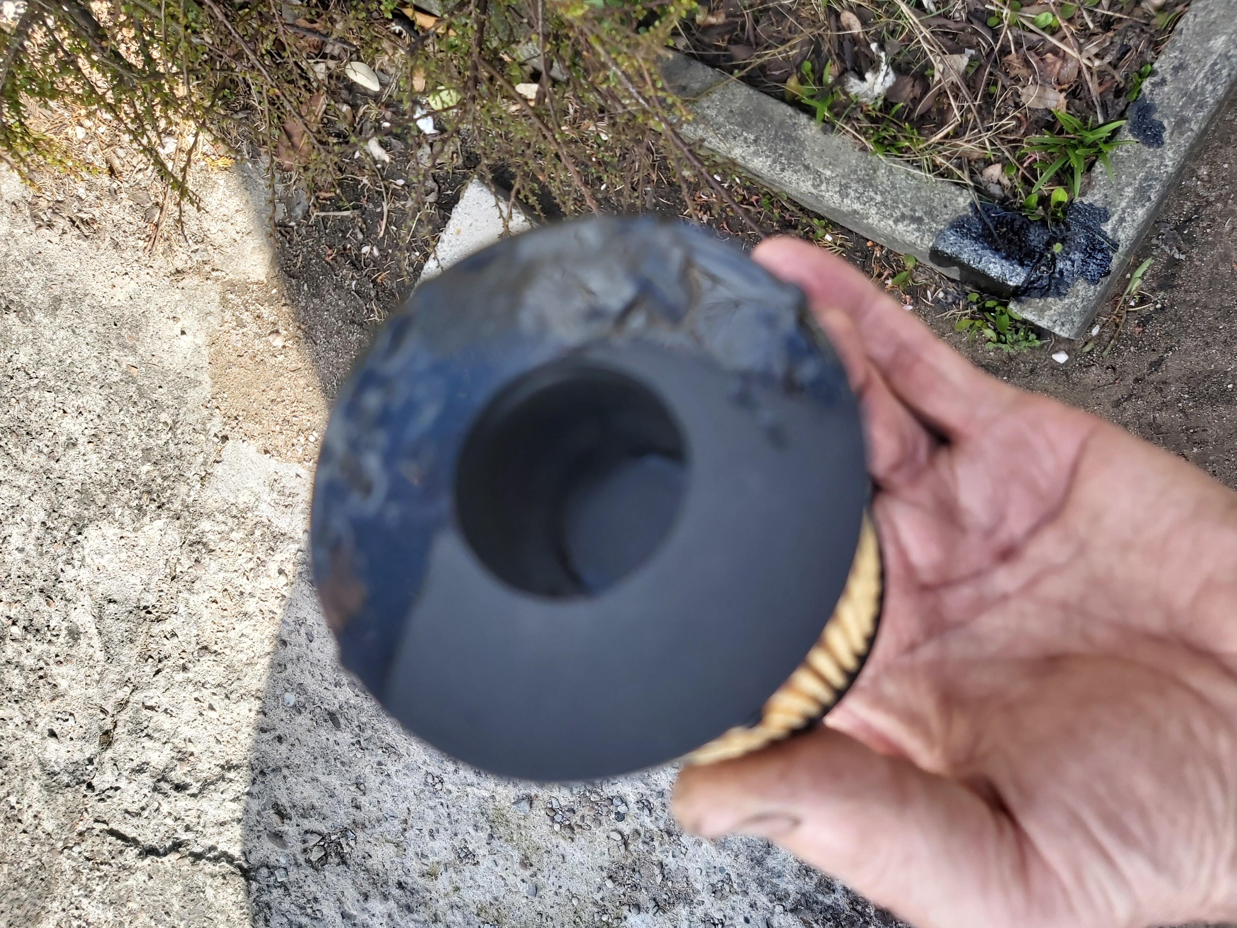

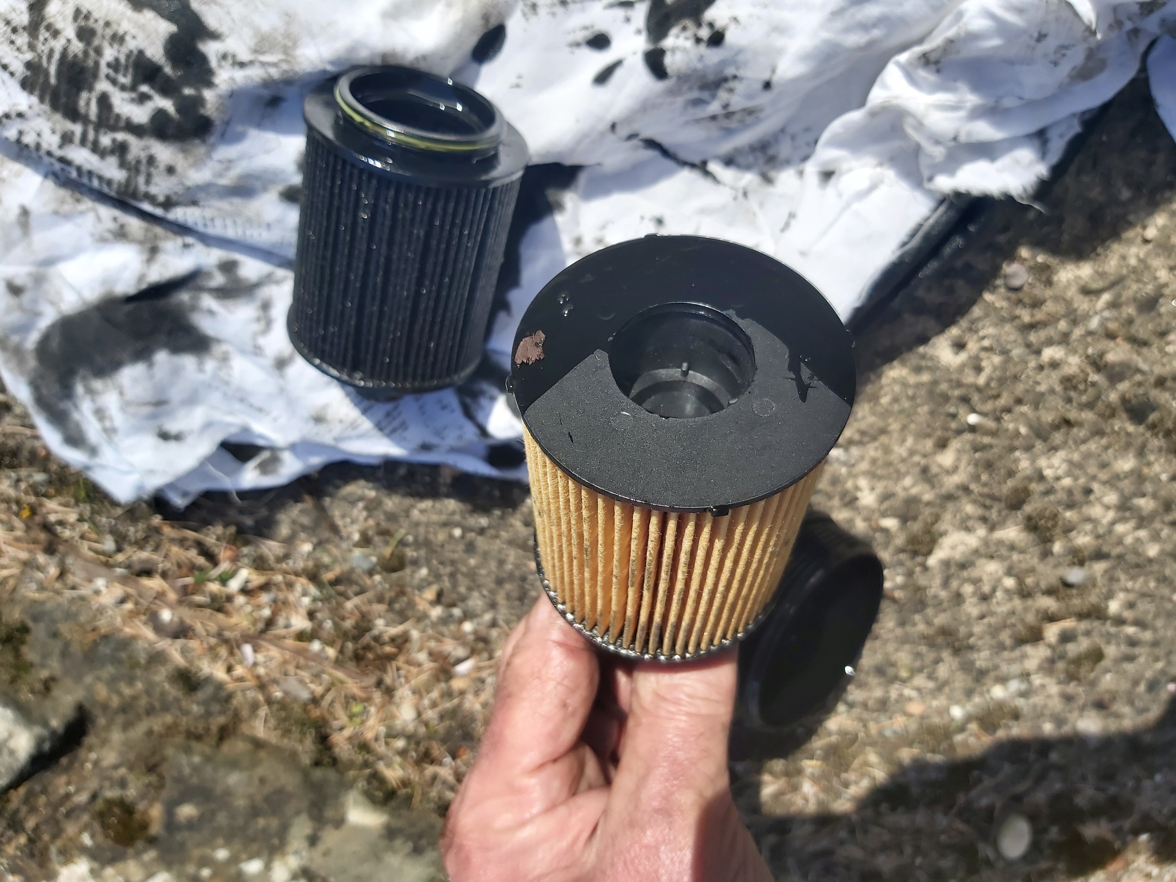

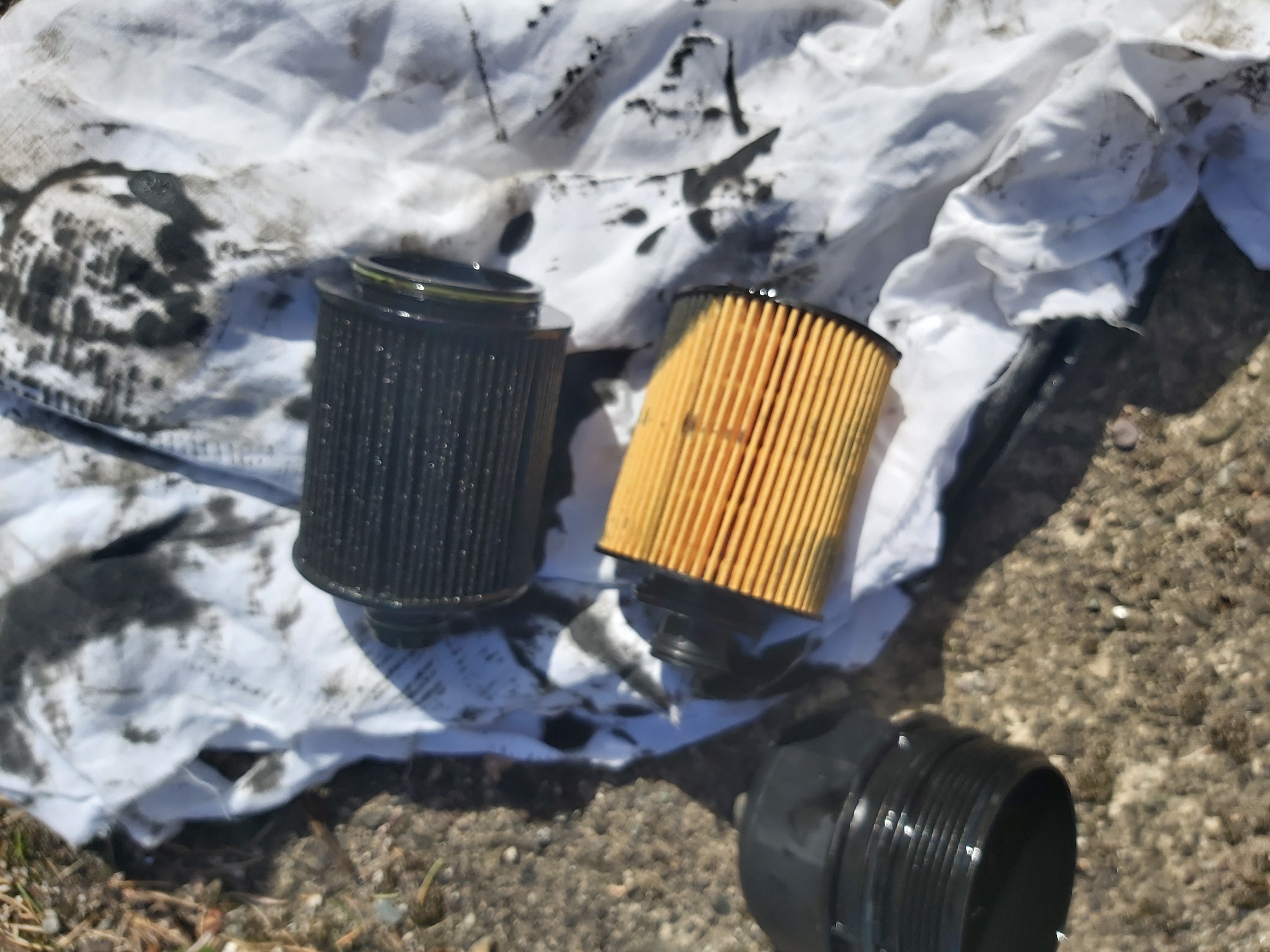

I've bought 2 oil filters on line for my qubo 1.3 diesel, 2011 75hp model, neither fit. The latest one looks similar but is a different size top and bottom. Where am I going wrong? Any advice please?

Hi
There are three types depending on the housing type
It seems to be random which one you get I was lucky and got it right first time
Take your filter to parts dep or buy all three and take the two back that are wrong
Thermostat housings are the same they look the same from the outside but are different inside the housing on the inside....That I did get wrong the first time

Thanks chaps, I think I know which one now, I watched a 2012 corsa 1.3cdti oil change on youtube, 95ps engine, filter looks like mine. Although a compatibility search says it won't fit my 75ps engine. Looks the fellow to me though. Will order it up and see. thanks for the tips.

The cap where the big hex is SHOULD have the manufacturers name ;)
The oil filter looks the same but the fuel filter and engine looks different to my qubo.
