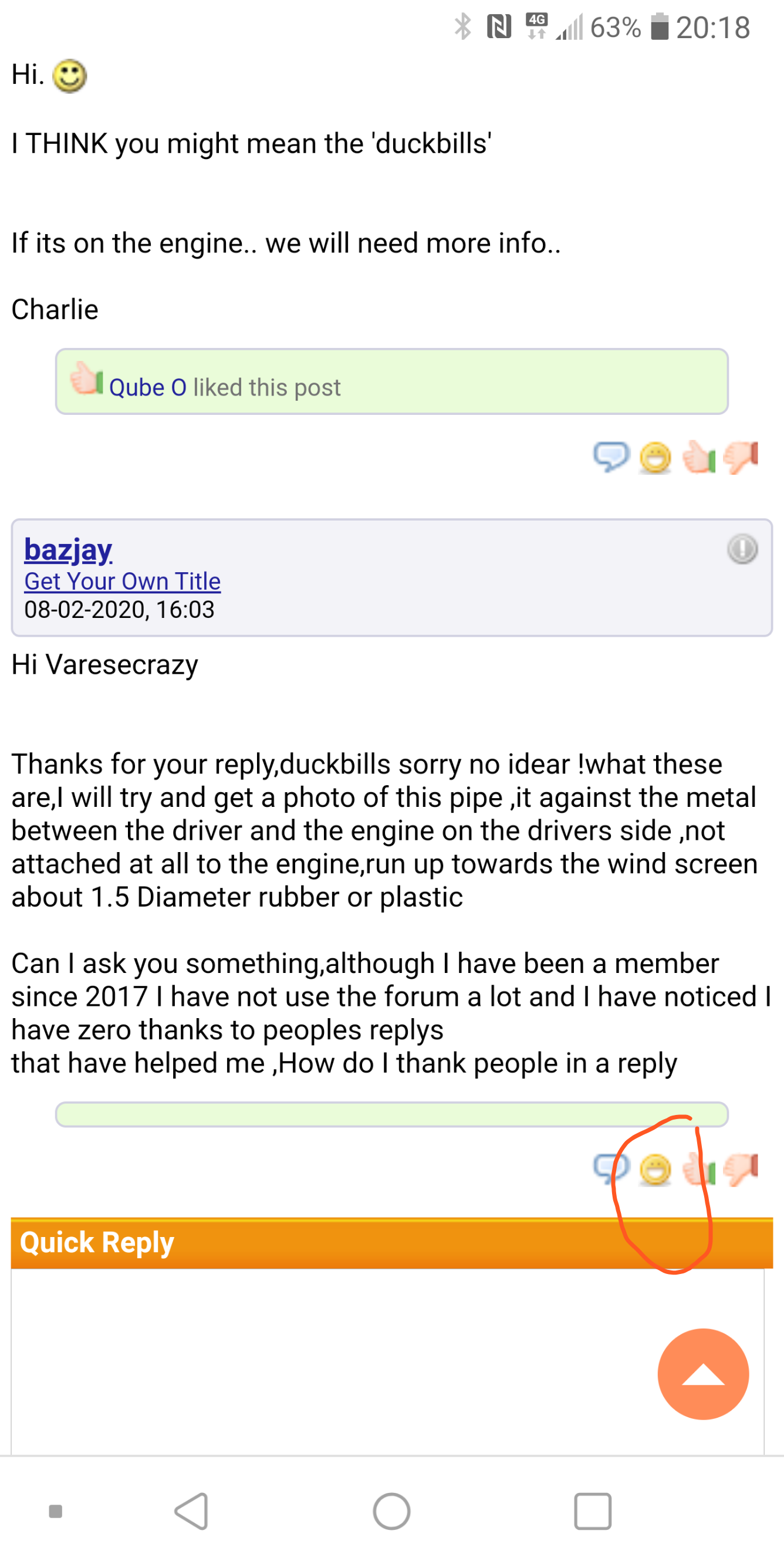

Hi All
Just noticed a water leak from what appears to be a plastic or rubber closed pipe,directly in front of the drive position,in the engine bay.
Looks like maybe part on the washer system,but relay no idea,not a bad leak but will get worst.
Any ideas on fix or replacement,or even what it is ??.
Thanks bazjay
Hi Varesecrazy
Thanks for your reply,duckbills sorry no idear !what these are,I will try and get a photo of this pipe ,it against the metal between the driver and the engine on the drivers side ,not attached at all to the engine,run up towards the wind screen about 1.5 Diameter rubber or plastic
Can I ask you something,although I have been a member since 2017 I have not use the forum a lot and I have noticed I have zero thanks to peoples replys
that have helped me ,How do I thank people in a reply

see attached

SEARCH on the forum is great..
You can select a term 'duckbills'
Then select a subforum
Tech. DOBLO..panda..etc
The area you mention is known as the Scuttle
Its a big metal trough..
It is where the cabins clean air is fed through.. and these rubber pipes are its drains
Shaped like a 'duckbill' ;)
If you squeeze the edges.. water will flow..along with leafmold probably.. :eek:
