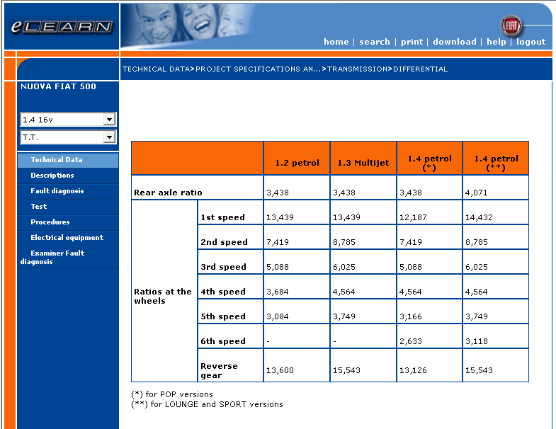

Only just read and is too late now you finally have the part (odd it took so long), but a 1.4 16v 500 'pop' (only) model has a high final ratio (same as the highest 5 speed box of newer era (3.8:1). This offers a very tall 6th gear and also a good taller-than-any-5-speed-box 1st gear with close 2nd, 3rd and 4th. Ultimate combo for most modded cars, unless anyone else knows better.
Just out of curiosity but why the pop? Does it really have a different box to the lounge and sport? Not doubting you, just don't see why Fiat would fit a different box :)
Same box, just different final ratio of course. I suppose it is to help distinguish the models and make it less sporty and have better MPG figures instead. Check out the attached from the FIAT eLearn CD. They could be lying and it may not be in the UK. It's a tricky one, as these things can't be found out on ePer as I discussed before in a really boring gearbox final drive thread.
Above where I said 3.8:1 I meant 3.4:1 ;)
