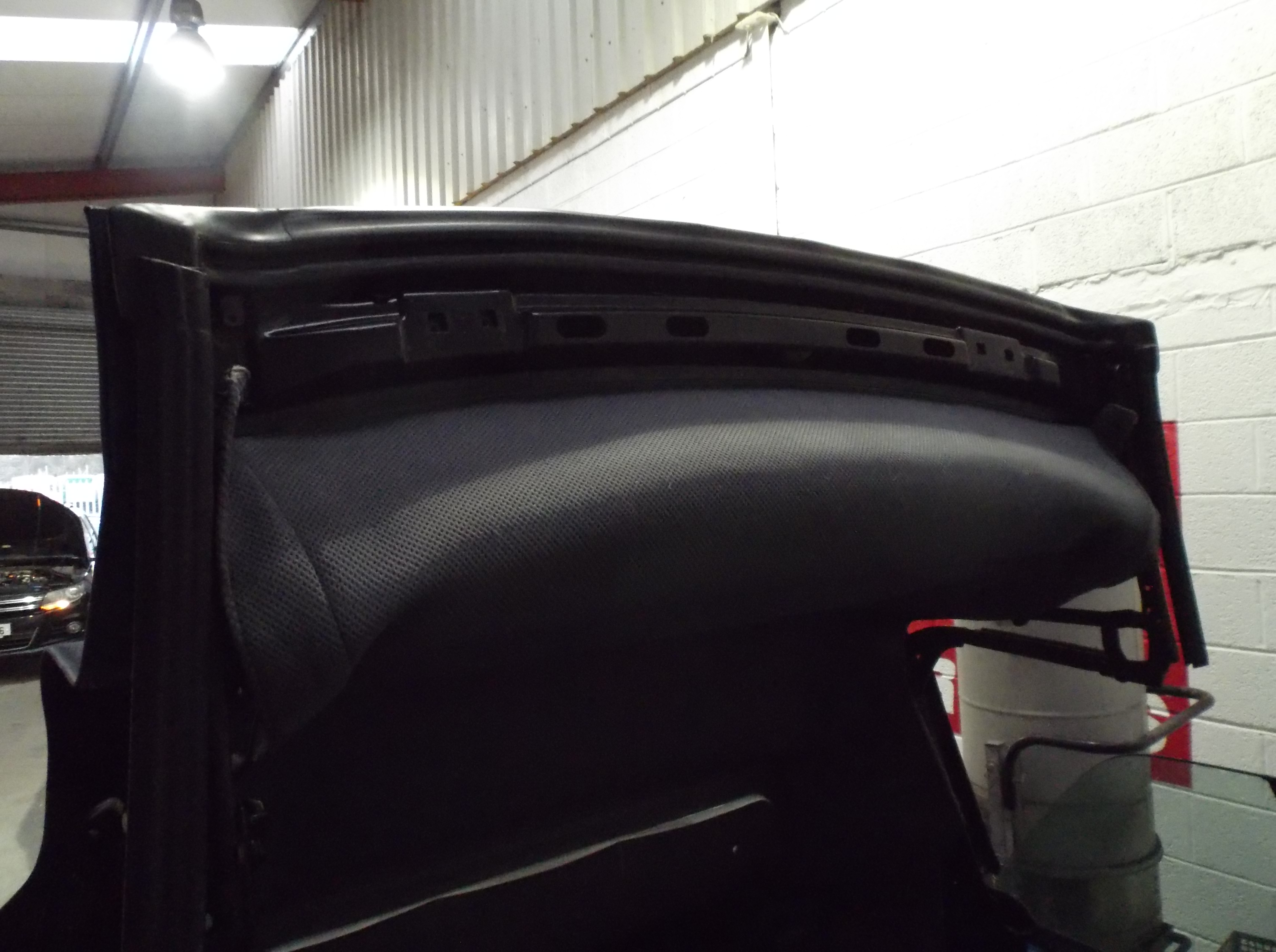

If you come across a Punto Cabrio in a yard, I am looking for the front seal for the roof, it is the one that is U shaped and has a small metal strip that holds it in It goes right across the front of the folding roof and seals on the windscreen surround. It's actually the metal strip I need more than the seal but they come together, Mine is a bit rusty. I did see a yellow cabrio in a scrap yard near Turin when passing 2 yrs ago in the camper.
No problem - could you possibly send a pic? I am spending a whole day going round the scrapyards, but as they close for 2-3 hours at lunchtime it's always hard to get more than 2-3 in!
This is very OT but can I attach picture to private message ?, Wanted to send pics to Westernancia but can't seem to do it.. I putting them up here as this is where we discussed thepart required. Admin please remove if necessary.

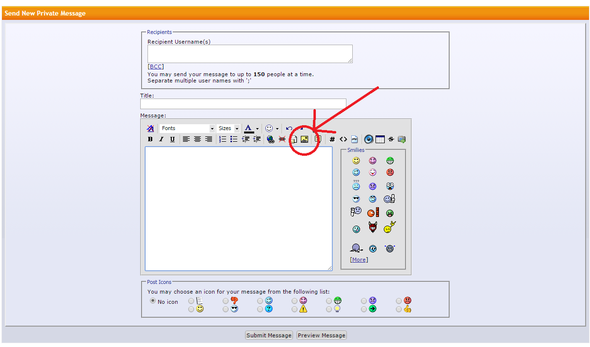

yeah you can.. you just can't attach them like in a post.
click the little image select button in the PM page
It will ask your for the URL, now if you have it on another website or your facebook or something you can just go there and right click the image and copy image address, then paste it in the dialog box... bear in mind if you do this the link to picture will be broken if the image is deleted from its original location or its moved etc.
alternatively or you can stick them in the misc pictures gallery of the forum which is here https://www.fiatforum.com/gallery/showgallery.php?cat=1163, then once it uploaded do as before, right click, copy image location, paste in dialog box. then just press OK. That way the image link will never be broken ever, same goes for posts on the actual forum - you can link to images off the site somewhere else but if you attach it or upload to the gallery they will never become broken image links. To this end you are not supposed to link to external sites for images in the members motors section or in the guides section. Its not a rule elsewhere on the forum but is preferred that images are hosted on the forum for that reason.
Make sense?
