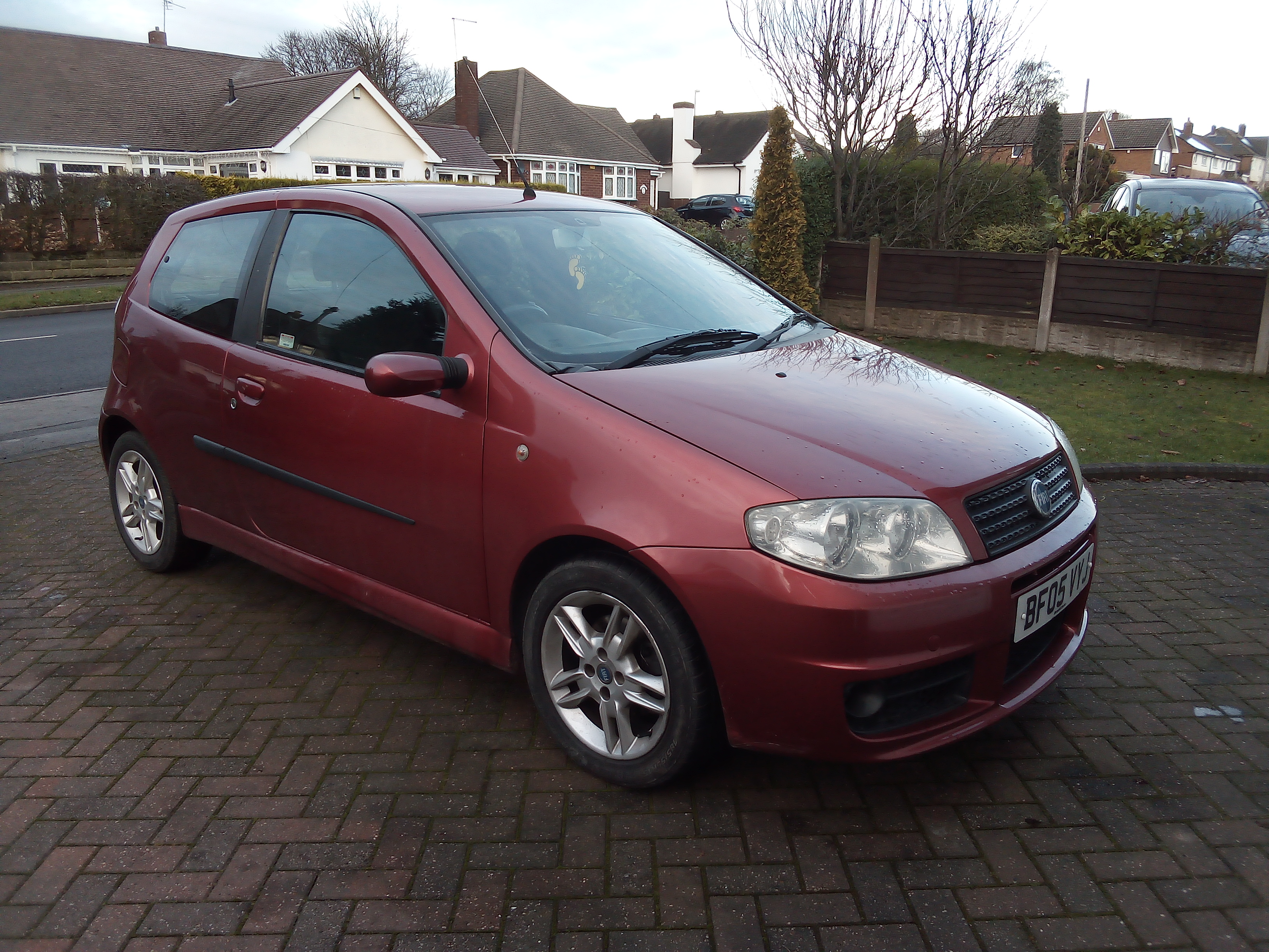

An as I've yet to add a picture of said Punto. Here a recent photo. :)
