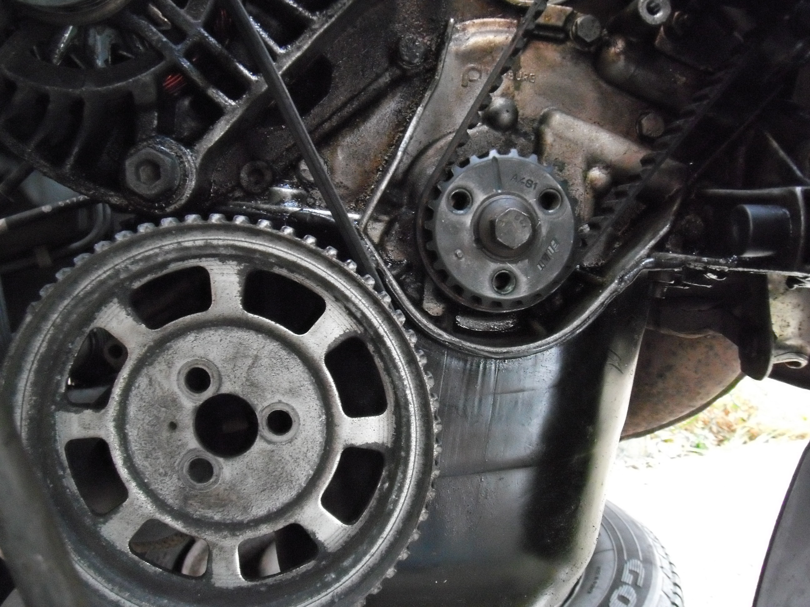

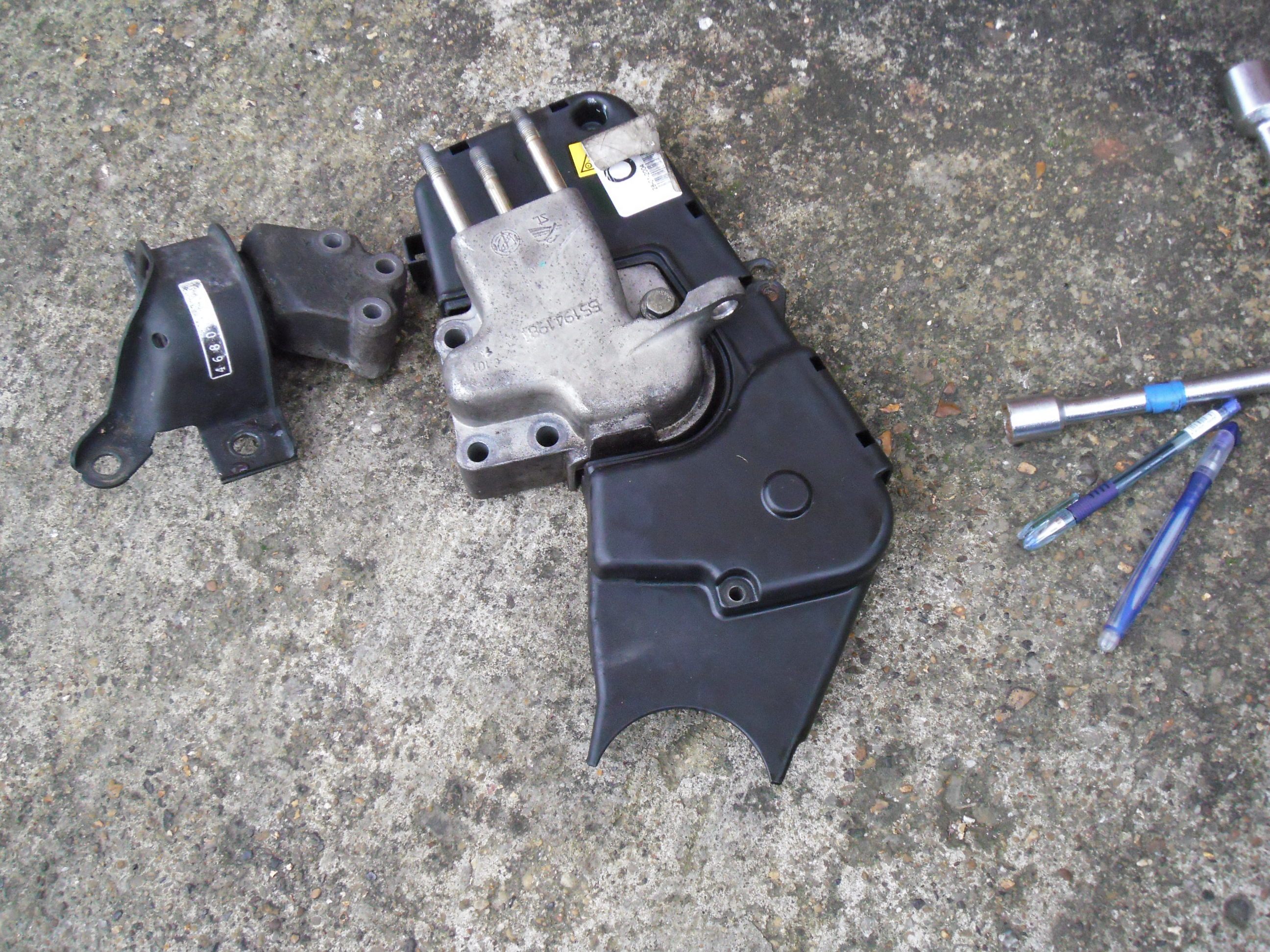

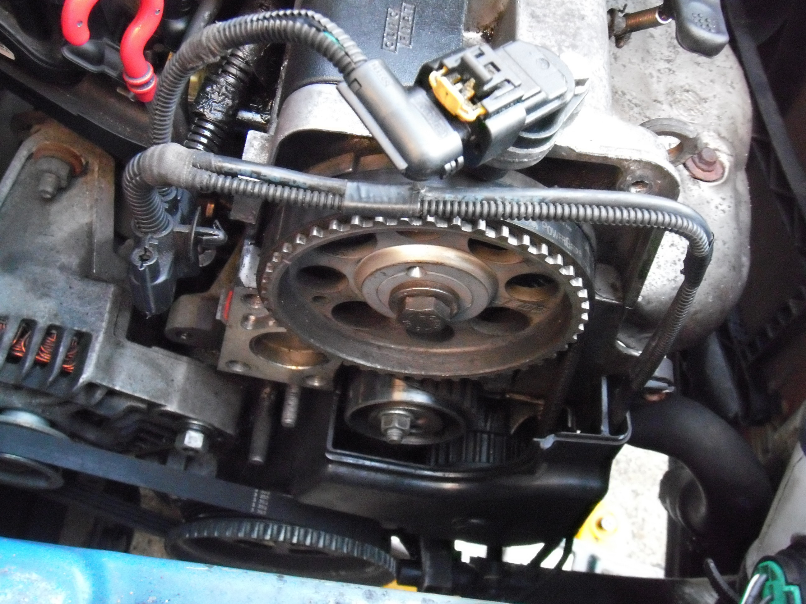

it'll run at a couple of teeth out.. But not 7 teeth out ;)
nice + easy to check..when the weathers o.k.,
here's a couple if pics;
