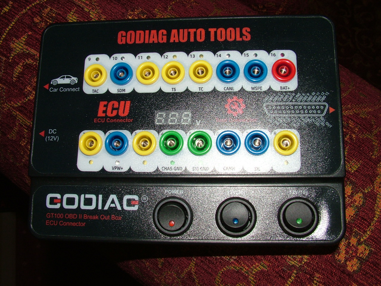

If you have the pin out details of the OBD port you can check power and earthing for ECU using a multimeter, I use a break out box for safety.;)

Can you read ECU power and earth via OBD port and leave ECU in place on that model?
I was able to do that via a break out box plugged into OBD port
