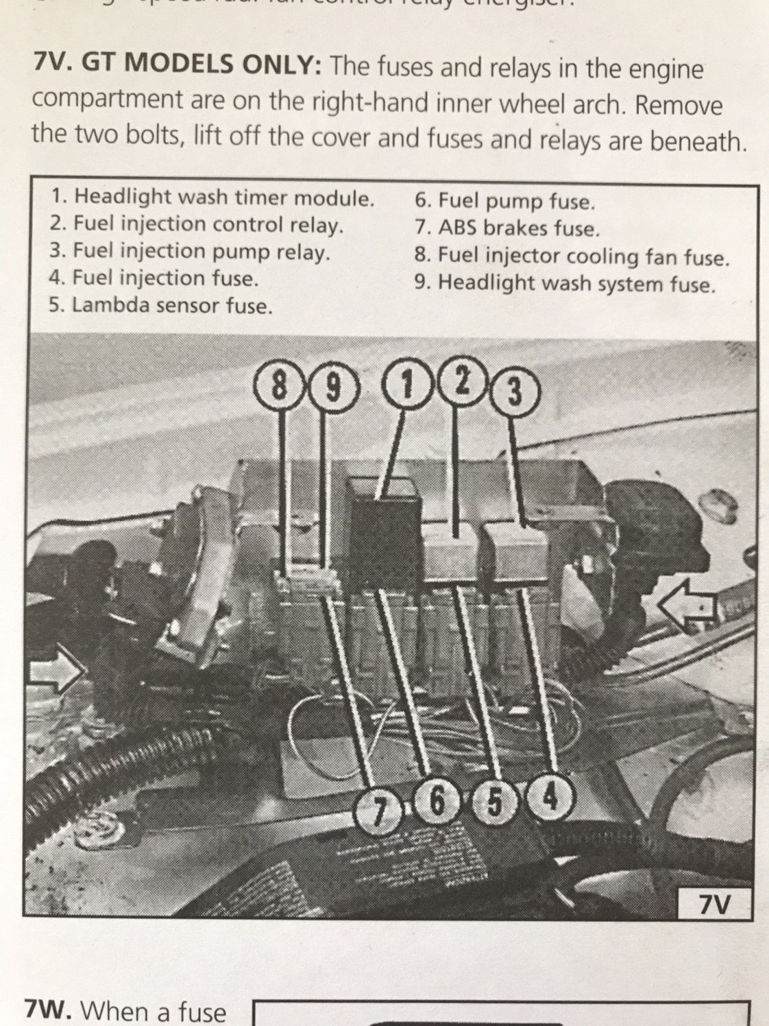

I cant seem to find a punto GT fuse diagram. The one on the car doesnt say where the fuel pump is. Checked the ones on the left side of the engine bay, but will recheck tomorow with more time.

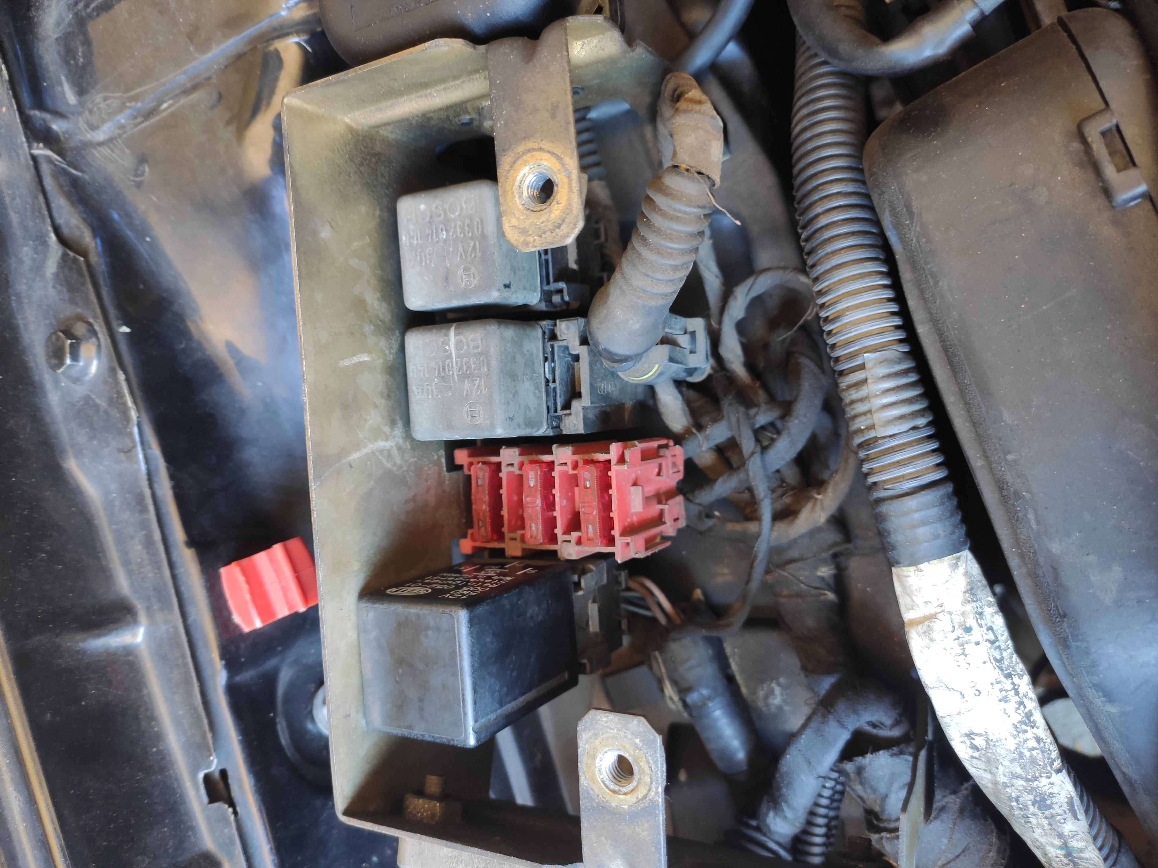

This photo shows the relays for the fuel pump under the cover . IMG_4826.JPG

Its the big black square right.
