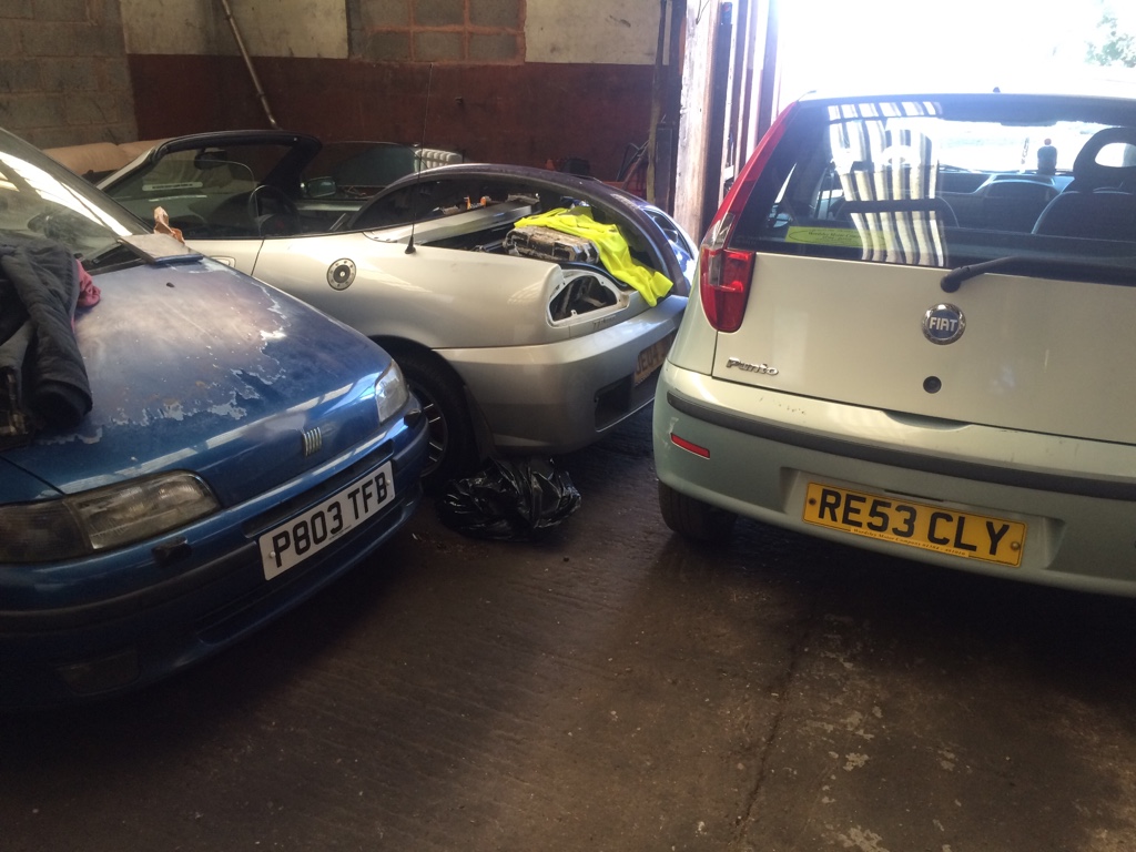

Thats the only pic I have, I know it doesn't help but maybe blue ones are different [emoji23]
