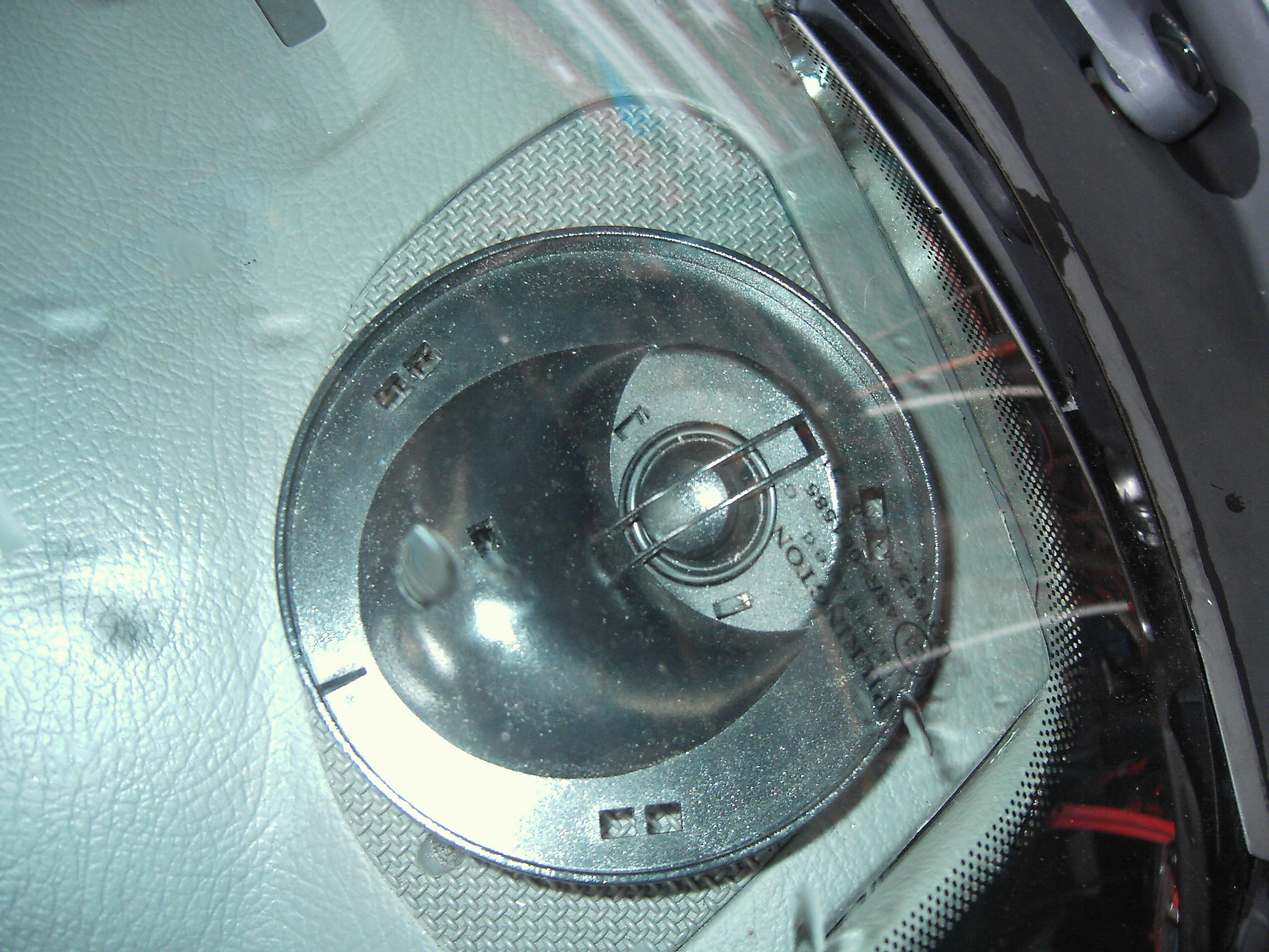

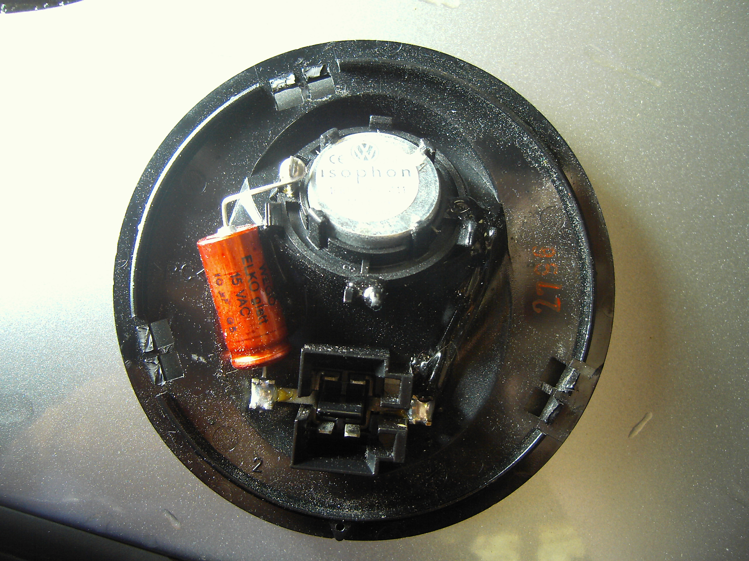

I fitted pure tweeters in the front speaker compartments, they're rated at 60watt RMS with a capacitor fitted as standard to filter out bass and avoid crackling and distortion, and seeing as they arent on show i didnt wana buy anything too fancy, but something very loud, I got myself a set of mk4 VW polo tweeters (Audi's use the same) and they are SOOOOO loud, louder than much else ive heard and i fit a hell of alot of tweeters/speakers/subs (basically ice), they only needed minor shaving down and they sit in sideways partly under the hole where the wires cum through and they really are purely excellent quality, no distortion as far as i dare turn them up, they are around 3/4 of an inch deep too so no clearance issues there either, superb modification IMO (y)

Ohh they sound nice, though do they have to sit ontop of the punto speaker grill...or does the 'shaving' involved mean that they sit below the grill? The picture looks like they sit ontop of the original grill. :eek:
