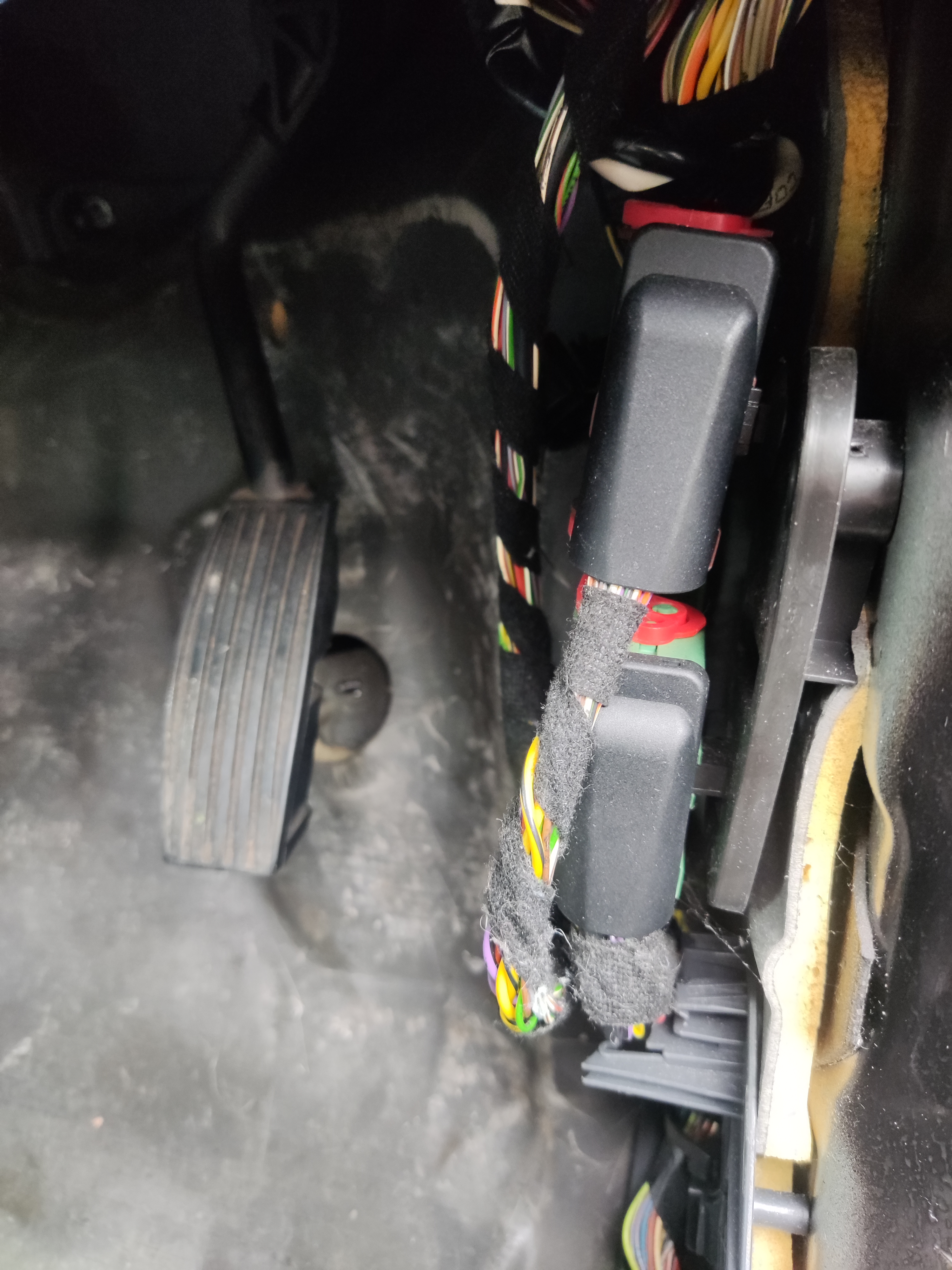

Yesterday I took the carpet away a bit and put my hand under the pedals, that area was very wet,the sponge . I'm guessing the water is getting in somewhere there. There's some holes there( behind the acceleration pedal) I could feel with my hand, it s hard to see because of the isolation carpet, no grommets, no ideea if that's how it s supposed to be or is something missing.

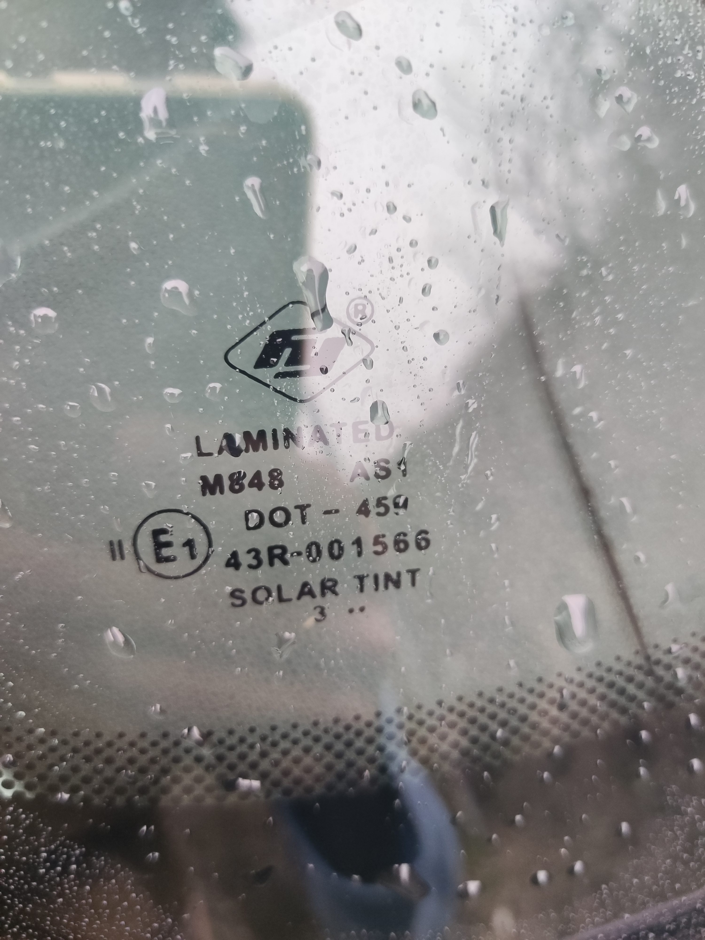

Hi guys. I took some pictures. Drain it's clear, coolant seems low, I don't know if the windshield it's the original one. Idk if this is a clue or not but the windshield on the inside is getting watery very badly, even when it s dry outside. And that photo with the plastic thing under the carpet, not even sure what's that, but seems wet all the time.

Area behind acceleration pedal is wet, that's where water is getting in.

Sometimes if leaking at the top of hinge end the water can run down the seal and then over the inside of the carpet near the accelerator pedal and ECU area in your case which is not a good idea!!!

I dont think your screen is original.. but it often costs a fair bit to get it changed.. so worth a try with the weatherstrip.
