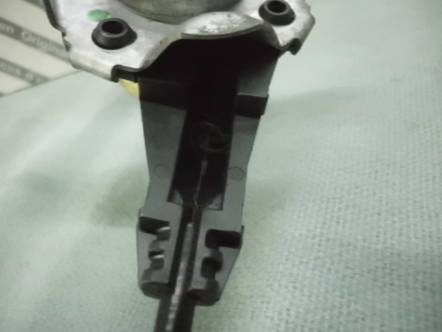

This must be a common fault on the Punto Evo due to poor design, failure of the rear manual windows to wind up and down, the cure is to replace the rear door window regulator, the cable goes rusty and snaps, if you look at the assembly it stands vertical inside the door and water runs down into winder cable sheathing, with nowhere to run out it just sits there until the cable rusts away, time taken to fit the new one just under 1 hour including looking for tools put down that seem to dissapear on there own !!
I have now done both sides on my wifes evo, where my finger points fill this up with 3 in one oil before fitting .
