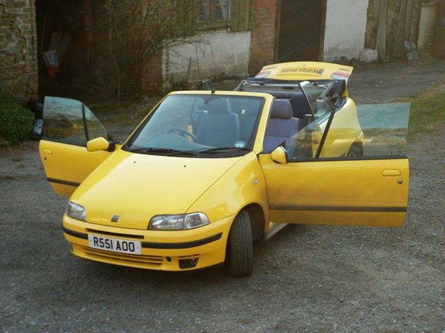

Yours looks more obstructive than mine (attached) - it's not good - use mirrors, like a truck! The pin I think is where the tonneau cover poppers on - but who uses that? The straps should have a matching strap end to buckle to - used for adjusting tension. When the hood is up you can get your hand in there to see if it's tight or what, then lower, adjust, try again. I found they were preventing the hood from meeting the screen top easily - I let out nearly all the tension. BTW, you know to let all 4 windows down a crack when closing the hood? makes locating/locking much easier.
