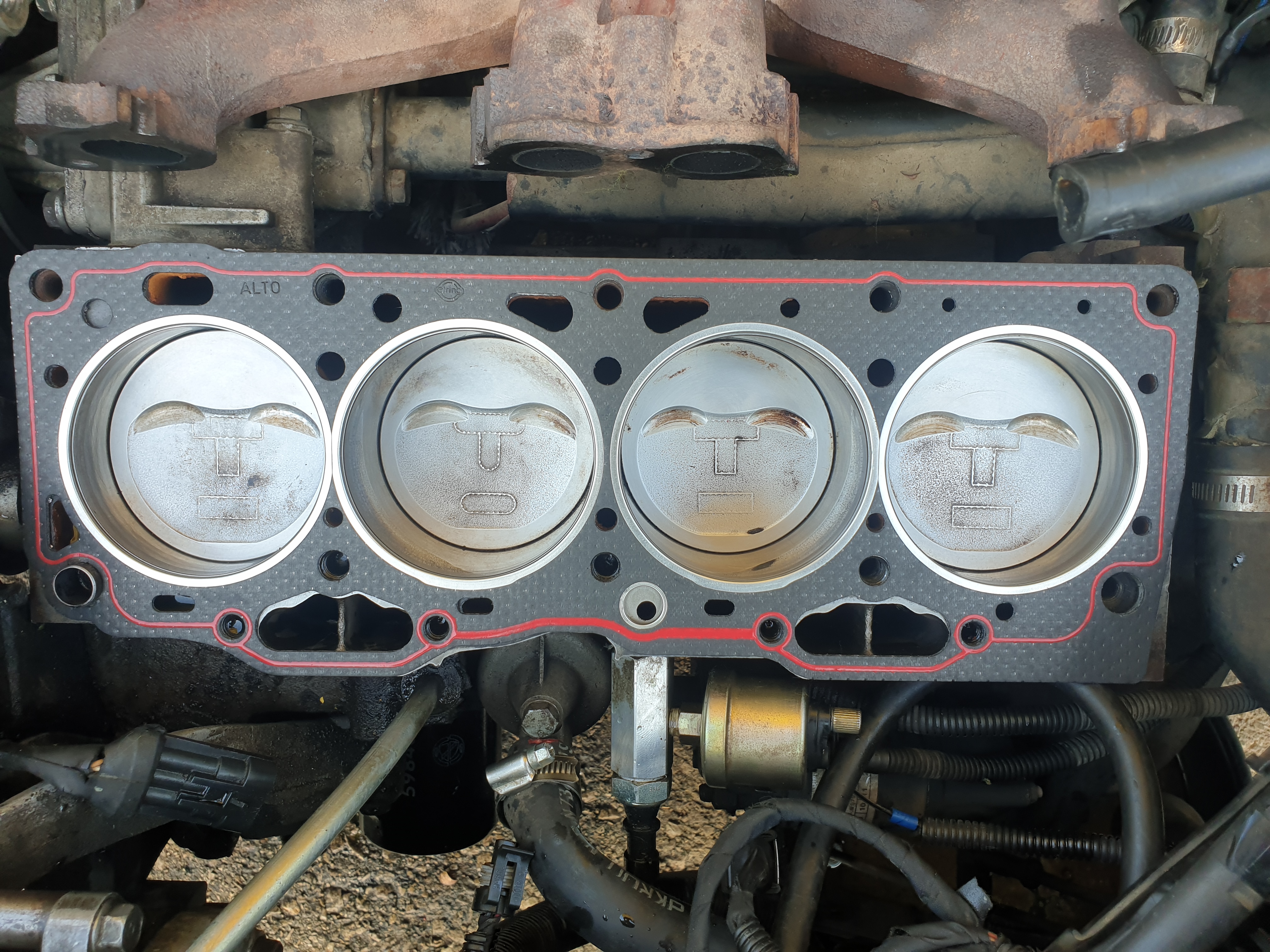

Renewed my head gasket + 4 valves after timing belt snapped off.

I've done a test with crank sensor out,
filled the radiator with water, and cranked the engine.
I can see water is going in and not jumping out. does that say the HG is fine?

On the 1.1/1.2, the head gasket is coated with a sealant. The gasket is supplied in a sealed bag, and should only be opened just before fitting, fitted immediately, and the head placed on and torqued down. If the gasket is left out in the air for long, the sealant starts to harden, and will not seal as designed. It is likely that the 1.6 uses the same sealant. If you have taken the gasket out of its sealed packet some time before fitting it, it may not seal properly, and you'll need to do it again.
Head gasket is coated with sealant and was closed with sealed bag before I took it out.
I've installed it immediately.
