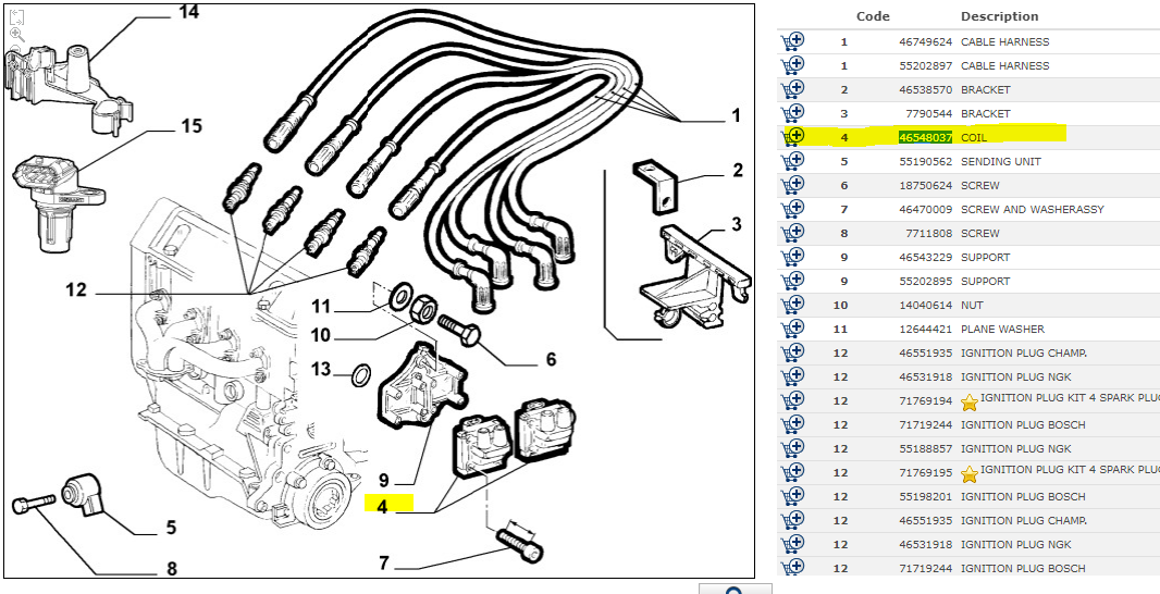

If you find it to be one of the coil packs, I would replace both as they will be of a similar age. Make sure you use a high quality replacement part. I would recommend this BOSH part (you will need 2). They're £15. Delphi also make decent parts (part number CE20058-12B1). The original FIAT part number for the coils on your engine is: 46548037. They are identical. See the picture I have attached for reference (ignition.PNG).
EDIT: I re-read your original post and it seems you have done this. I will leave this information in case someone stumbles across it via Google. I guess the ECU would be the next logical guess but for £30 maybe just swapping both coil packs is worth a go first. The fact that your bulb is lighting up on the negative shows that a trigger is coming through from the ECU. Check out Ziggy's response in this thread here to a very similar issue. He seems to agree with me on the coil pack replacement theory.
