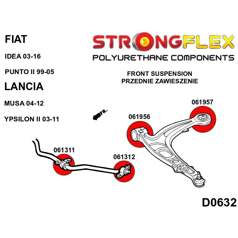

I'm about to order PU bushings to shape up the rear arms, and while at it I may order for the front as well. Which of them are most prone to get worn out, x56 or x57?

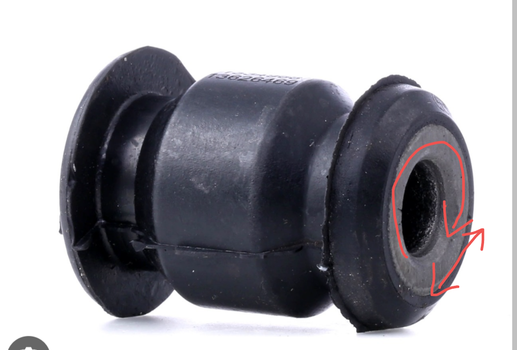

You probably know already but in PU bushings, the PU itself is not moving. The steel sleeve is rotating freely and the PU is not twisted as in a rubber bushing where everything is vulcanized together.

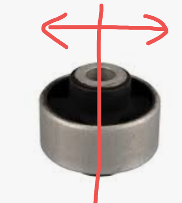

57 operates in the vertical plane
Even 56 which is mainly rotational has some horizontal movement
If you stop this the energy moves to the steering rack components
Stiffer bushes are fine on a race car running on very flat race track
On a race car it's all about performance, and replacing things as they wear
For a road car noise, wear and so on became an issue
