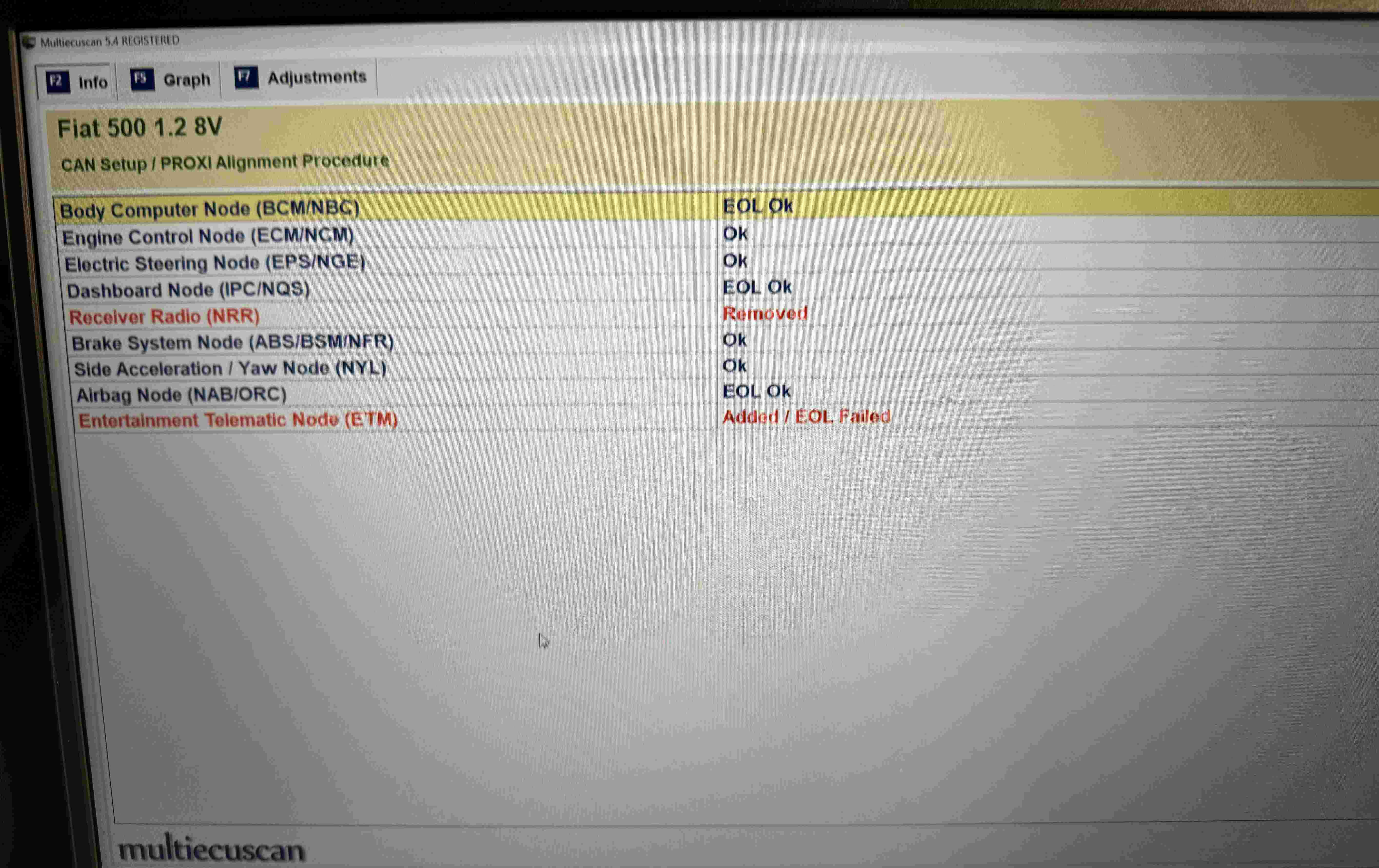

Upon further investigation with MES and trying a Proxi alignment, I found these errors.

The Radio Receiver (NRR) is showing as removed
So I started to look for the ETM, which I think is the Blue & Me ecu. After removing the rear seat and the left hand rear speaker panel, I found nothing.
After some more searching, the 5 inch Uconnect radio, which the car comes fitted with, does not have a Blue & Me ecu. Is this installed in the 5 inch Uconnect radio?
So I unplugged the radio completely and did another Proxi scan, this is the result.
As you can see, the Entertainment Telematics Node has vanished, also the Receiver Radio is still showing as Removed.
If I re-fit the radio, the Entertainment Telematics Node returns with Added / EOL Failed, but the Radio is still showing as removed. Why would this be?

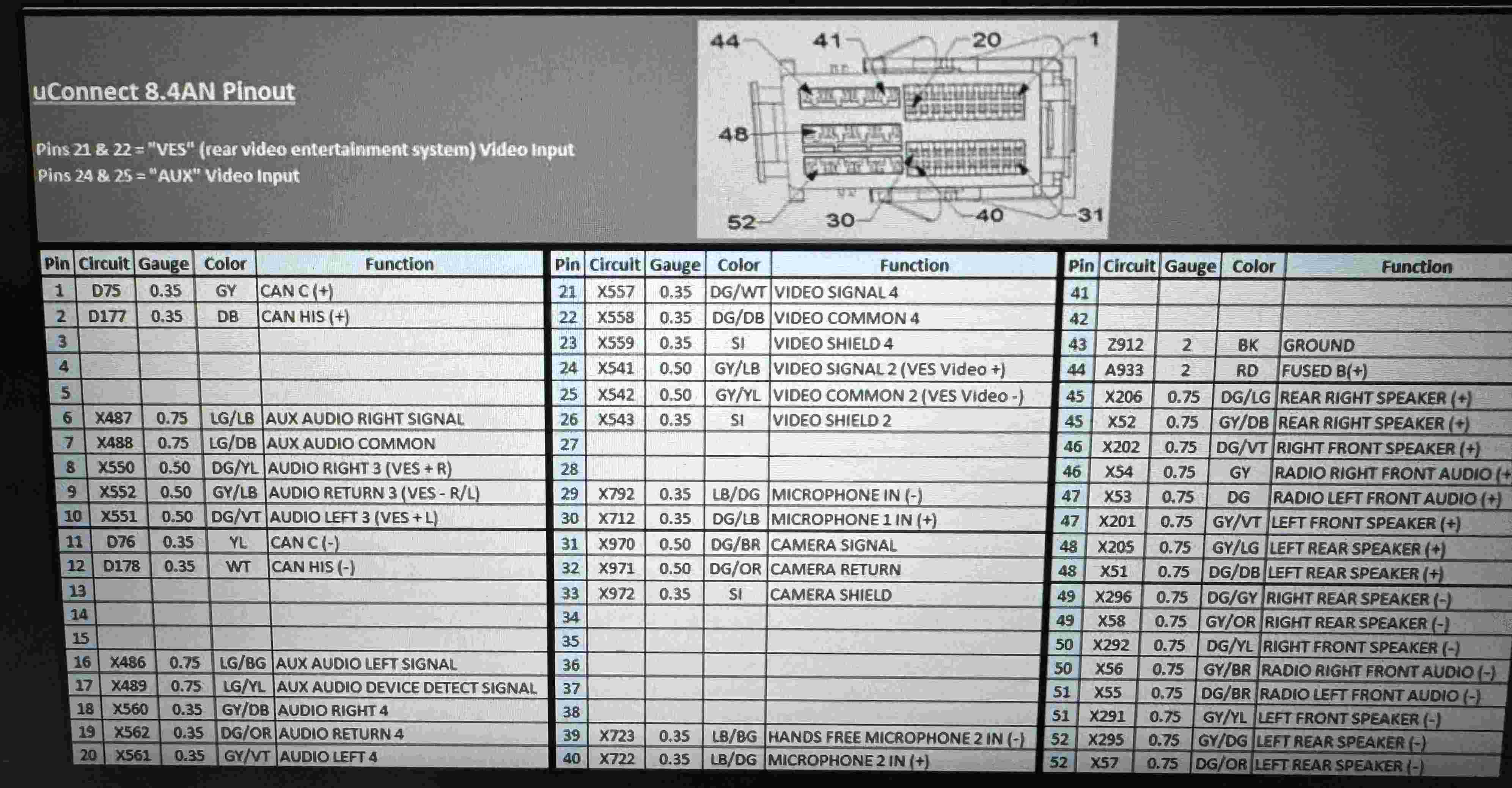

Looking further at a pin out diagram see below,
I can see the Can wires + on pins 1 & 2, also on pins 11 & 12.
Could I link these together, e.g. pins 1 to 11 and pins 2 to 12, or does the can system not work like that?
Just trying to get to the bottom of the errors in Proxi alignment.

I know the radio works, but why does it not show up in the Proxi scan. There is no change if the radio is connected or removed, apart from the Entertainment Telematic Node (ETM), which disappears when the radio is unplugged.
Something tells me the ETM is built into the radio rather than a separate Blue & Me unit. Nothing gives a clue to this in the pin out diagram that I have.
