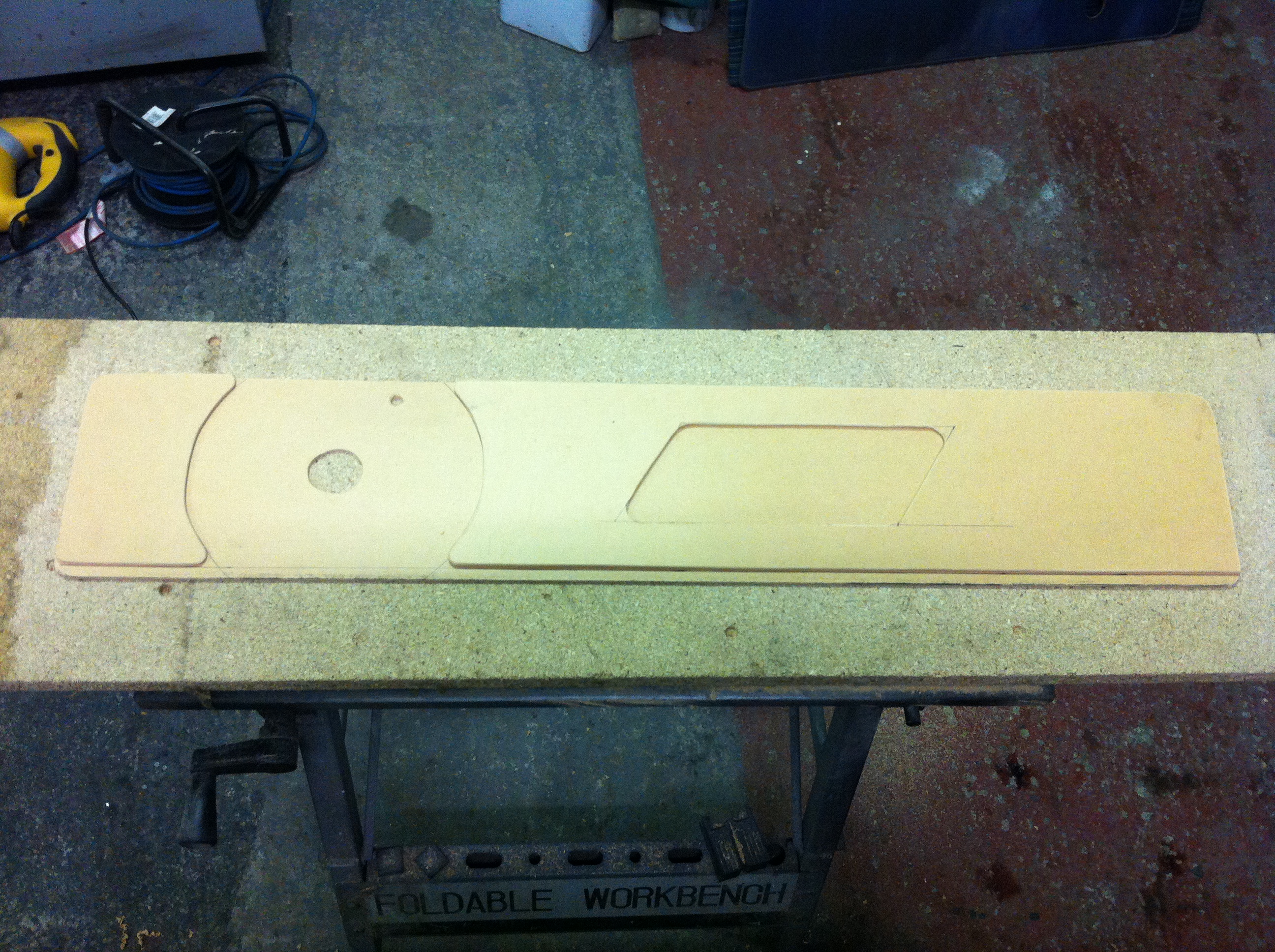

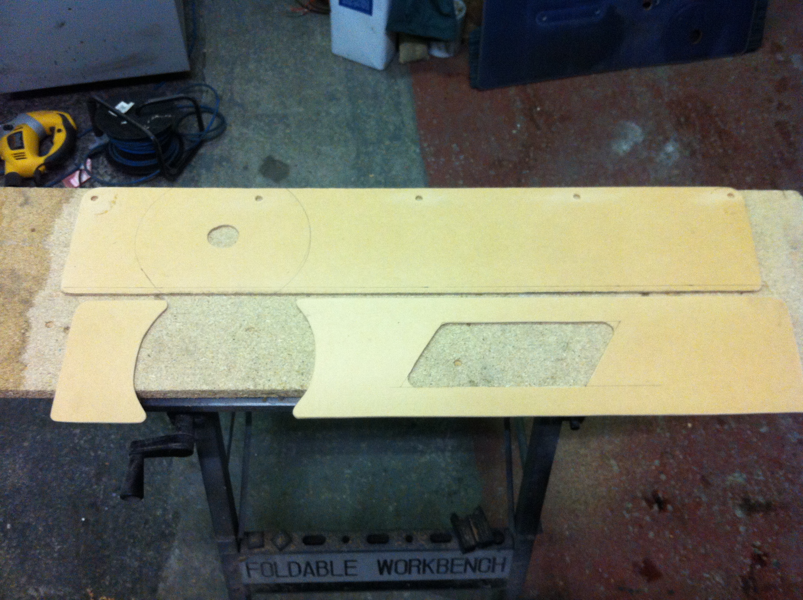

This is the bones of the front door panels, just need to cover them when I return.

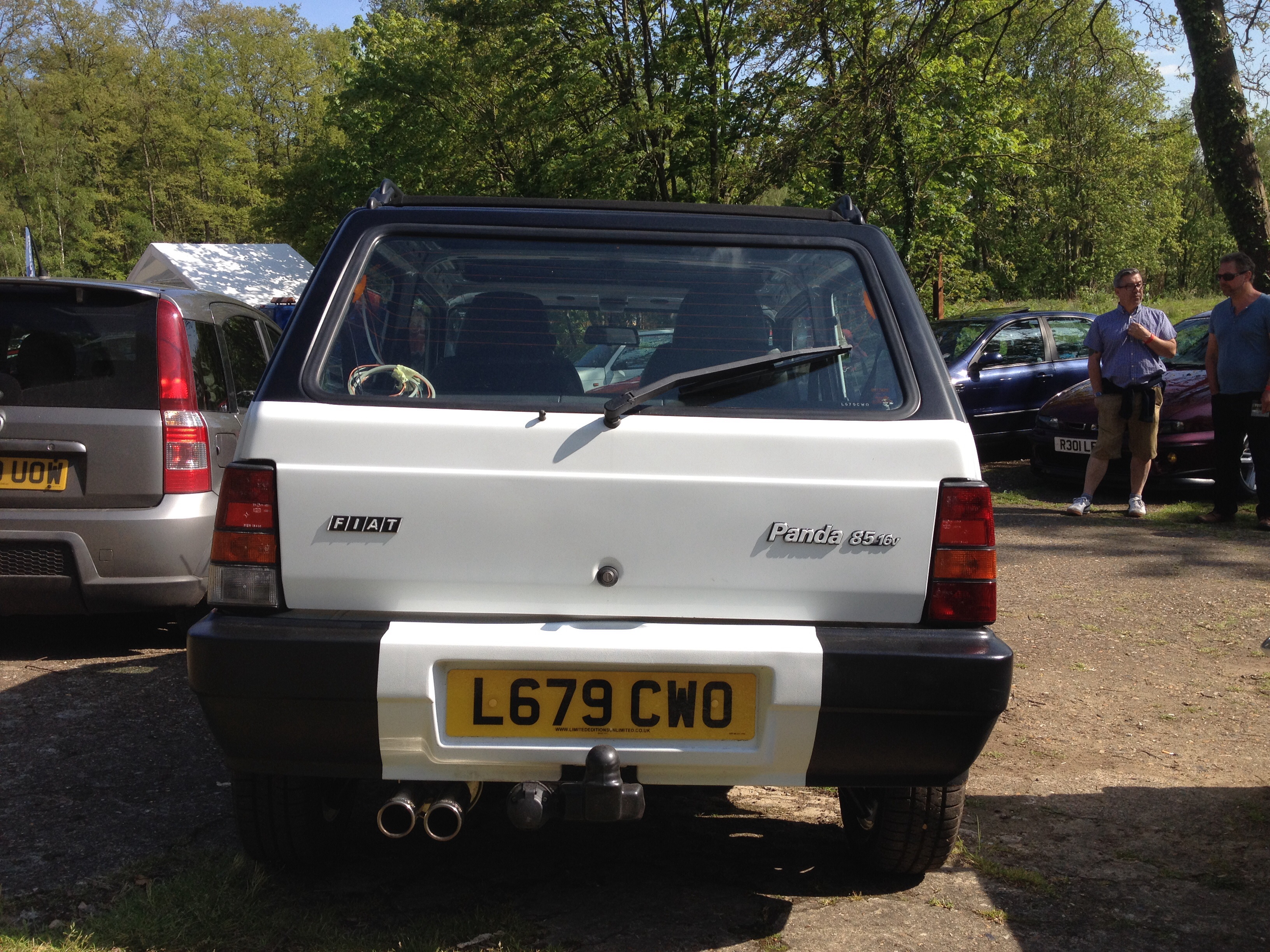

Badges for the tailgate have also been painted, chrome bulbs fitted in place of orange inserts in front indicators.

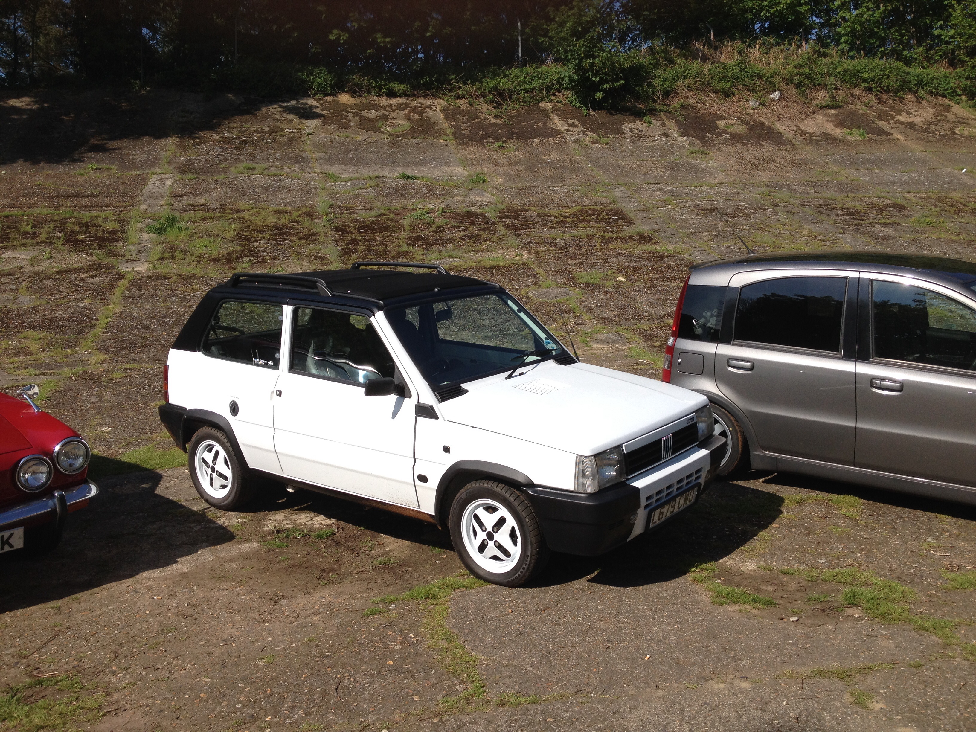

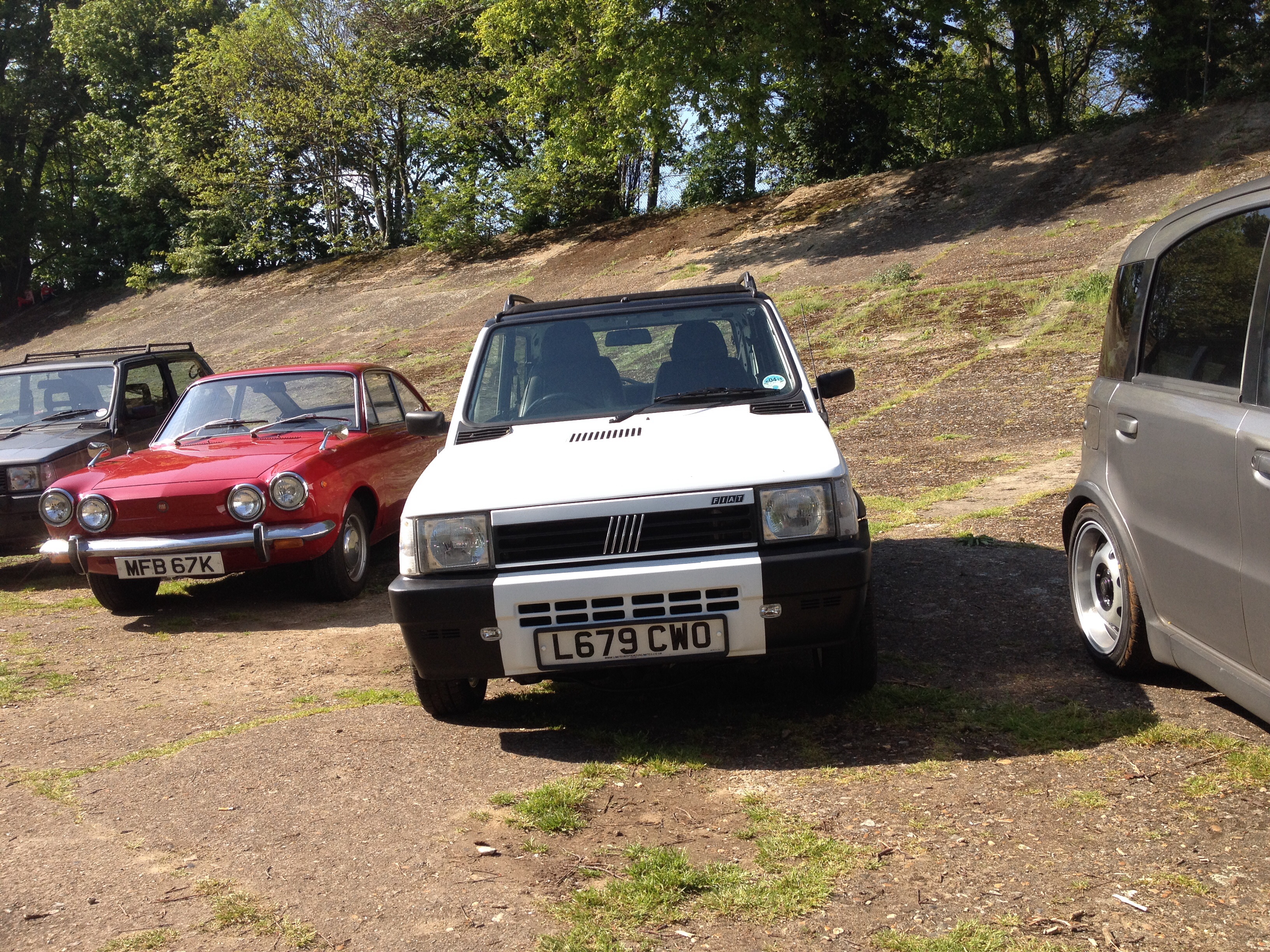

Ok I know you want to know - put it this way, I always said it was the best engine for the Panda. (y)

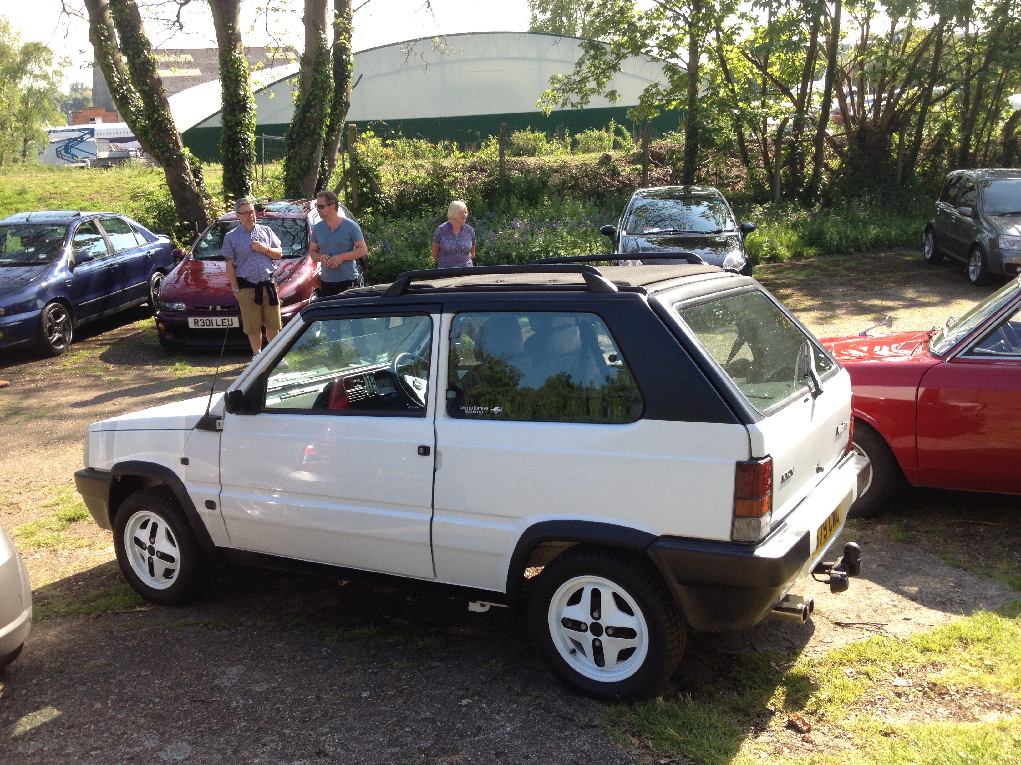

There haven't been any oddities all the way home with the engine running just as it should do - it just feels like a modernised Panda & was clearly very much at home on the motorways. Quite a lot of noise on the motorway but not in a bad way & it quietens down nicely if you take it gently (er legally....). It pulls very well from motorway speeds - a long drag uphill towards the HW junction of the M40 proved this very nicely when I got baulked & Panto accelerated at a point where a lot of cars struggle (Bob will know this incline & will probably appreciate that halfway up it, accelerating in 5th by 20mph easily is good!).
Not had chance to try the handling but it feels well set up & inspires confidence so far. All the important bits seem to be working well. (y)
Thought I'd better try accelerating properly, hence my little extra run tonight. :eek: I'll repeat that in capitals :eek: :eek: It does, and reminds me very much of an almost undrivable modified Cinq I had years ago - except without the undrivable bit. This needs a bit more exploring, but it feels like overtaking will be fairly simple should the need to pass a Honda Jazz (or 50, they're everywhere here!) arise. :devil:

:) There are a few rattles at the moment from trim etc which should improve things once they are gone. Unfortunately wind noise from the twin sunnies comes as standard and there's not alot we can do about that. The engine sounds nice, slightly louder than a standard Panda but I don't think you'll tire of it. Induction noise may reduce once the air filter system is completed though.
Yep I like the way it feels too. Firm but still comfortable suspension, steering is nice and light if a little low geared. It's a very pleasant drive when driven sensibly, better than my blue clx which has the same springs and dampers.

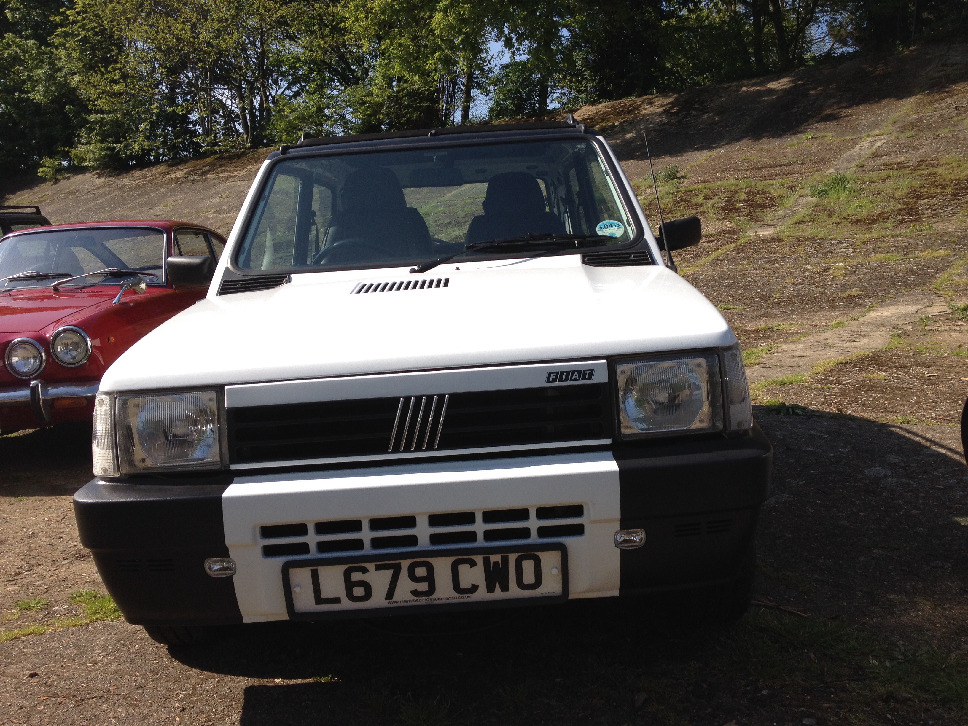

Aside from some gear linkage problems (with 3rd, 4th & especially 5th) which Vernon knows about, mechanically Panto is going like a small black & white rocket.
I'm pleased to report that the steering, handling & brakes seem very good - actually the steering feels much better than I expected Vernon!
