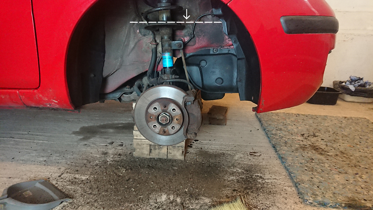

Coincidentally, shortly after giving up on decoking the inlet manifold and sorting the EGR in-situ (after I'd dropped the coolant :rolleyes:), I noticed the front struts were in different positions in the top mounts. Driver's side offset to the rear and passenger side offset to the front. A bit of research on FF revealed the passenger side top mount had been fitted 180 degrees out! So I pulled the strut off on Monday and refitted it with the mount in correct orientation.
The knock has now vanished. I still don't know exactly what was fouling but it's gone so I'll take the victory. :)

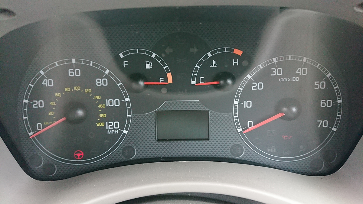

Also noticed this little anomoly. Seems to be some residual voltage finding it's way to the PAS dash light and the oil pressure dash light. Both are dimly illuminated all the time, even with the ignition off. I'll likely start another thread on this if this weekend's probing finds nothing obvious.
the lights are not switched on and off directly
there controlled via a digital signal on the canbus.
probably the best start would be to reseat the dash connector
and then the body computer connector
while there look for signs of water entering the footwell behind the body computer.
Two points here.
The 'dash failures' Ive seen are ONLY visible at night.. they are that feint ;)
They are piggybacking on a certain circuit operating.. lights(punto)..indicators(500)
Your Dash should be DEAD.. if I read this correctly
ECU Testing https://www.ecutesting.com says that dash lights staying on is known fault.
It might be cheaper to get another dash and have it reset (virginised). You Tube has a few videos but all seem to need special equipment.
Thanks again for the tip, Dave. Some research to be done on my part. Fortunately, I've been chatting to another forum member who's breaking an Panda MJ so at least getting another cluster may be possible.

The PAS light looks much brighter in the photo than with my own eyes. Both lights are very faint although are still visible in the daylight. I have a decent (Delphi) scanner and have tested all the dash lights that it's able to access and all seem to work fine. The instrument cluster itself appears to work perfectly. I'll try koalar's suggestion and reseat the dash connectors and body ECU connector and take it from there.
