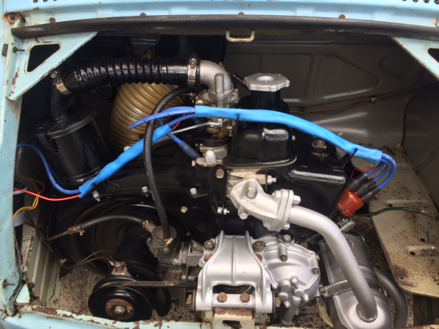

AT LAST.
On the road properly.
Parts arrived from Passione, and it was straight to work. The manifold and some gaskets had to be fitted to the exhaust that Chris Bambino sent my way. I can't express how grateful I am for this, the exhaust fits beautifully and she actually purrs!
Fitting the exhaust brackets is a total nightmare though. The new brackets, when aligned with the old ones, are ever so slightly smaller, enough to make fitting them a real pain in the... I had to bend them slightly as they're round and the exhaust is slightly oval shaped. Then I had to grab some large locking pliers to bring the ends together and put the bolts in. Sounds easy but the whole process took several hours.
Anyway, success! I'd tidied up the engine bay a bit while awaiting the parts and it looks a lot better now. Got some heatshrink wrap as sleeves to insulate the leads, as they were at risk of falling against some hot spots and melting. If I can find some proper grommets for the metal lead holders, then the wrap probably won't be necessary.

AT LAST.

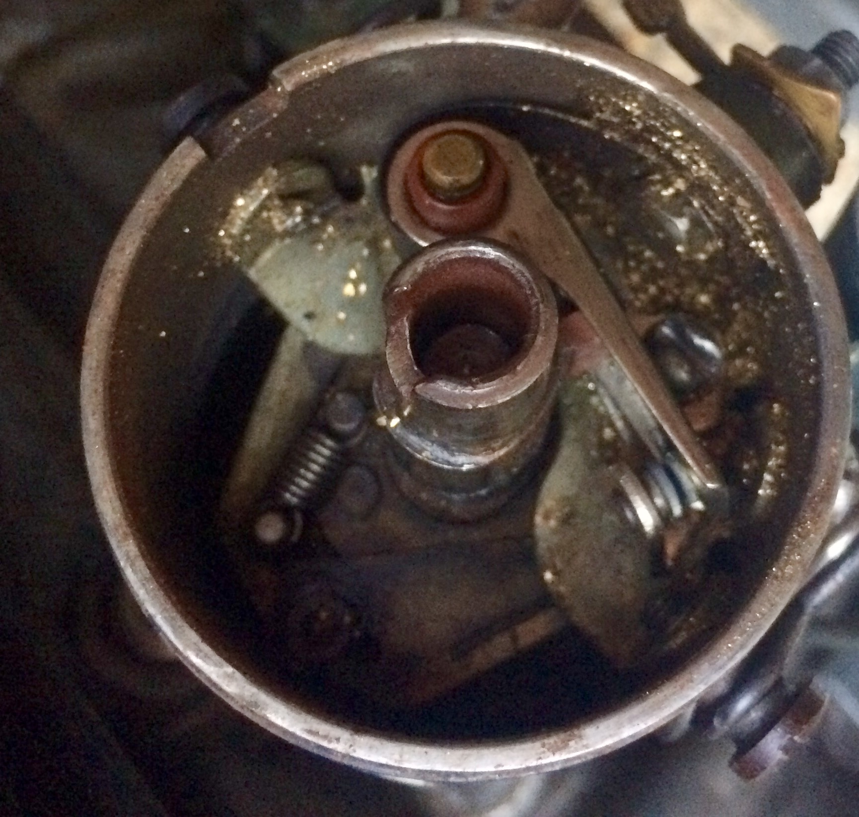

Well I guess this could explain the poor running the other day.
Opened it up and the cap must have been on a fraction squiff, and one of the contacts in the cap was slightly shaved off! Learn something new everyday.
This has me pondering the 123 ignition or similar. I love originality but also want to just be driving it loads.
Pros and cons of each, almost seems worth just giving it a go almost out of curiosity.

I gave it a go for the same reason...an expensive experiment. The thing is that the weakness of the distributor cap and arm are still present, so the same mistake can be made. In theory the spindle and bearings of the 123, although very well made, can eventually wear in the same way as the original. It only eliminates the points and the advance mechanism, so is not true EI in the modern sense.
When you feel up to it, yours could do with a thorough cleaning for now, maybe with a partial stripdown and some new points.
Ah interesting, so not a foolproof option. Did your experiment end in a return to the old fashioned setup?
I've given it a good clean and it runs nicely now. Adjusted the points gap to 0.4mm based on neighbour's recommendation (or is 0.5 better?) using a feeler gauge.
I'll investigate a stripdown guide, but maybe while it's working should leave well enough alone!
It was pointed out that I need to make sure there's enough oil in the little distributor too. Looks ok but great to learn another little tip!
I've given it a good clean and it runs nicely now. Adjusted the points gap to 0.4mm based on neighbour's recommendation (or is 0.5 better?) !
When I replaced the engine I didn't re-use the 123. Many people argue that it makes for good performance and reliability but I have had several thousands of miles of the same using an original distributor and the old contact-breakers it was delivered with.
The median measurement given for the points is 0.5mm and the lower parameter is 0.47, so 0.4 is a bit narrow. You're actually meant to check the spark timing when the points are adjusted but I would read up on the principles of that before adjusting anything.
The later 500's also have an oiler which is not so obvious. There is a spring-loaded ball-bearing slightly anti-clockwise from the LT connection, which is depressed by the tip of the oil can so you can let oil in I can't see one on the 126 engine.
Done! 0.5mm spacing and she really runs nicely.
