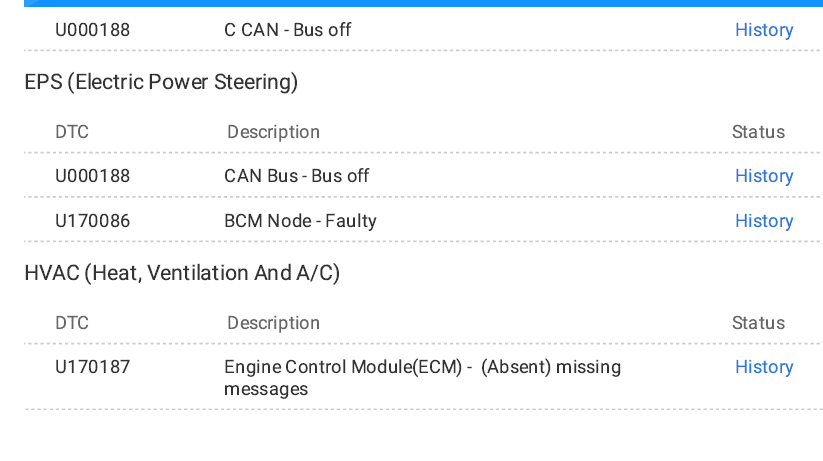

Having issues recently with Fiat 500 MHEV 2020. Lots of error codes. Garage diagnosed loose connection and new aux Battery. Passed MOT and had minor service recently. Now error codes have re-appeared. Used an OBD2 Scanner and lots of issues. Help!

Unlikely that so many issues have occurred at once. This is more likely to be a single connection, disrupting communication all along a line.
The body computer, behind the OBD connector needs checking for secure connections. Also check for any dampness.
Under the windscreen, there's a chamber wher the wiper motor sits. That catches rainwater, which should drain out, through two rubber 'duckbills'. Those duckbills can block, especially with dead rotting leaves. The chamber fills with water, and overflows into the car, often onto the body computer.
Although the battery has been replaced, check the connections are secure. Also check the earth cable from battery to body and engine. At 5 years old, this should still be good, but they do corrode internally, making a high resistance, causing a multitude of electrical issues. Squeeze and flex the cable along its length. It should not feel crunchy.
Hi, thanks for the info so far. Just a little history with issues. Intermittent error issues for last 6 months appearing on dash. Unable to start 2 weeks ago with lots of error lights on dash. Garage picked up car and replaced aux battery and fixed loose connection. All good. Friday had mot and minor service - all OK. Yesterday, started playing up again with errors. Today, it wouldn't start. Same errors on dash. When I did get it to eventually start, error appeared after a minute or so with clicking noise from where aux battery is located under passenger seat. Just sat in it to try again, and it started straight away and drove round the block. Plugged in car pal obd scanner and came up with OL Fault B2 and u0431 error. Any ideas? Thanks

Don't know what fault B2 is, but u0431 is common with flat batteries.

U errors are CANBUS
The network connecting so much of the cars Electronics, and obviously Mild Hybrid has more than a traditional 500 or Panda

Historically.. Many errors are caused by a sensor being starved of power : through a poor battery.. Or a bad connection
