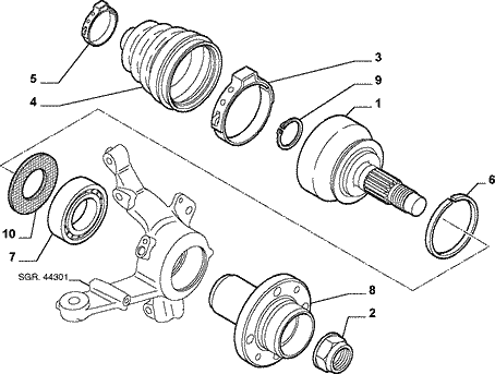

Hi All,
I've got no thread in one of my bolt holes in my front left wheel and I'm not sure if I need to get a whole hub axle or just a wheel hub?? Can anyone help please? I've been informed that it may be possible to get a wheel hub but the mechanic told me that he'd need to remove the wheel first to see if my wheel hub was bolted to the axle

You need a new one of these... item 8 in the diagram.
Or, when it's dismantled it might be possible to retap to a slightly larger thread, weld-fill and retap, or stick one of those insert thingy helicoils?

Thanks guys. I have wobbly bolts so I reckon I might have a bit of a problem finding one that'll fit a slightly larger hole.
I've found a replacement wheel hub on Ebay for £25.

If you have a friendly mechanic and/or decent workshop, you could convert that wheel to studs. Drill out the threads and insert headed studs (no risk of pull through, just needs a dab of mig weld to hold it). A set of studs is £3 delivered (ebay 300296575548), but you'd need nuts to match the thread so call it £5-6 for parts.
If the threads have gone, your only safe option is a new hub, or a helicoil. Helicoiling is cheaper, and takes less time. Most decent garages will have the ability to do it or have a contact. You'd be surprised how many sumps, and spark plug wells are helicoiled without the cars owner being informed!

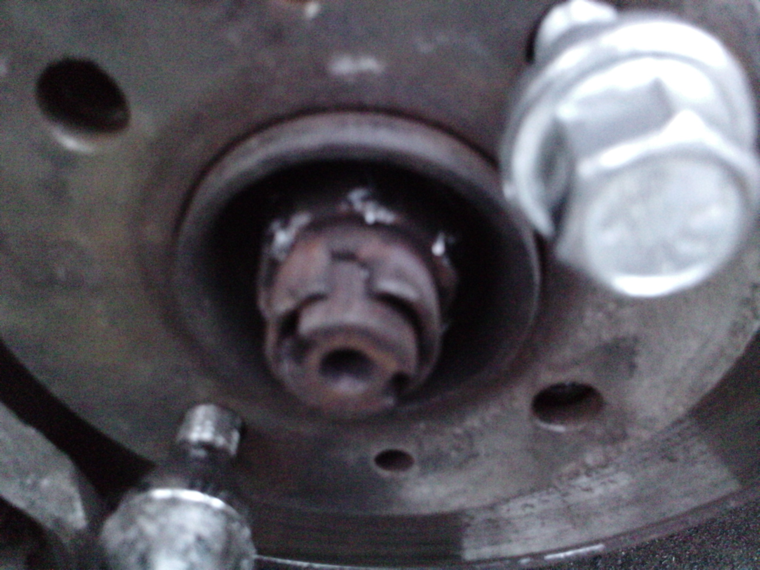

EDIT: After closer inspection of the nut he's informed me that it has been over tightened. There are two metal flaps on the nut that should sit over two grooves in the peg. Once they're sitting over the grooves nicely they should be tapped/ bent into the grooves to lock the nut inplace and secure the hub. Some idiot's over tightened it and the flaps have gone half way around the bloody peg.
thats pretty seriously tight then.....is it the actual bar thats breaking??? ive got a breakers bar, cheapo one off the bay, tried to undo a nut, with a half meter scaffold pole on the end jumpped on the bugger, (im 14stone, so not light) and it wouldnt budge, breakers bar still intackt....when ive taken hub nuts off before, the flaps that have been bent in just giveway and bend back again, destroying the hubnut...try bending the flaps up...also to my knowledge the nuts dont have "flaps" its is a complete circle and once its at the correct torque, your meant to bang the nut into the recesses with a chisel/screwdriver, creating the flaps...so the fact that the flaps dont line up with the grooves either means youve tightened it :O or someone previous to you has re-used the old hubnut (BIG no no.....) and yes its anti-clockwise to loosen.....
take a picture and input will be thick and fast :)
somehthing tells me your doing it wrong....all the hub nuts ive taken off ive NEVER managed to damage one, you need ot make sure ure using a hexagonal socket not one of those splined ones, as the splined one will REALLY mess it up, needs to be 1/2" drive breakers bar or bigger with no adaptors give it a tug and off it comes, no way your gonna snap a 1/2"
take a pic of the tools ure using if it still wont budge....

It was anti-clockwise after all.:rolleyes: Got it off in the end with a bar that was about a metre long. The end of it was slightly bigger than a snooker ball but at least it didn't break. My dad said he's never ever broken any tools removing a hub and cannot believe someone had screwed it on so tight.
