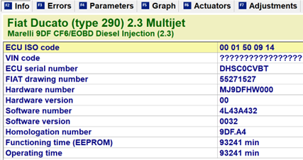

Can you do a screenshot of the info page F2

Dear T, please find below first the general information of my camper Ducato, from F2:

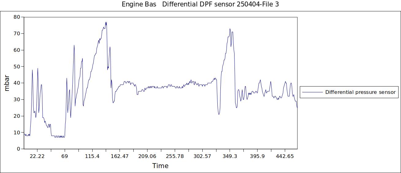

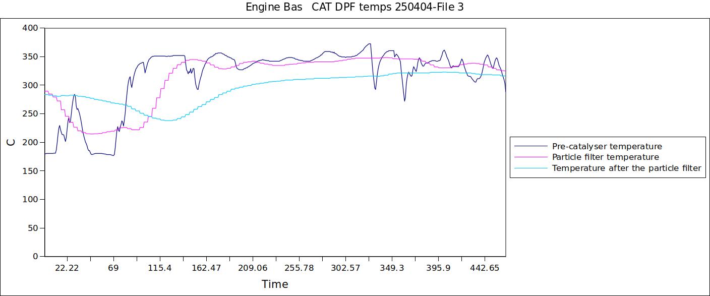

here are some graphs i will explain each some only confirm what I all ready suspect.
Injectors pass Fiat spec
The last 2 could be totally acceptable

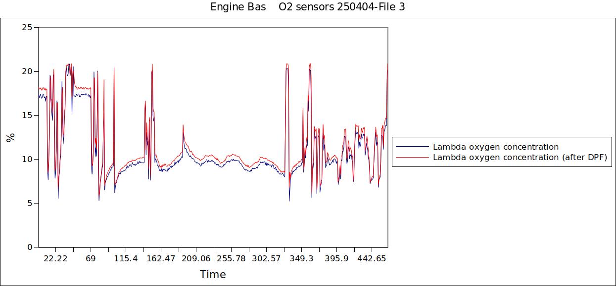

Should I worry about this value of increase ? I am asking this because on Tuesday I have to bring the camper to the dealer which is about 80 km up north.
I would be concerned about continual running the engine without regeneration taking place. Take it there and be prepared to leave it there
