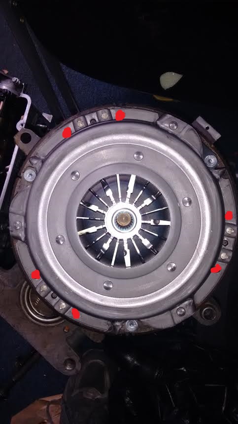

My Uno came without the bolts needed to secure the clutch pressure plate. (see pic). Does anyone know what kind/type/measurements I'll need and where to get them from?
I'm asking in the Punto section as mine is a 180mm with a C514 box I believe is similar or the same as on the Punto's?
If anyone could point me in the right direction I would be very grateful.
Thanks.
don't actually know the answer to that one but seicento has teh c514 box too and the tech manual is in the downloads section.. If you download that, then navigate to volume 1. Then click 'Info & data' at the top, then select 'operation info' on the left - in there is a massive list of bolts and nuts with sizes and torque specs - might find the answer in there.
Thanks.
I downloaded the manual as you suggested and the bolt listed is an M6.
