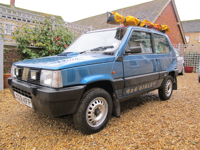

Hi Albert,
Did you make the journey? how did the Panda perform? I've only just come across your post and would have added, change/check or remove the thermostat.
I drove my Panda to Les Gets in France for a ski week and then across to Limoges and finally to Calais, on the last leg the head gasket went! after being pushed onto the ferry and left for a couple of hours it started and we made it home. I've still not got around to doing the repair which was more than 10 years ago and the Panda remains in my garage on 22,000 miles.
It's a job I must get on with!
