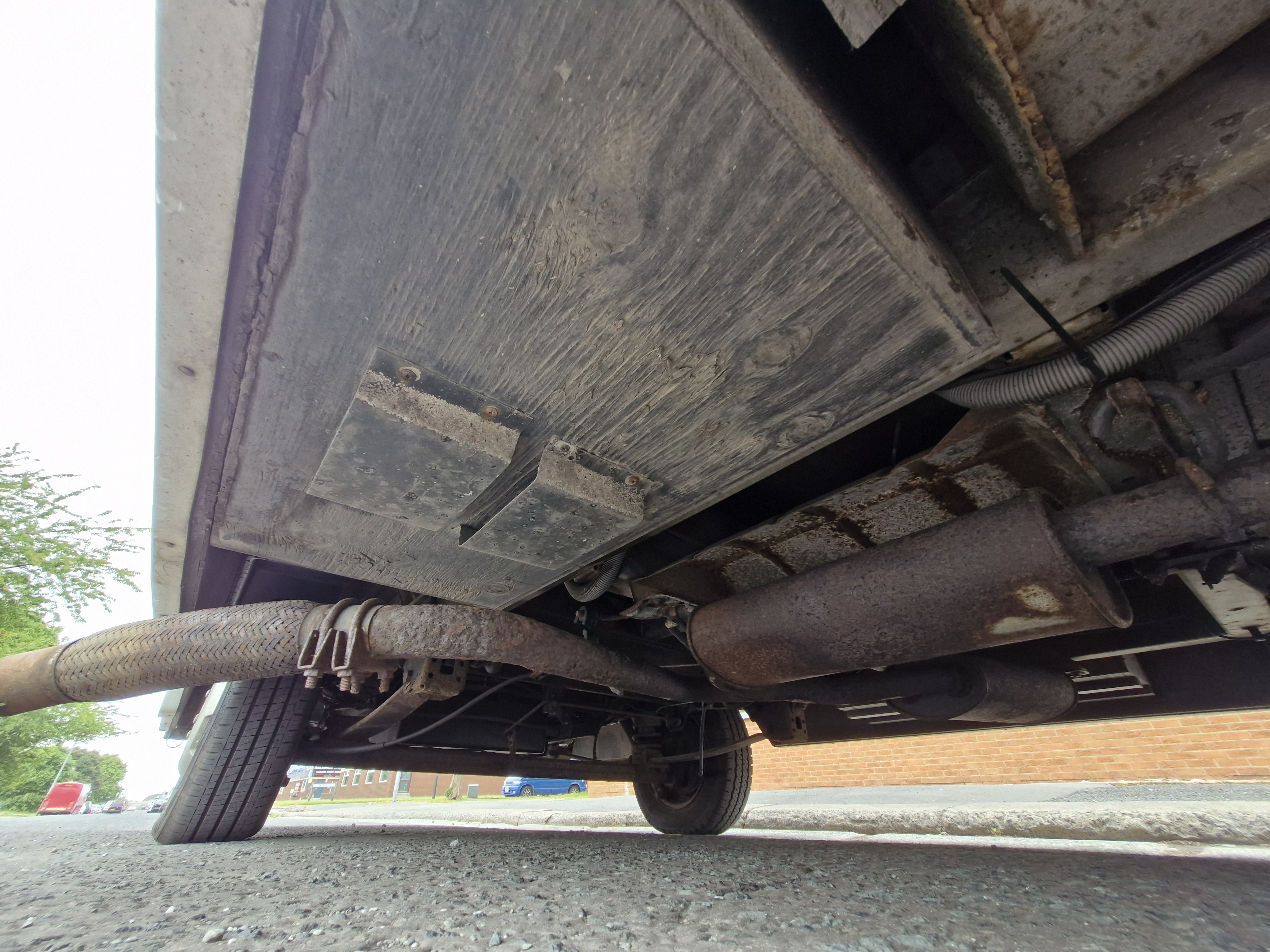

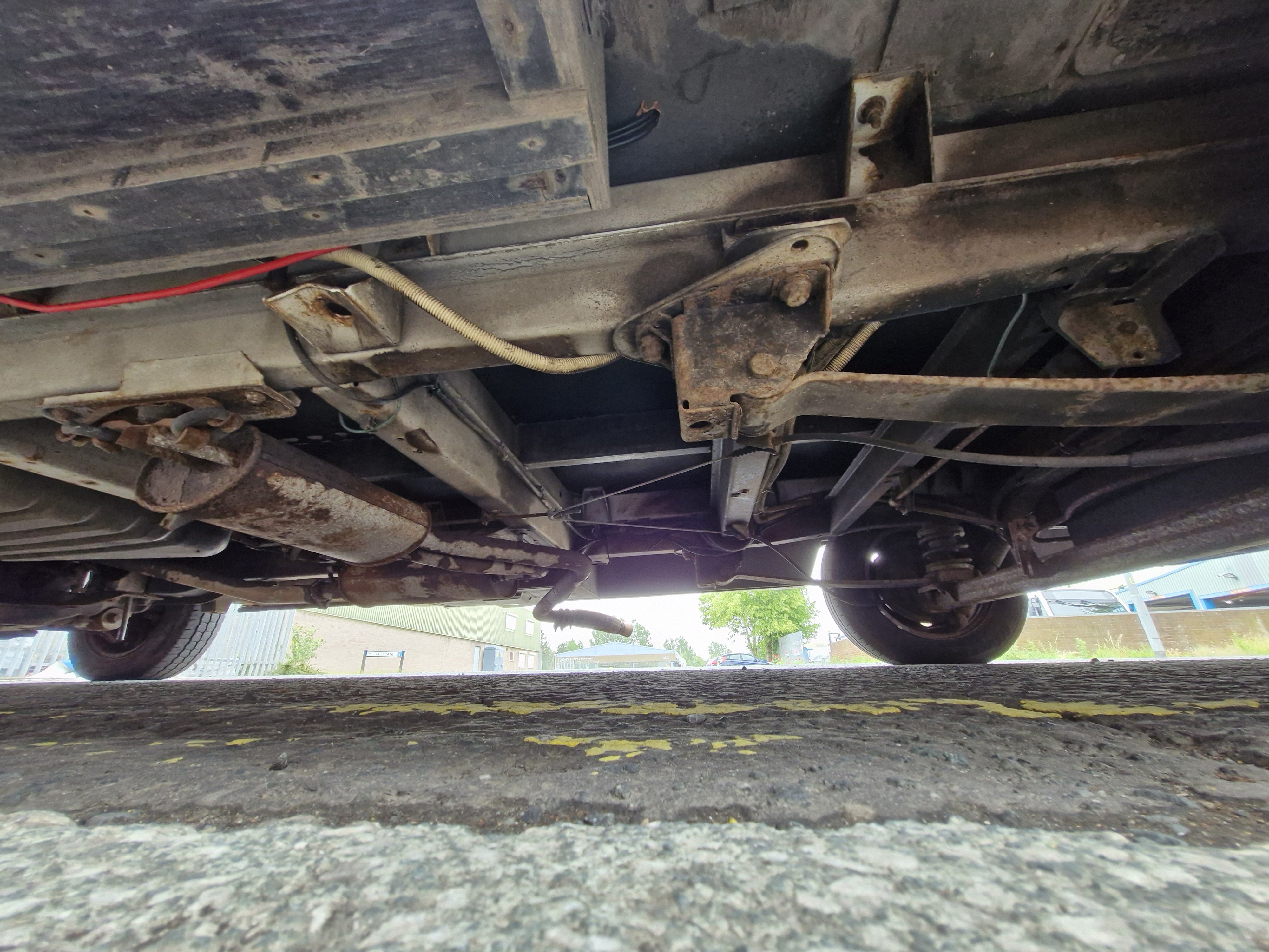

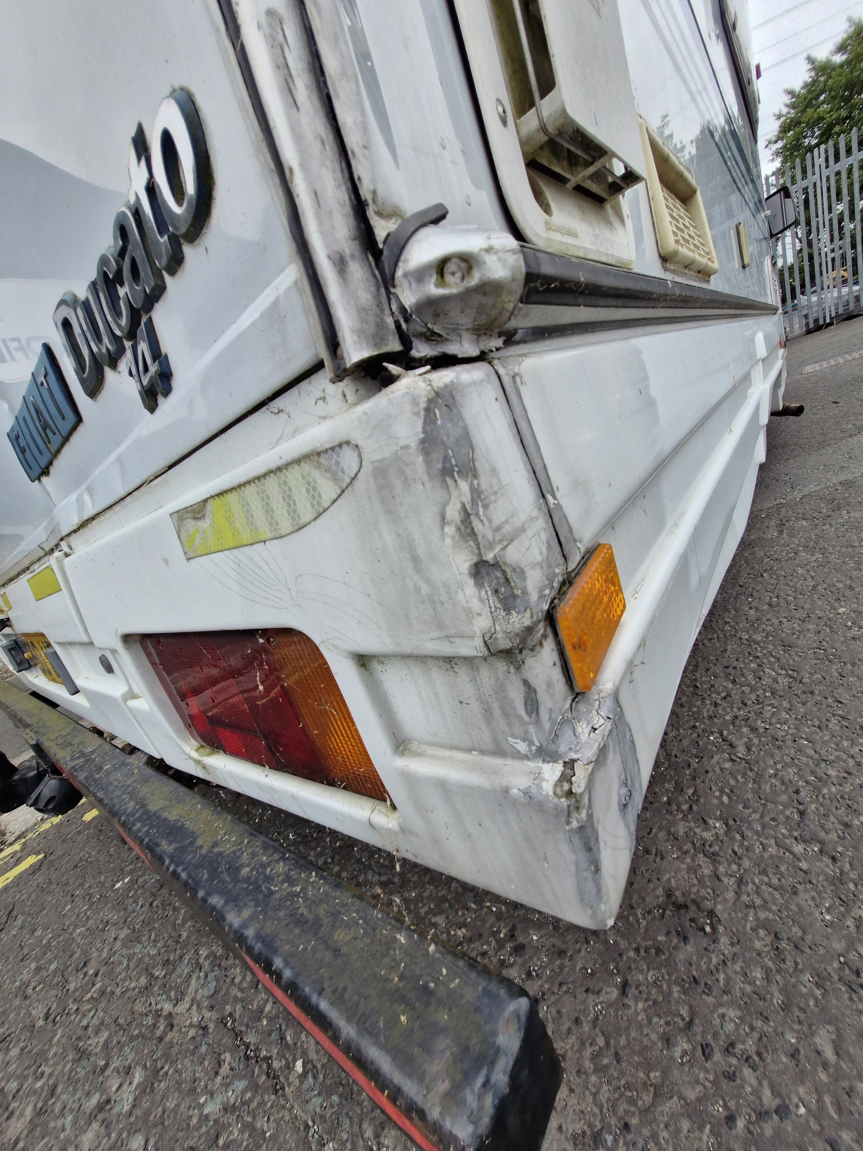

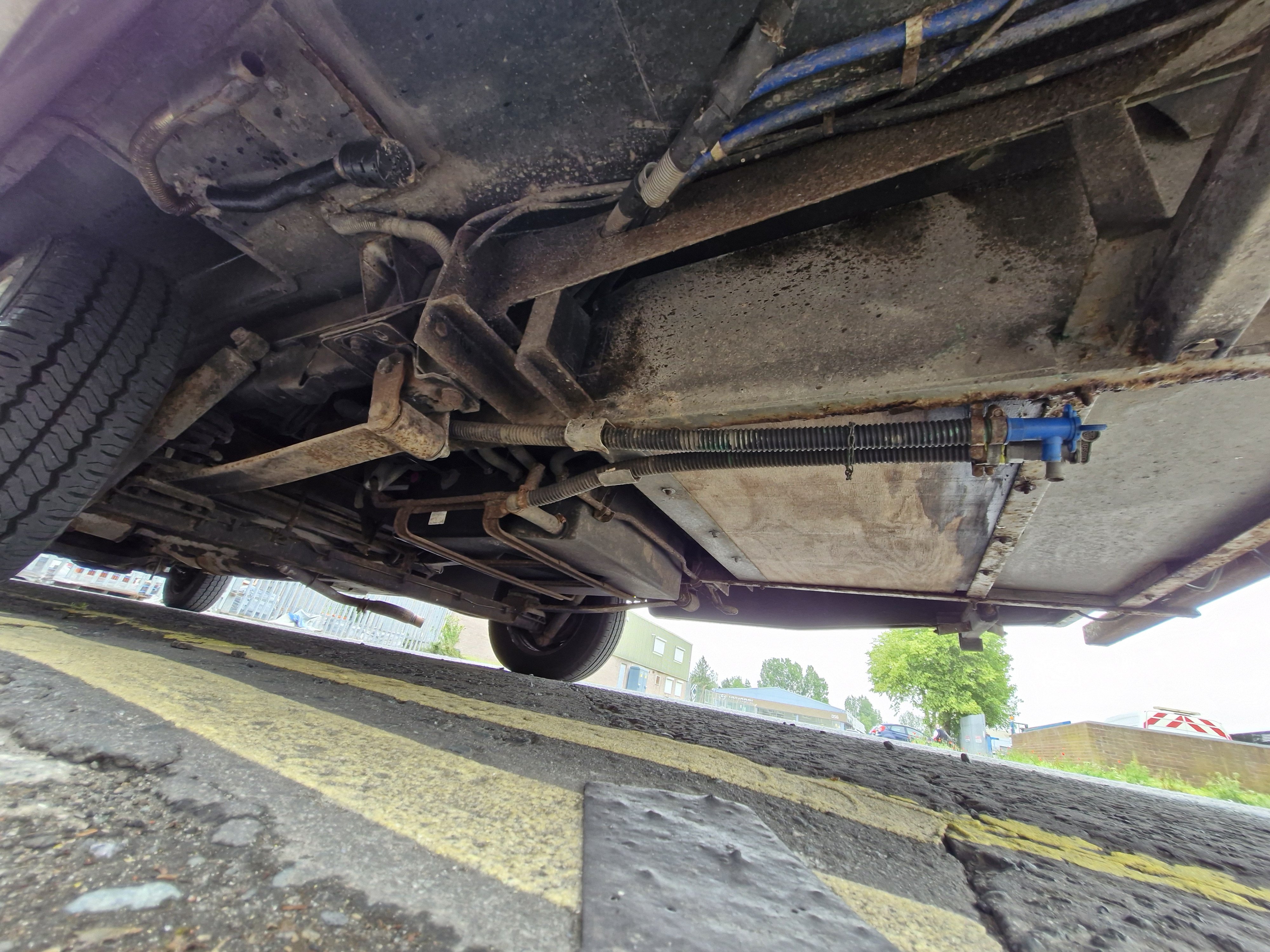

Hi Anki and welcome, I own a 1996 Ducato and all I can say is Beware. Firstly, rust is the enemy. You need to see underneath and check all the parts made by Fiat. I had to replace most of the front end. Most garages won't attempt a welding job of that magnitude. I was fortunate that mine would but I let them keep the van and do the work in their own time. It took six weeks but only cost £850. Secondly, check the gearbox for signs of crunchy gears, 2nd in particular. Replacement gearbox parts are difficult, if not impossible, to obtain. Finally, if you are not mechanically savvy or handy with the tools, I would give it a wide berth or take someone with you who is to view the van. Mine has no damp but damp can be treated or lived with provided it is not too serious. You would have noticed it if it was so bad. Best of Luck, Ian. p.s. Don't be put off by my comments, just proceed with caution. You may be lucky and have found a good one.

If I may add to the above contribution, one of the weak points for rust is the front cross member under the radiator. These can be replaced but more work/expense.
Hi Communicato, I heartily agree. I had to do mine shortly after purchase. Nowt job. No need to jack up the van. 6 large bolts (3 each side) into captive nuts. Great care and lots of penetrating oil. Stick a supporting jack under the cross member and gently ease the bolts loose. The cross member supports the radiator etc so support these items when lowering the cross member. I got mine from Coastal Motorhomes £65 inc. delivery. However, that was nearly 18 years ago but still going strong. Ian.

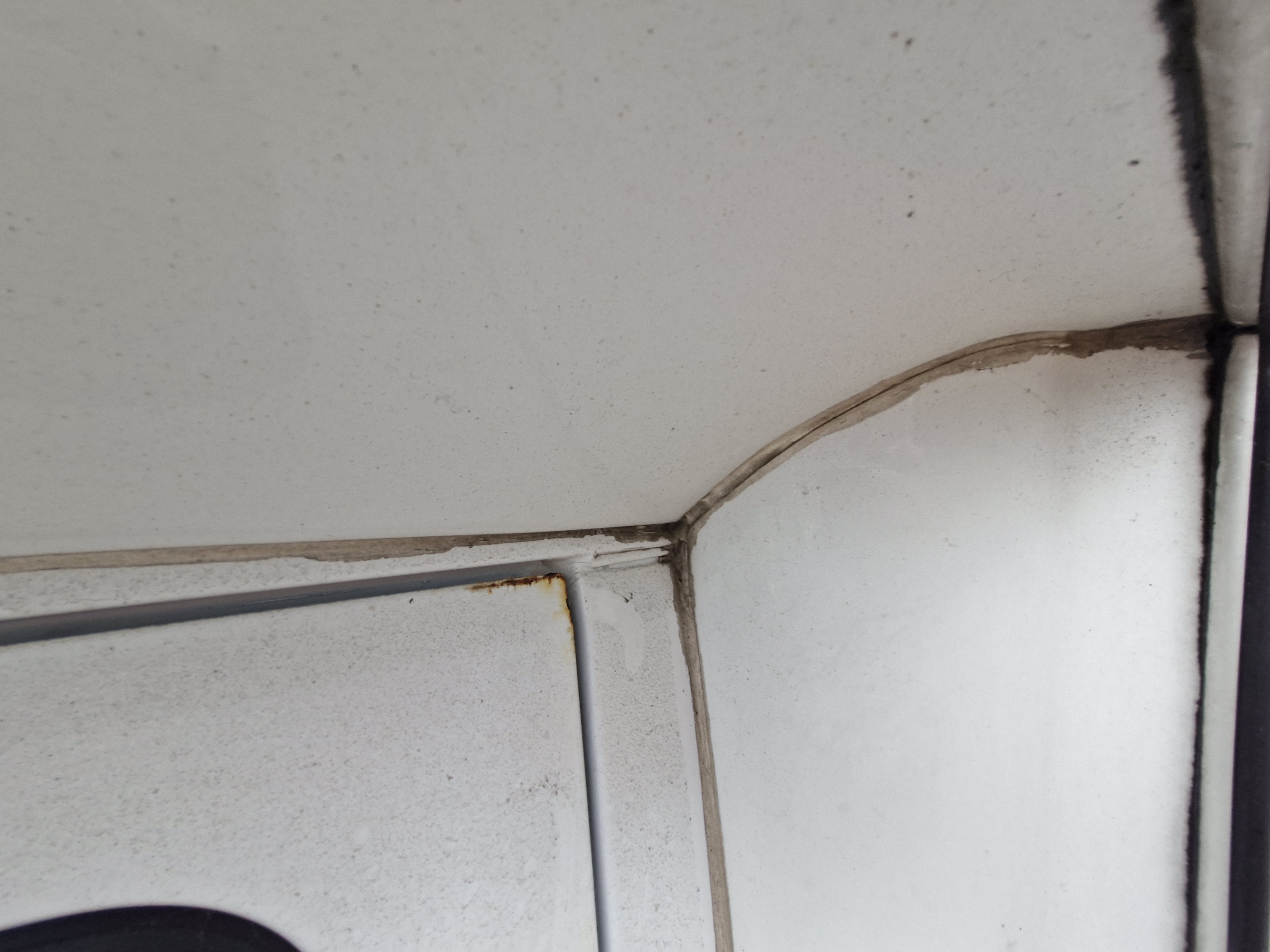

Took some pics of the underneath and bumps/rust on the bodywork too.
