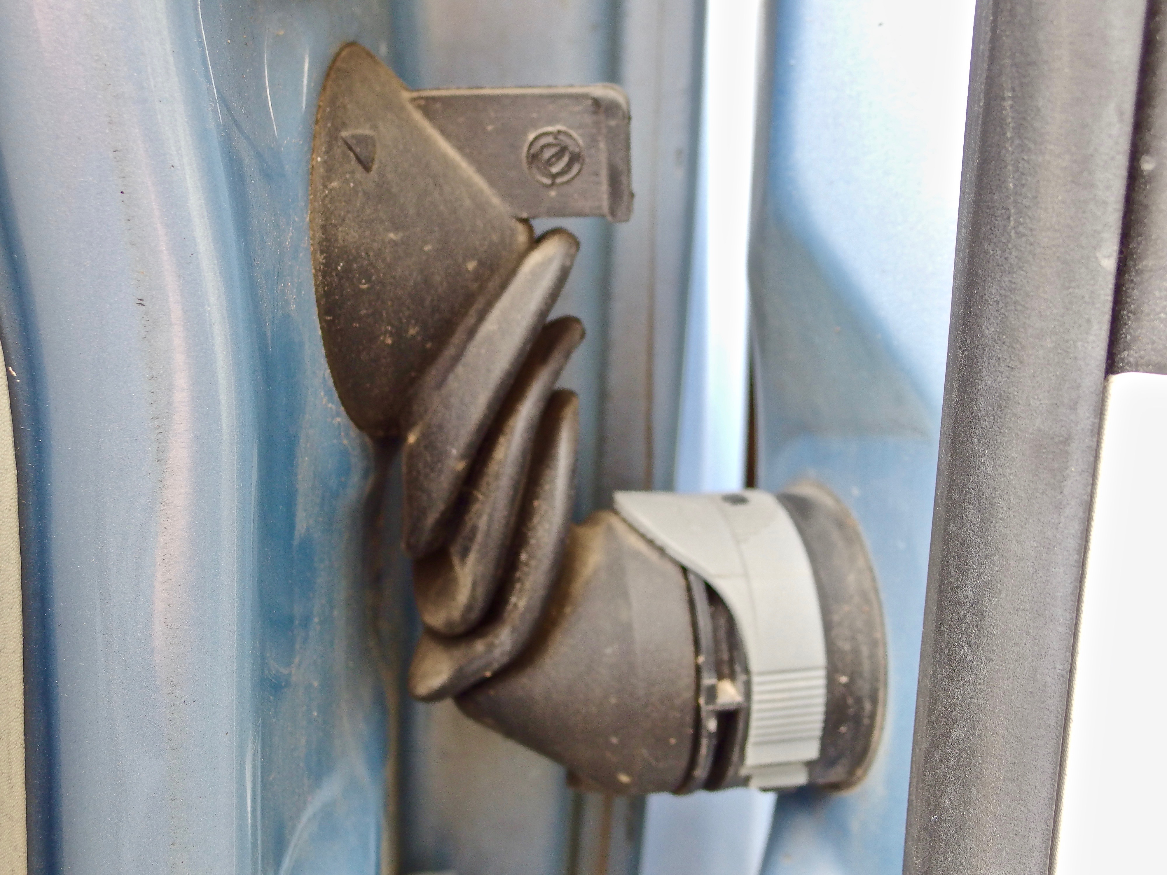

No I did not dis -connect the battery ... I just worked out how the plug thing on the door pilar unplugged .... (you have to pull up the grey plastic inverted u shaped part)... and it unplugs ... very easy when you know how ....I am always scared of breaking things like this ....But this time the gods were with me ....
