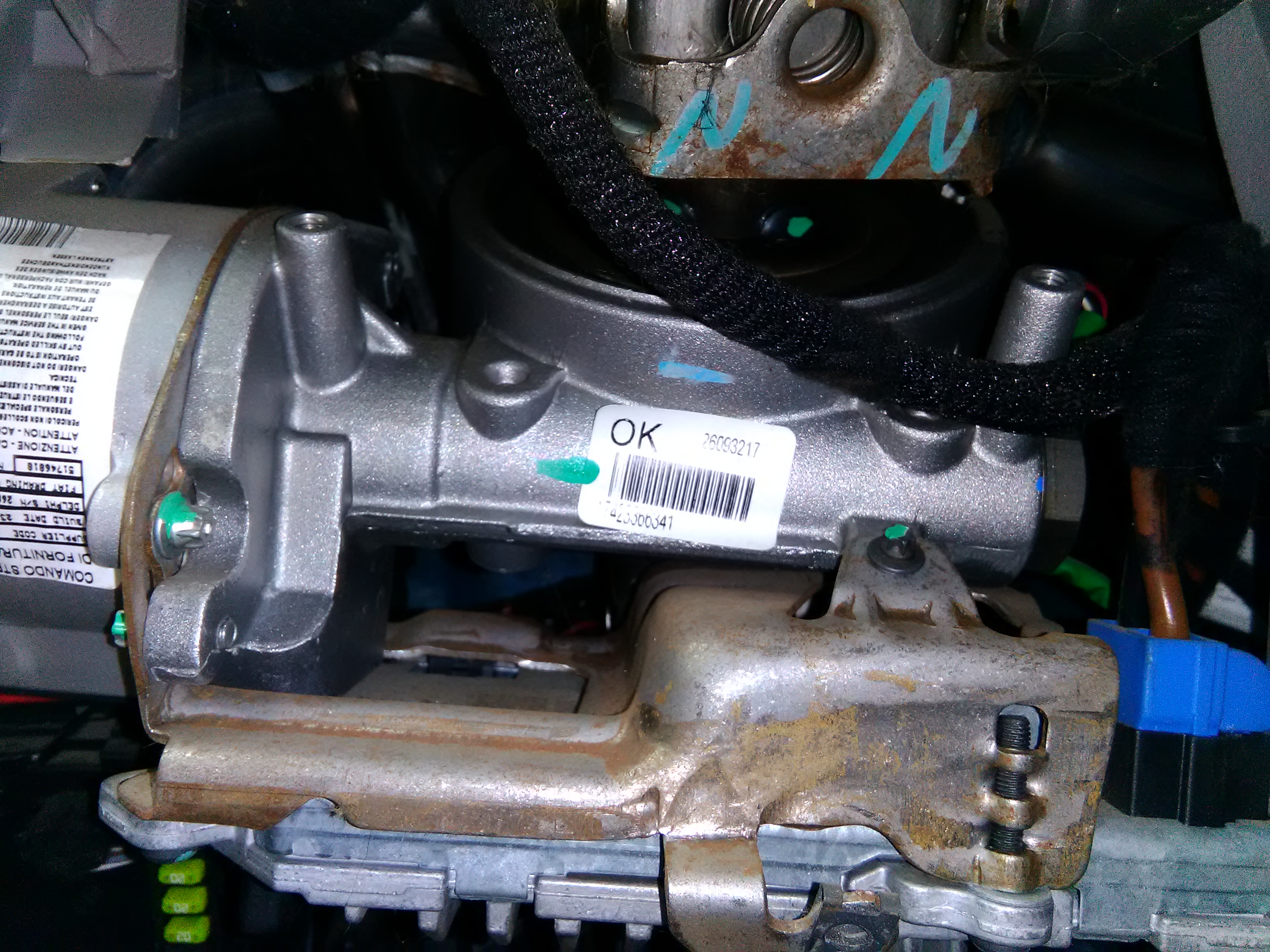

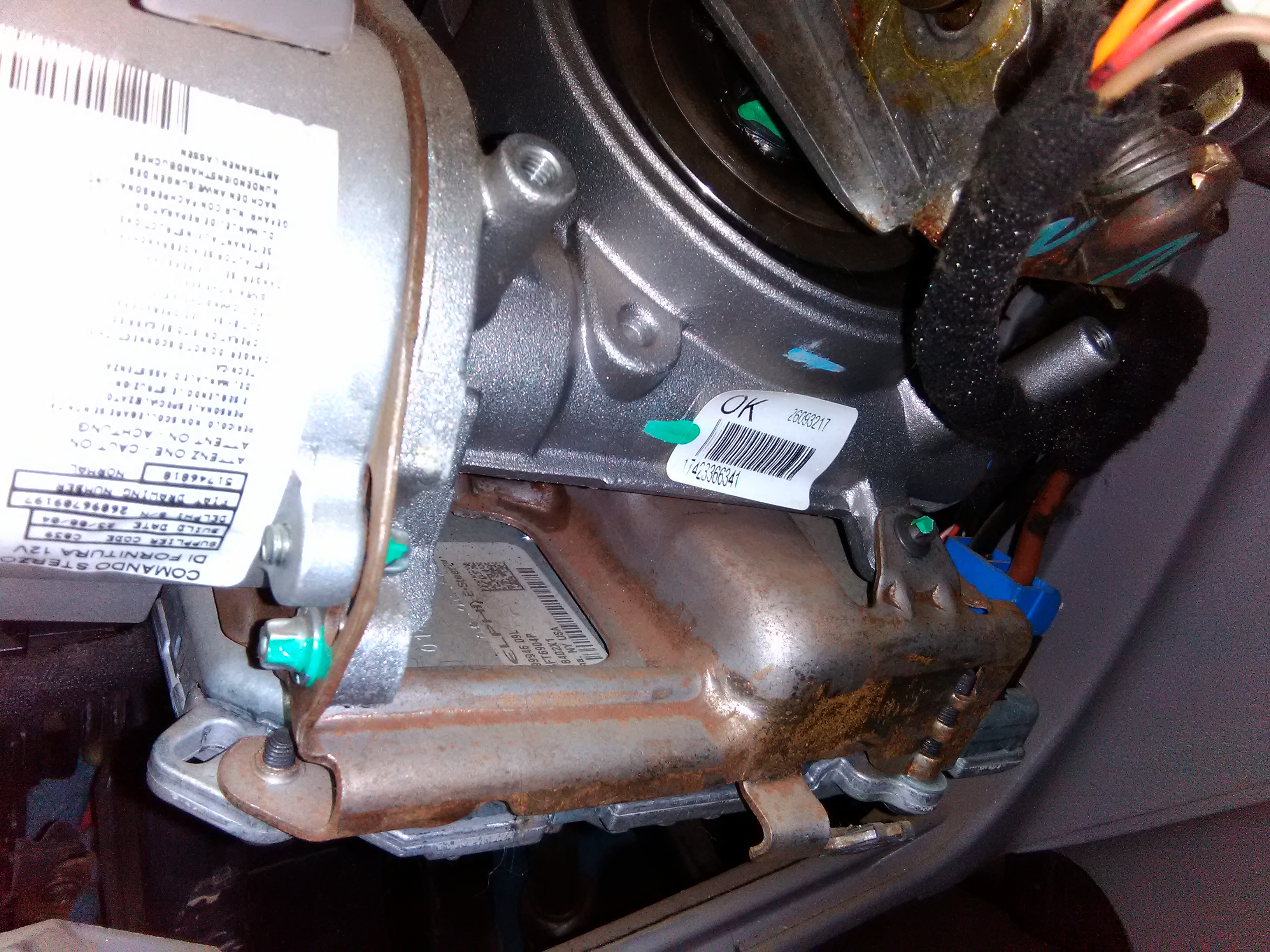

hummm... this afternoon I pulled the power connection to the ePAS apart and cleaned it. I don't think I'm the first person to remove that heat shield.

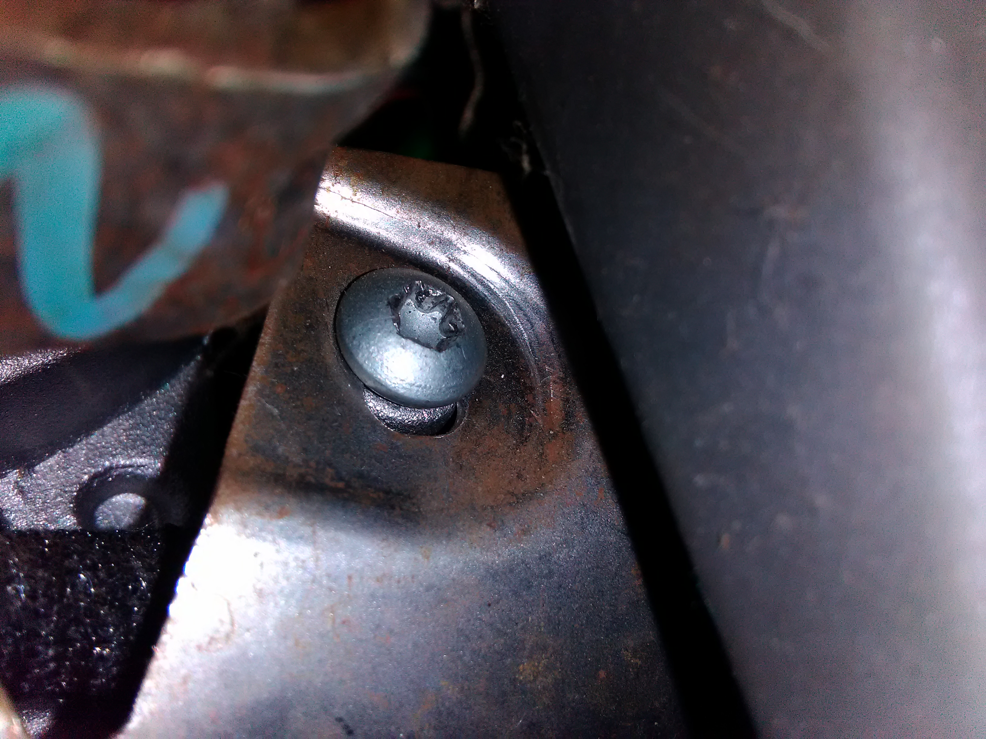

Is this a refurbished unit? In my experience factory original parts don't normally have tamper paint on all the screws...
Put it all back together and manouvered the car around a bit, not a peep out of the ePAS, everything was smooth and quiet, tried city mode, worked fine too (never tried before).
