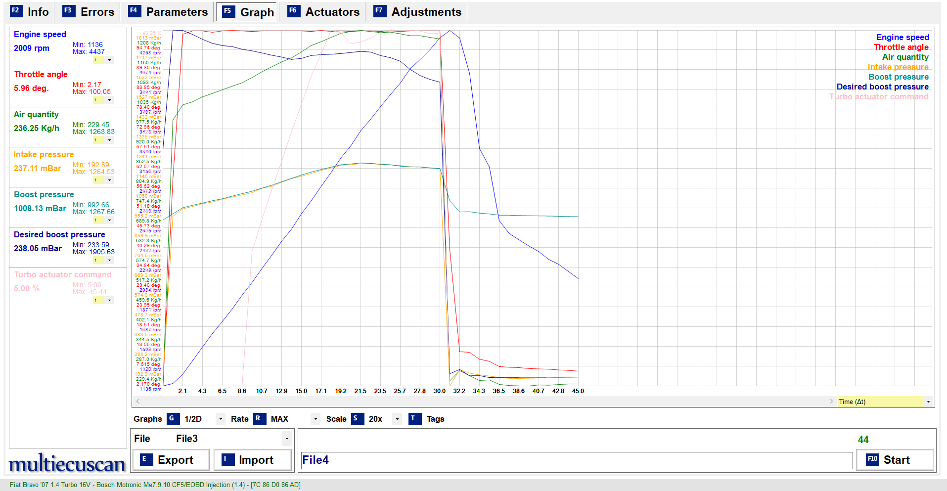

aurick86 I came home from work and decided to run another test with MES to see the results and correct me if I'm wrong but it does appear as though there is no more overboost and as such the throttle isn't being closed off by the ecu anymore?
Am I right in thinking that my car is running as it should again? I've been driving with the overboost issue for three weeks now so I've gotten used to it but it feels like things are back to normal after all :shrug:
That looks good.
Throttle staying opened as long as the accelerator is pressed, boost is controlled, not going over 2000mbar (2bar=1 atmospheric +1bar boost).
Fiy:
-you were hiting "boost cut".
-"overboost" is something else. In this case it's programed into the ECU, it gives you a bit more torque for a few seconds.
-you can see the overboost hump on the graph.
If you still get the whooosh sound, it might be a boost leak....no way around this....you need a
To make a boost leak tester(youtube mcm or jafromobile have some nice videos about this), a smoke machine might not be enough.

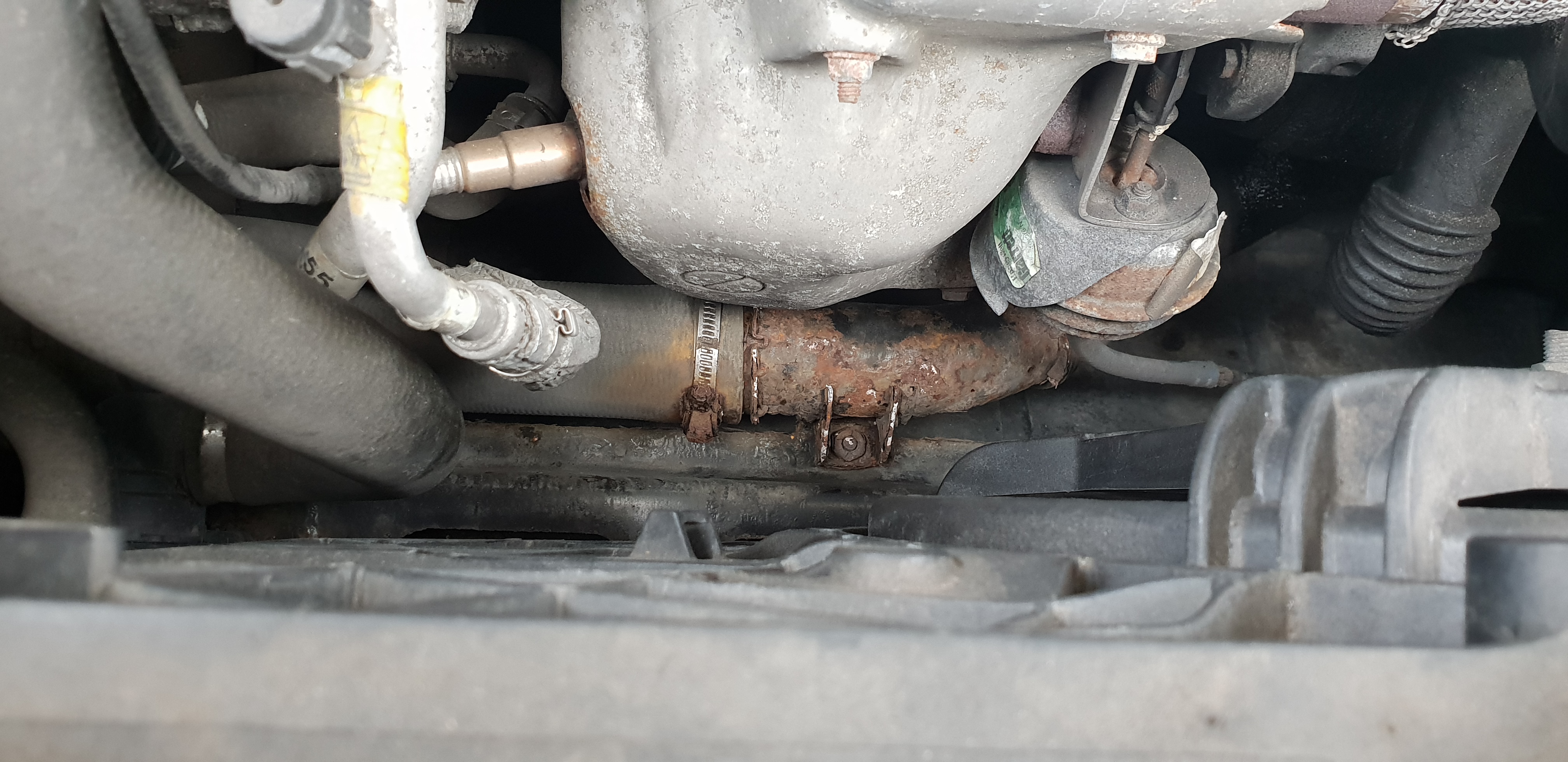

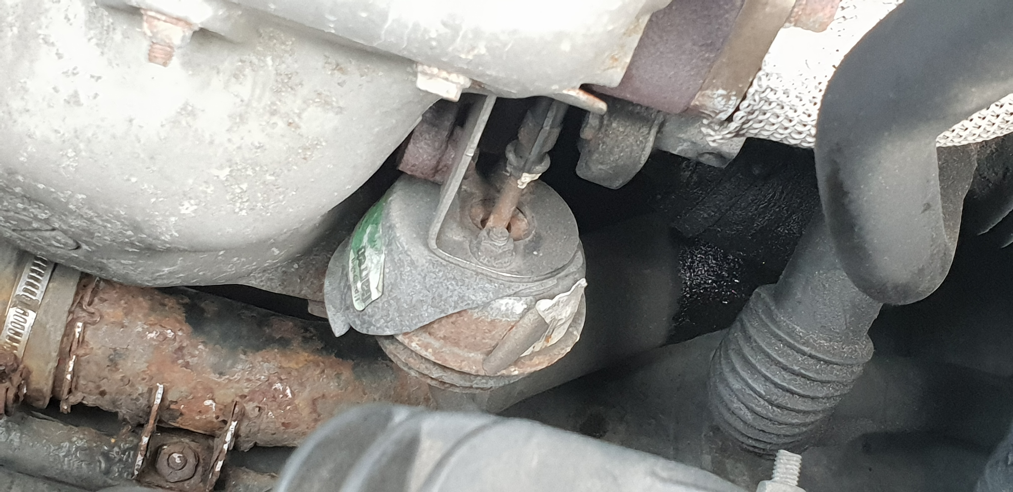

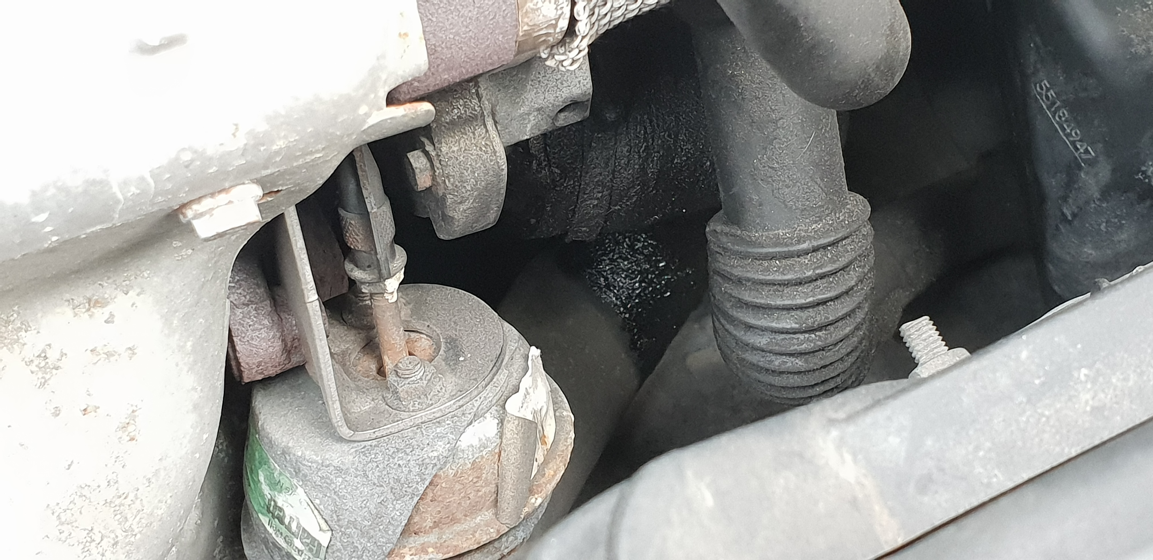

hi guys, im new to the forum.
ive had my EGR cleaned but the guy recommended i replace the EGR so i have ordered a new one.
the car lags every time i shift gears, turbo kicks in after 1500 or so.
i have notice a leak near the turbo pipe and looks fresh, also notice another pipe corroding.
any suggestion to what the pipes are called or how to tackle the problem???

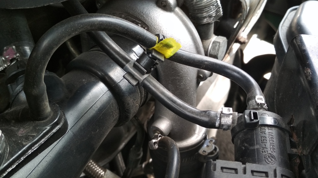

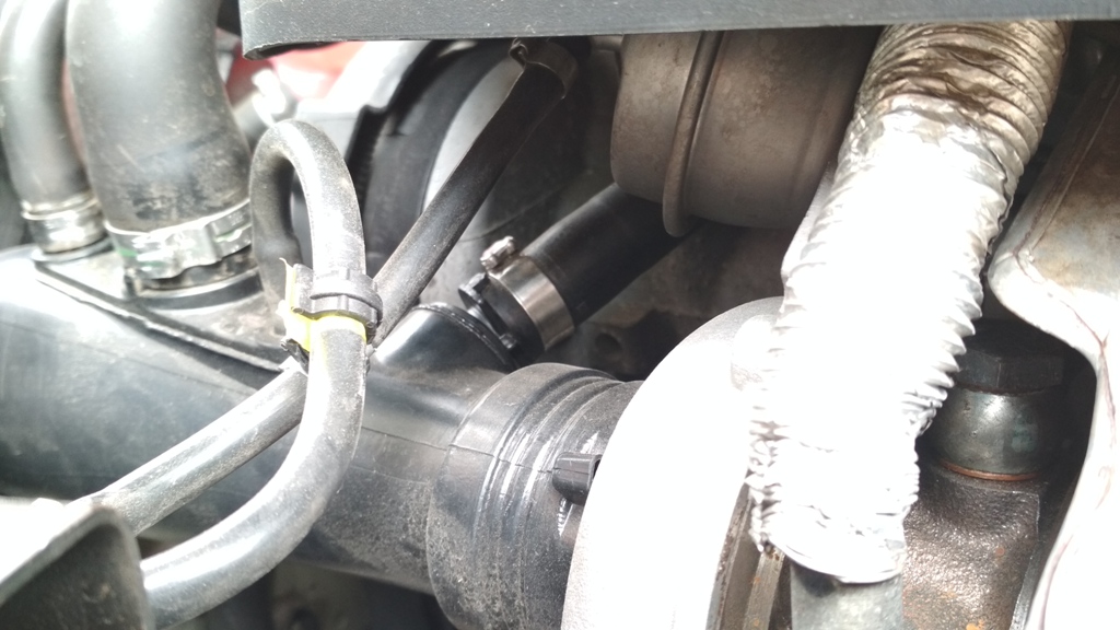

Think the problem you have is the install. More specifically the wastegate solenoid. Post a few pictures of it, so i can figure out where the hoses are connected.
Thanks for fast response!
Here are some pics from solenoid.
That is connected right. I have clamp on intake pipe/turbo connection on my GP T-jet, i cant see it at yours. Put a clamp on hose if you dont have it on... Also I red in one thread that broken oil separator may create boost problems, try to find it if you said that some noise is coming from your oil separator...

The solenoid is connected correctly.
(the solenoid can still be broken internally, mechanically ...so no error)
Is the wastegate closed? can you move it by hand? make sure it's not hanging up on something.
