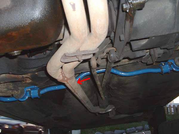

I'm converting Uno 60S from carburator to SPI and I have to fit lamda sensor somewhere. Would it work normaly if I put it there:

You want to put Lamda sensor underneath my car? :confused:
:p
Seriously, go and find an SPi Uno 60 in a scrapyard and get the manifold/ downpipe. You will then have the mounting for lamda sensor.
I didnt't find any other picture of exhaust pipe, so I borroved yours ;)
I have a problem. I went to a scrapyard and bought pipe from Uno 1.1IE but there is no way to fit this pipe to my car, because of gearchange rods:bang:. IE wersion doesn't have them, so pipe is different.
Will my car work if I place lamda sensor like I draw in picture?
I'm already driving my car, but don't ask me what fuel consumption is :D
I would source the correct nut that the lamba screws into (or chop the one from the ie pipe) drill a hole in your downpipe (making sure it wont foul or get in the way of anything) and weld the nut on and screw it in, they are usualy positioned just after the downpipe bend Ant!
